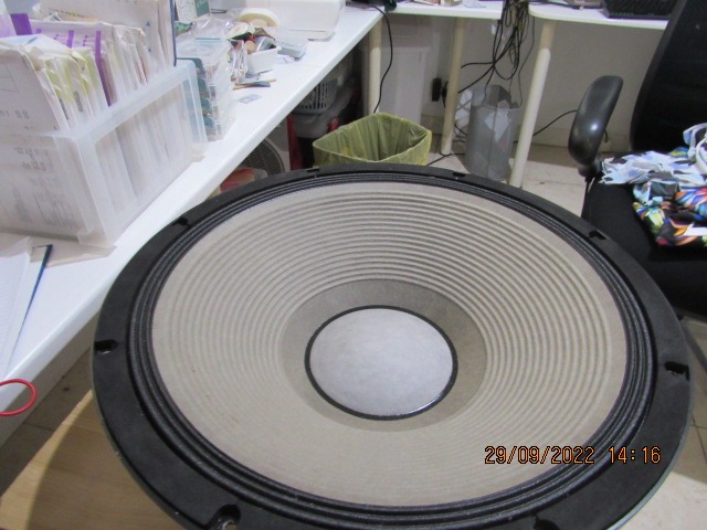

I just picked up a cheap driver to use for another party box. My computer is still giving trouble with Excel so I'm asking for a little help in the best use of this generic 18"
Re 5.9
Fs 33Hz
Qes 0.522
Qms 5.437
Qts .476
Le 0.7
Vas 250 litres
Looks like 4" voice coil and about 6mm X-Max and I'd guess 10mm X-damage
Driver needs a vacuum and wipe off but it was only $100-
My first thoughts were to mass load it a bit and just shove it in a smallish sealed box and I'll probably need a bigger amp to drive it and near enough is good enough, and I may have to get another Behringer CX unit for it, unless I can find a S/H Hypex amp of course

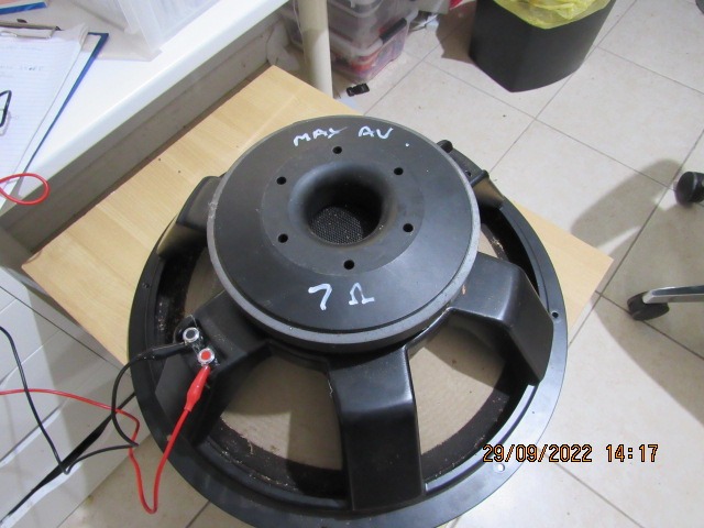

"Max AV" - any chance it would've come out of something like this?
https://alternativeimports.com.au/item/?AISC-0118A
edit, nevermind... I found they're selling that driver seperately:
https://alternativeimports.com.au/item/?302
Yeah. I found that website just after I posted but I thought that a ported box that small may not have been the best use.
I didn't pay anywhere near that much for it
Parameters via DATS Woofer Tester

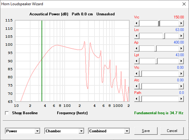

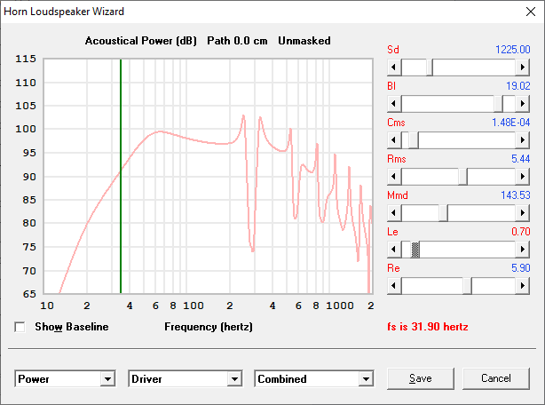

150 L tuned to 35 Hz. I assumed le of 2.5 mH as you didn't provide it. DSP can be used to pull down the hump in the response (which is also exactly where excursion requirements are the highest) and implement a HP filter @30 Hz to prevent over-excursion below Fb. Should be able to get 118dB linearly from 40 Hz up.
At Le =0.7 mH, the response doesn't change that much at bass frequencies....
