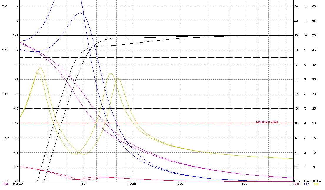

0.56 ft3 = 15.85 litres.
You couldn’t get a smaller one?
3” vent (76mm) 390mm long F6 40, F10 low mid 40s. Response is kinda droopy thou. It may seem mid/upper bass light.
If you can put a “brick” into the box and reduce the volume that would be a good thing. 9-12 litres target. The optimum for miniOnken tuning (the maximum size) is 9 litres per driver.

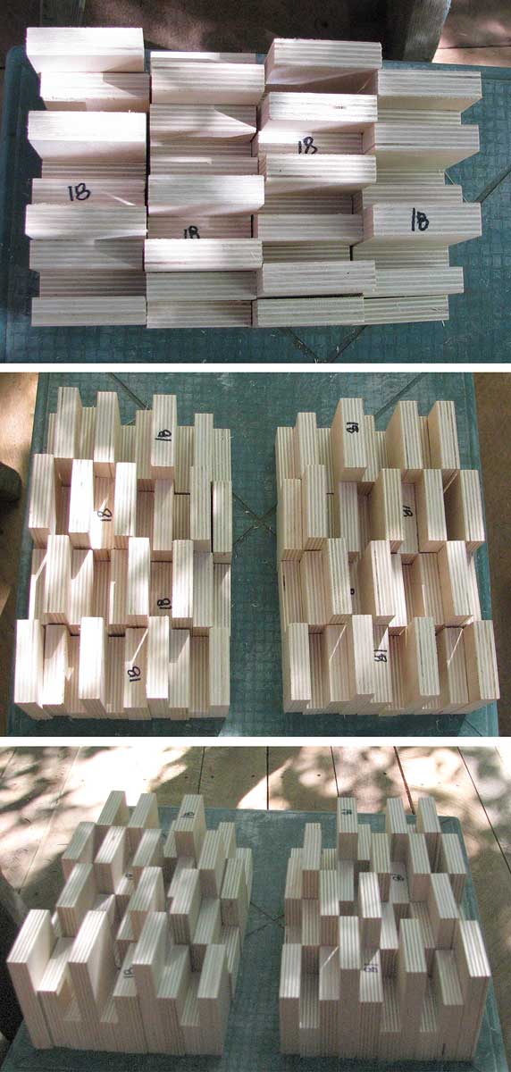

Remember the trick with staggered pieces of scrap wood inside the box in the attempt to create some chaotic reflections / break up standing waves. If the PE boxes have removable baffles, internal access to accomplish that or add extra bracing should be easy enough, I’d imagine.

Some diy that could be repurposed: Taking the Air Cavity/pre-chamber to the next level...

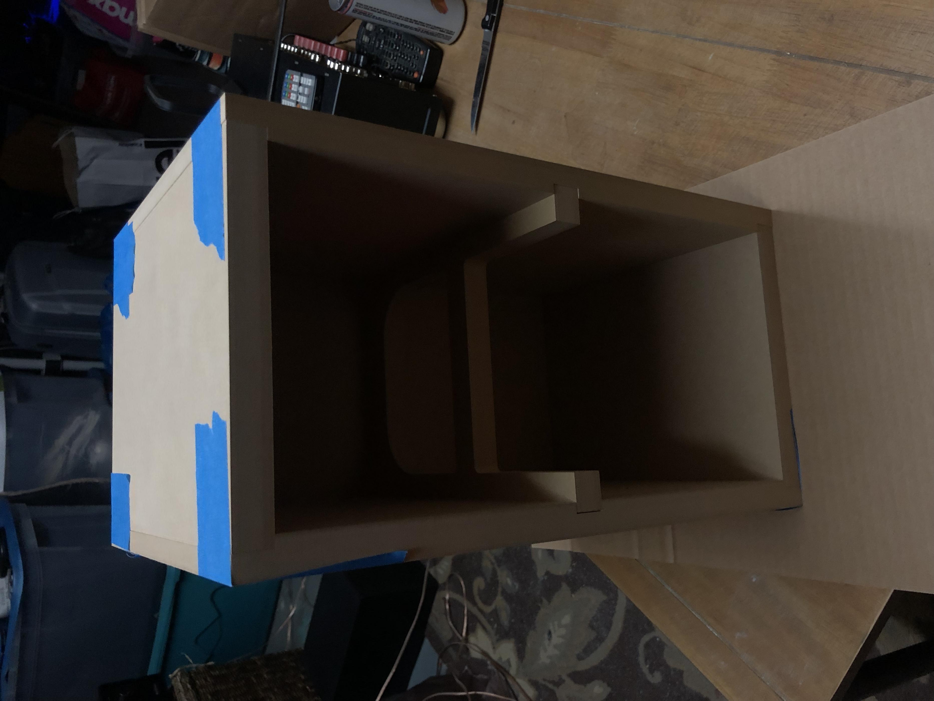

Lol, the next size down was .23 cu ft.
The brick or additional wood such as a piece of 2x4 to reduce the volume sounds ok to me.
They don't have removable baffles, but the rear panel can be made to be removable, especially since the boxes are a bit too large anyway.

That all looks pretty cool, but the brick sounds way easier 😀
If you installed that randomness of wooden angles, would you still add poly or any kind of batting/insulation?
it does not obviate the need for damping.

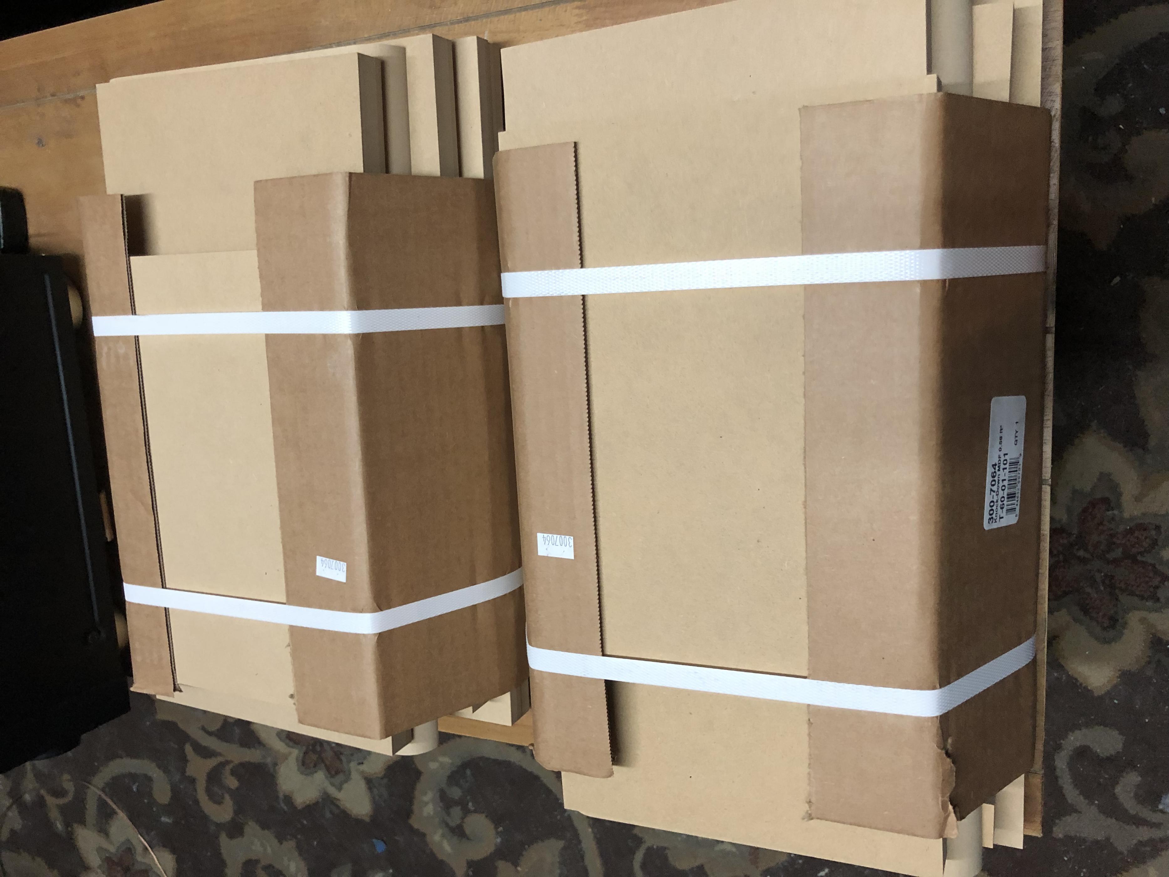

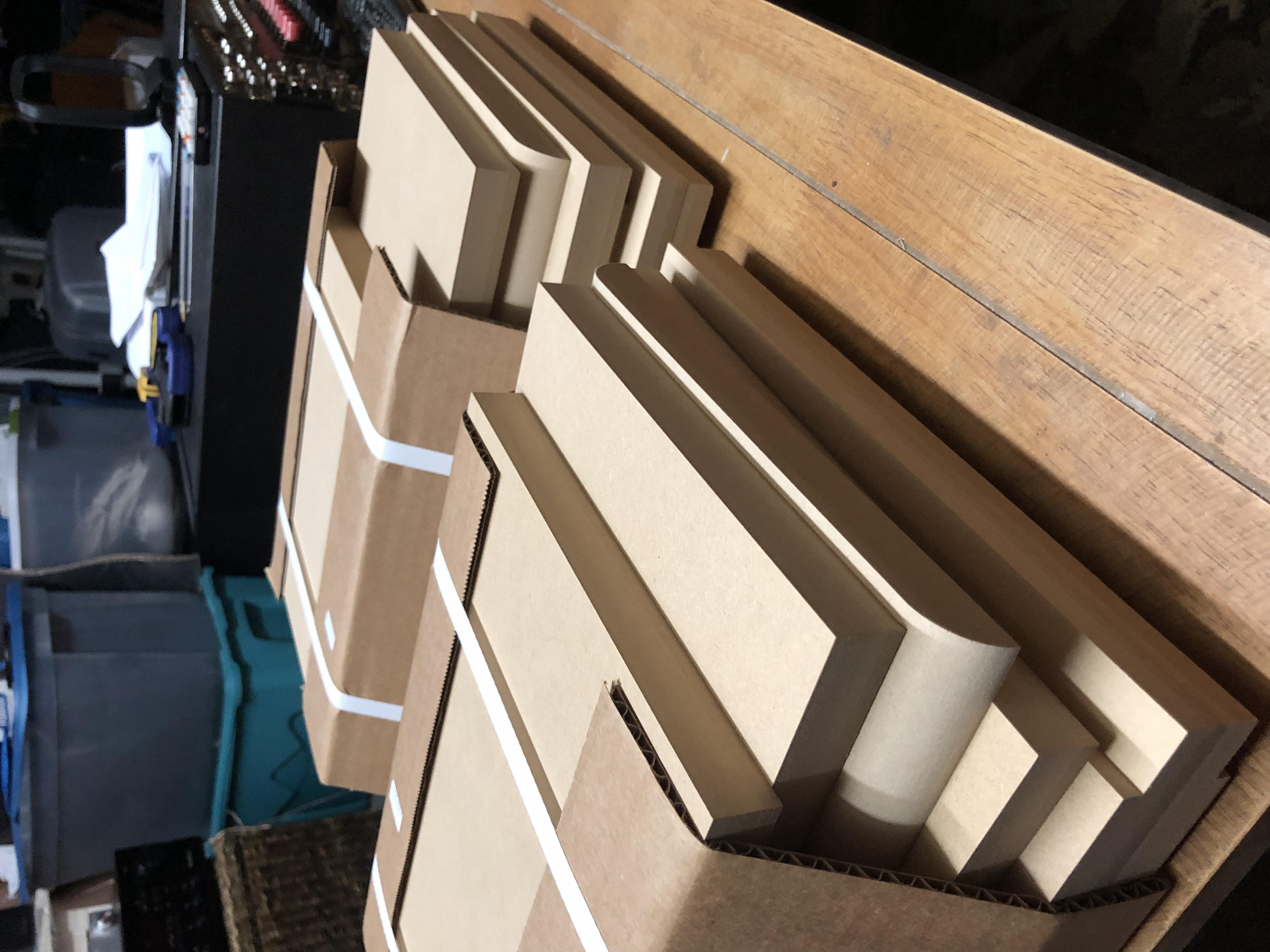

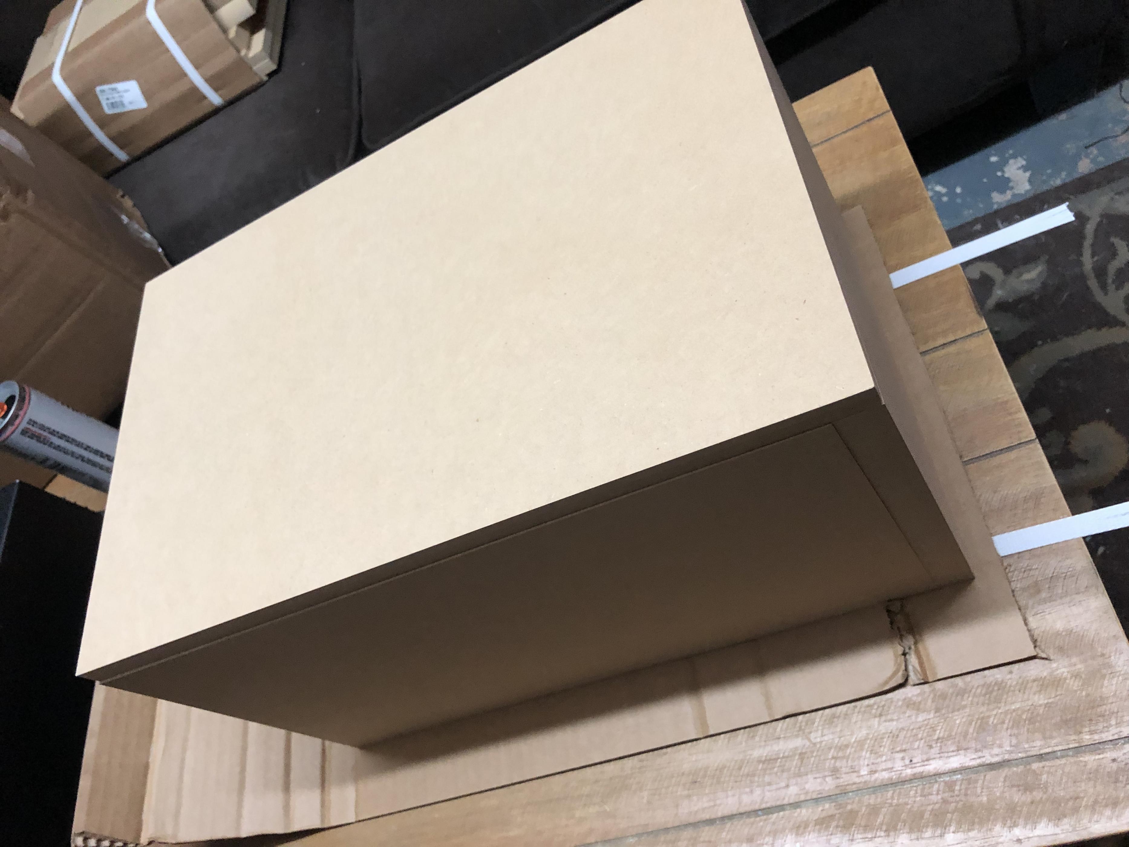

I received the flat pack cabinets from PE. The cuts are pretty accurate and the test fit came together easily.

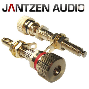

One comment on the last question, i always recommend binding posts on a plat eor cup such that they can be accessed from the outside of the box to make wring (or rewiring easier). I also loke those to be recessed so that they are hard to accidentally break off.
I avoid any with too much metal, look for plastic nuts, not metal ones.

With that name, likely a lot of money too. To make those accessible from the outside you have to add a removable plate somehow.
dave
dave
About £10 a pair. If I need to service them following the final glued closure, I'll go in via the driver hole (so to speak). People likely to break speaker terminals have long since flown the nest, but never say never!
