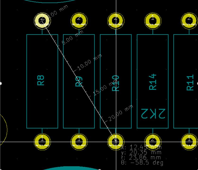

If the pcb is still 170mm x 112mm and scaling the resistor hole spacing for the 0.33 ohm resistors - then it looks like they are 18mm lead spacing. Normal for 3 watt resistors. Randy can confirm that.

What is hole spacing for the 0R33, will 5W 24mm resistors fit?
KiCad Footprint:
Resistor_THT:R_Axial_DIN0516_L15.5mm_D5.0mm_P20.32mm_Horizontal
20.32mm hole spacing.
If you wanted to run one higher power resistor instead of 3 in parallel you could go diagonal. You get about 24mm instead of 20. Not much, but something. Or stand up one end of the resistor at an angle off of the board.
