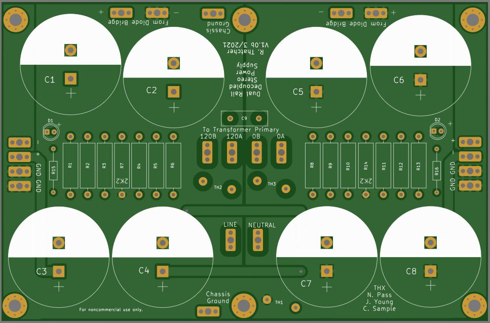

I have a question.
I see you did copper zones with thermal relief setteings.
But now every pads in copper zones are thermal relief.
Should input/output high current pads be so?
Or maybe beter make those pads solid with copper?

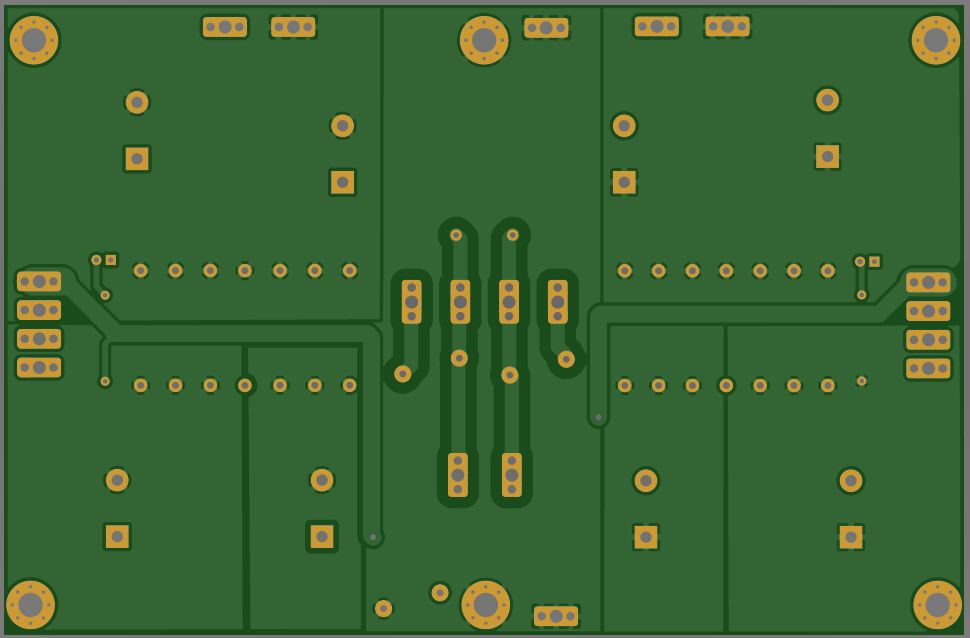

I did a bunch work yesterday. Thanks for the comments on the thread, and thanks to Twitchie for input and being a sounding board!
Changes include:
Updated grounding. The point between left and right sides of the board opposite the rectifier inputs is now the star point. V1.0a the U point was on the side with diode inputs. I also adjusted the fills for output ground to only connect towards the star side of the board. It's similar to the layout Jeff used. Ain't broke, dont' fix.
Order of outputs (not a big deal) changed, so did A/C layout (also not a huge deal).
I updated so all of the +/- outputs are direct from cap pins, not from the planes/fills.
I reworked A/C. Track size 2.5mm. Track clearance 2mm. Moved connection points. Note Rev A does not meet this clearance everywhere.
Added another point to attach antek / transformer shield wire to chassis ground.
Thermal relief connections upsized to 1mm. They should easily handle the current of these amps.
This is what's going to fab. For some reason the 2 vias look small on this gerber viewer. They look good in Kicad. I'm putting a note the fab...

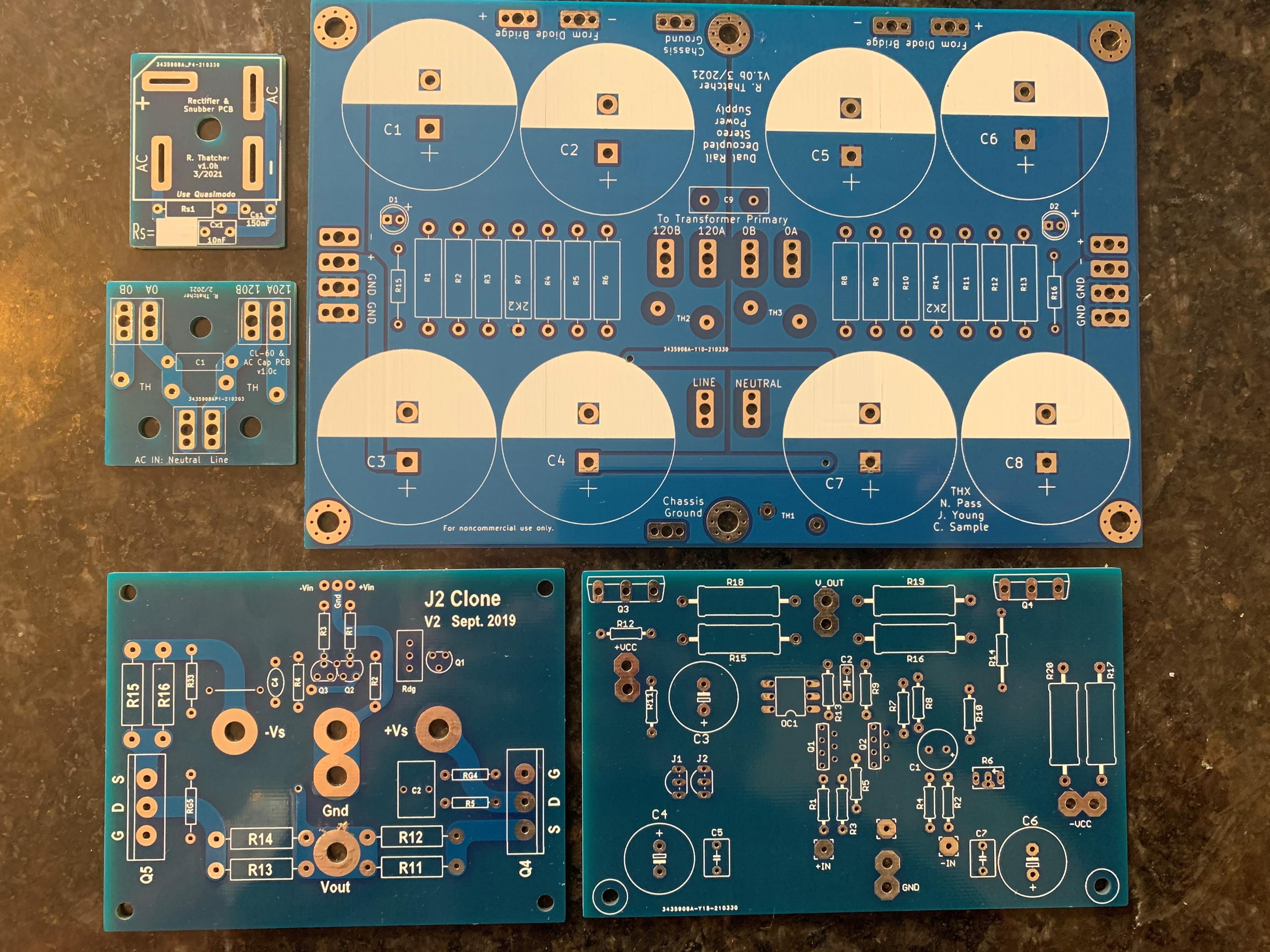

Dear all,
PCB's arrived. After making the update I've decided I'm not sending out rev A. I have 15 boards. I can send 2 of the rev b board to all of you to play with. Or let me know if one will work and I'll hold the rest for anyone else who wants to jump in. PM me with your shipping info and paypal info. I'll ask enough to cover shipping, please. Should be ~$4 in US. Those on the other side of the planet will be more...
