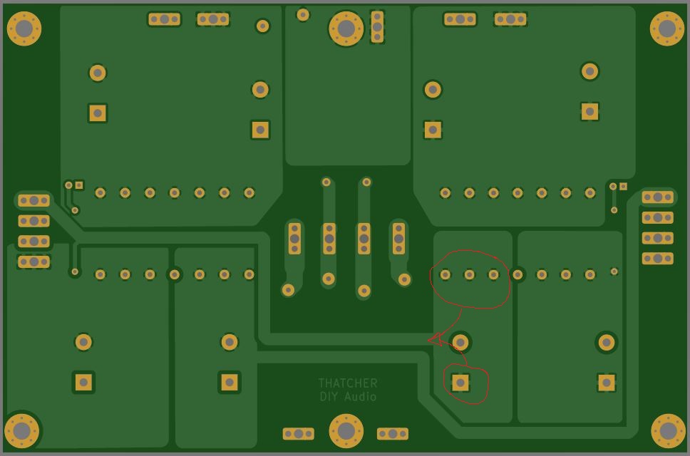

A couple of things to consider:
Jeff puts much more into his projects than you might initially think or he's extremely lucky and gets many things right by accident.
If you look at how he takes power for the + and - rails, he is very deliberate in runnning a single narrow track (not a pour) from the pin of the last capacitor in the CCRC. Taking it directly from the pin gives you the full benefit of a CRC but in your case, you are taking the rail (not sure if it's V+ or V-) from a copper pour which happens to connect the PI resistors and the right side V+. Imagine the scenario where you attach the output at the pin of the resistors instead of the cap along a wire which connects the 2. Electrically you might consider anywhere along the wire to be equivalent but if you attach at the resistor are you closer to just CR rather than CRC? Do not mistake me for someone who actually knows the answer because I don't have the proper training to calculate this. Others may chime in but let's just say I was on this road quite recently and just want to point out a couple of pot holes that I hit in the road

I am a satisfied user of the Jeff Young(thanks🙂) version, but I had to change the configuration. For the M2x project I needed more capacity to lower the 100Hz ripple level. The original M2 input circuit works quietly (as probably all Firstwatt amps) but some daughter cards need more ripple damping.
I measured the ripple noise and it came out about 170mV. The same was shown by spice in the simulation. Jeff checked another configuration and now I have 4x 33000uF / 4x47000uF and 0.5R resistors. The noise should be around 60 mV according to the simulation.
Somewhere on forum I read that Uniwersal PSU from the diyaudiostore works around 120mV ripple . Maybe it is worth adding some space for larger capacitors, because in this size and with only two pins there is low availability of capacitors.

Can I ask - what are the physical dimensions of this pcb? Thanks.

The biggest I’ve seen in 35dia is 47000uf/35V CDE
170x112
Okei. So just about the same as the store boards - rectifier boards.
