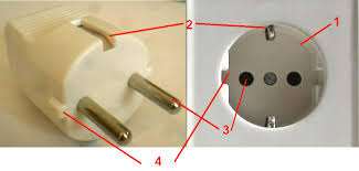

Actually, there are many sockets in Australia which are incorrectly fitted. You can buy a neon test gadget that tests for this here; in many European sockets (Eric tells me!) that can be connected correct or reversed with the same two pin plugs!
Hugh
Hugh
Hi Hugh,
You are right. In almost all countries in Europe, except Great Brittain I think, we can turn the mains plug. Earth connection is on both sides of the plug (see picture). It doesn't make any difference. Your computer will work, the coffee machine will make coffee and the lights will burn. The only thing where it makes difference is audio. The right polarity sounds better. When you tell this to an electrician he will look at you in a strange way and think you are nuts. The only way to know if your polarity is oke is to meassure it. It has to be a routine. In the future it is the first thing I will do if I buy a new audio device.
