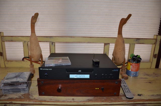

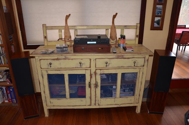

Righto...the internet worked for me this morning. It must be due to the cold and wind. The new revised and ultra minimalist system which demonstrates that you indeed do high end retail hi fi for less than three grand

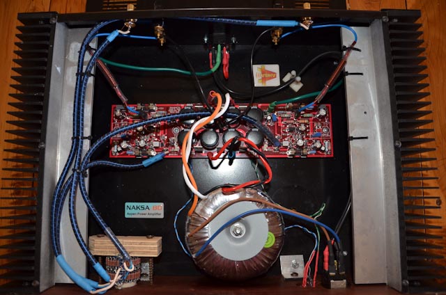

Very nice, Sean. You are using the base of the case as the heatsink?

Yes. The steel base and the heatsinks attached to it are the entire heatsink. Seems to work quite well.
The speed of the project was down to the fact that the case existed and was easily modified plus (of course) the module itself which is (as we know) not much work at all to connect up. Apart from the signal wires...I did wonder why you specced the three pin signal connectors rather than screw down gangs(?). And that attenuator caused me a little with its really small ground loop.

Having lived with your Naksa 80 for a few months I'm perhaps even more delighted with it now than when I first purchased it. It's fast,rich,involving and very transparent.

Here, here. I'd also add 'clean when loud' to the superlatives. The El Camino album from The Black Keys with its Muscle Shoals studio 'sound' (think alive and distorted) is a joy to listen to - and to watch a three year old boogie to as well.

Very nice work - one suggestion, put some tape around the mains input, insulate it from moving fingers!

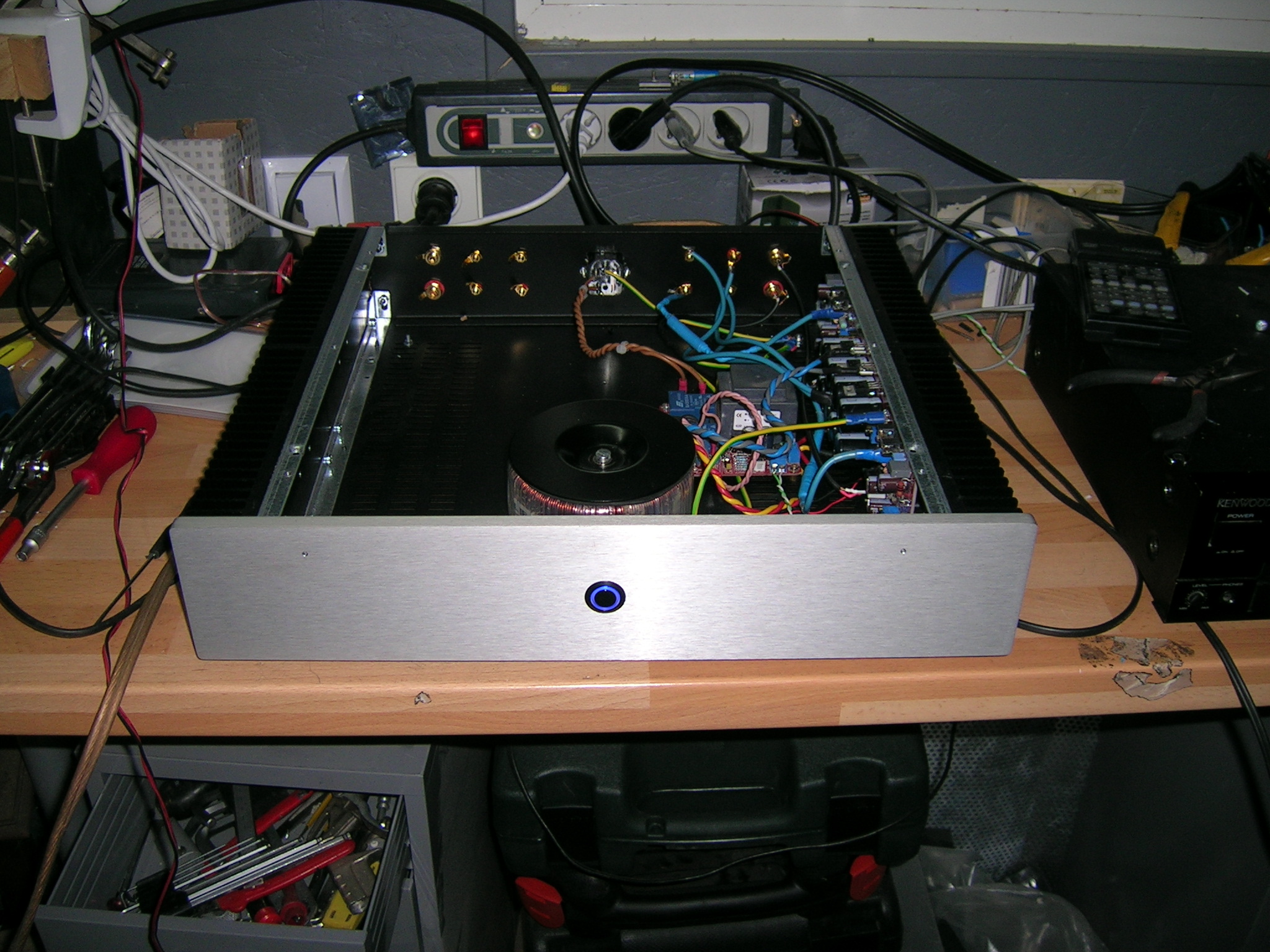

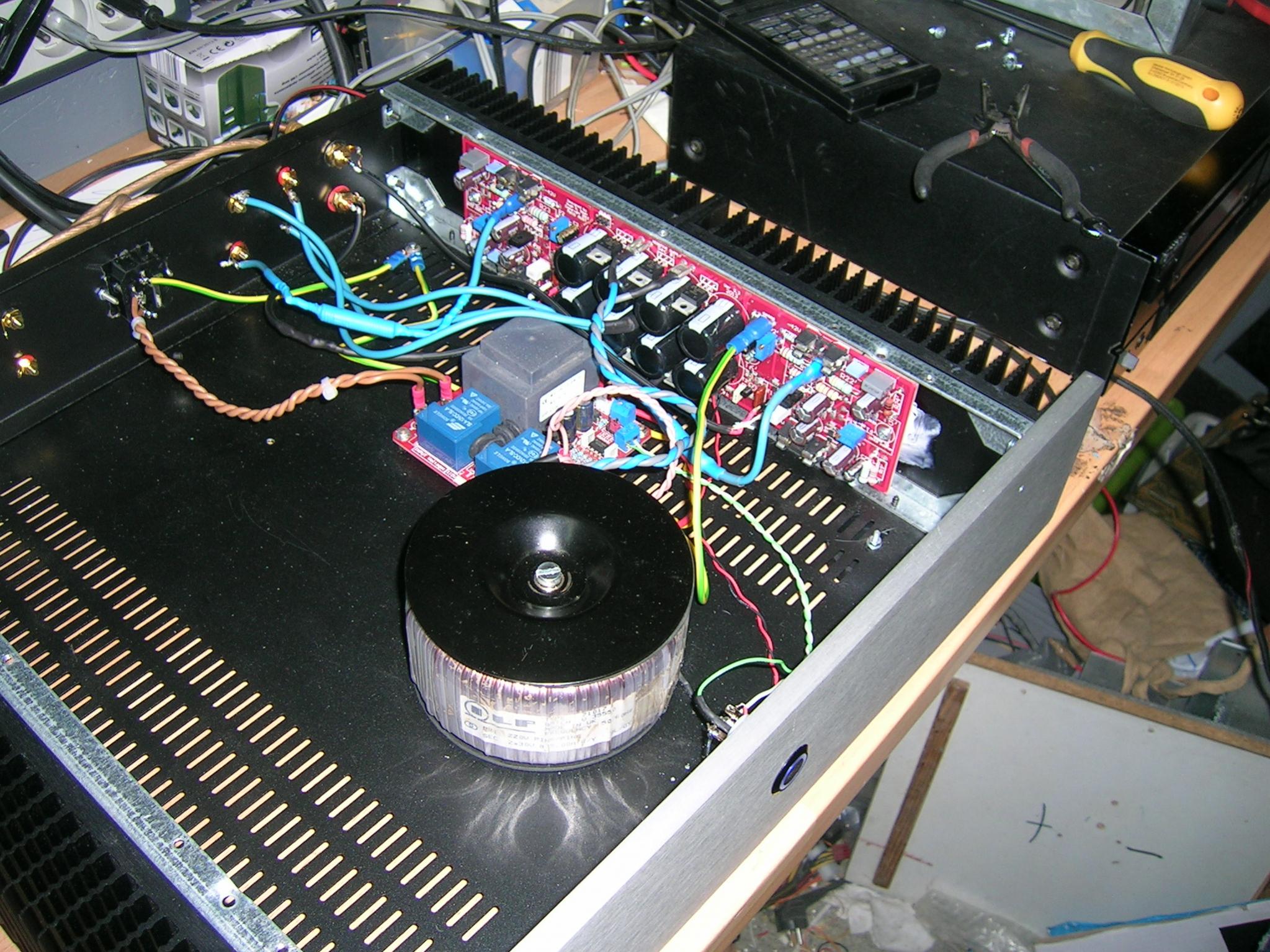

Hey Meanman, nice Job. I see you have prepared the case for another amp or was it from a previous project? I think my Naksa will be ready next week. I only have to build the transformers out of the Naksa 70 cases and in the Naksa 80 cases. I also build the cases myself. They are almost ready. I will post some pictures in a few days. I wish you succes.

Hugh Thanks,
Yes, I know and also planning to re-route the wires and use more flexible cable.
I'm using a momentary switch and a soft-start module and I'm looking for some kind of circuitry to switch for the N80 or the N70 or both.But I like it when it can be done with that one momentary switch.
