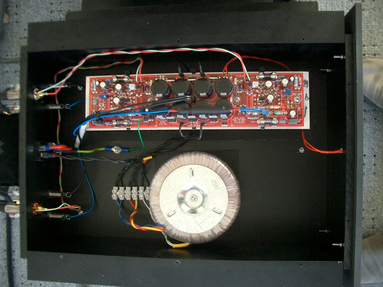

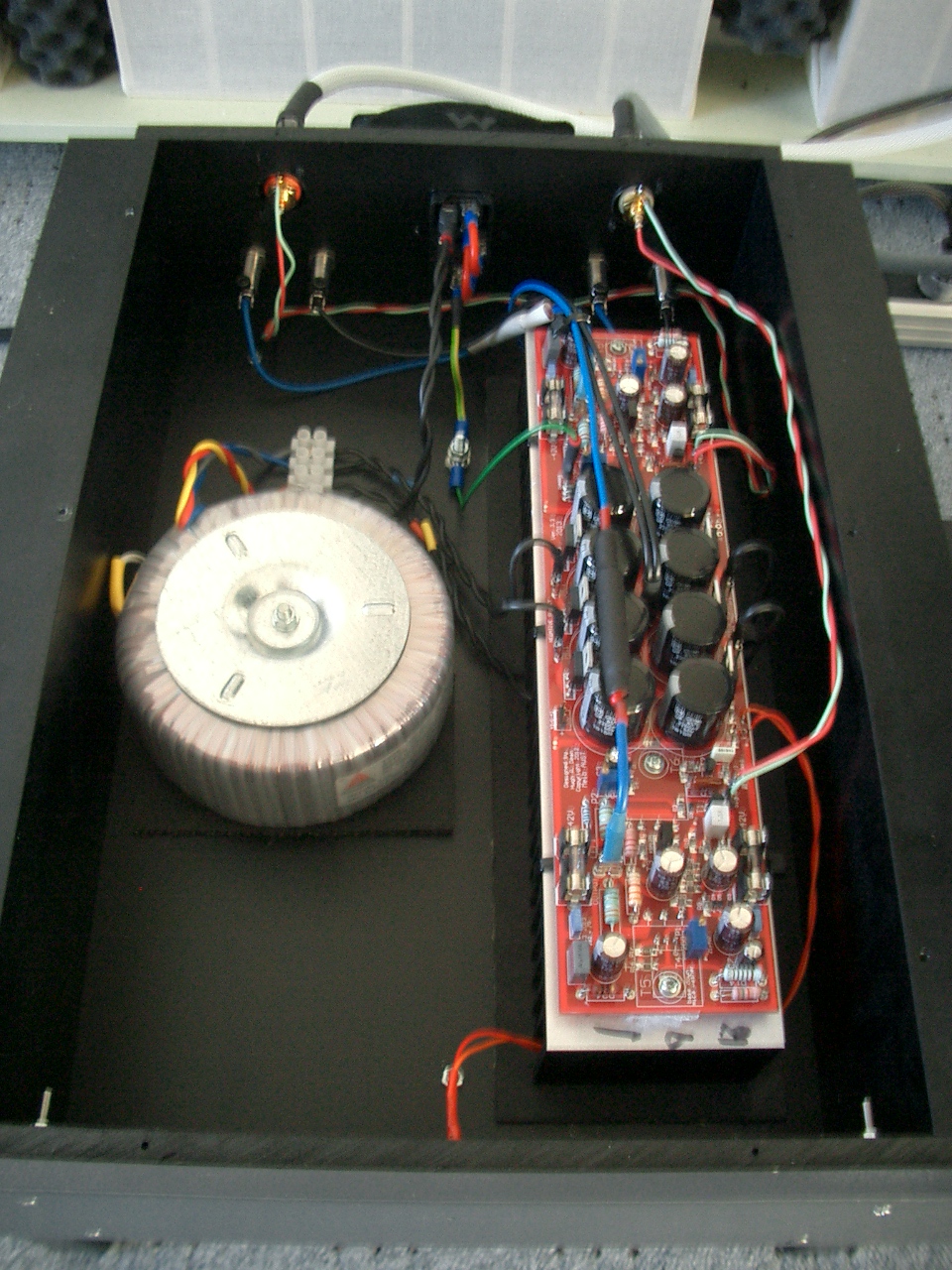

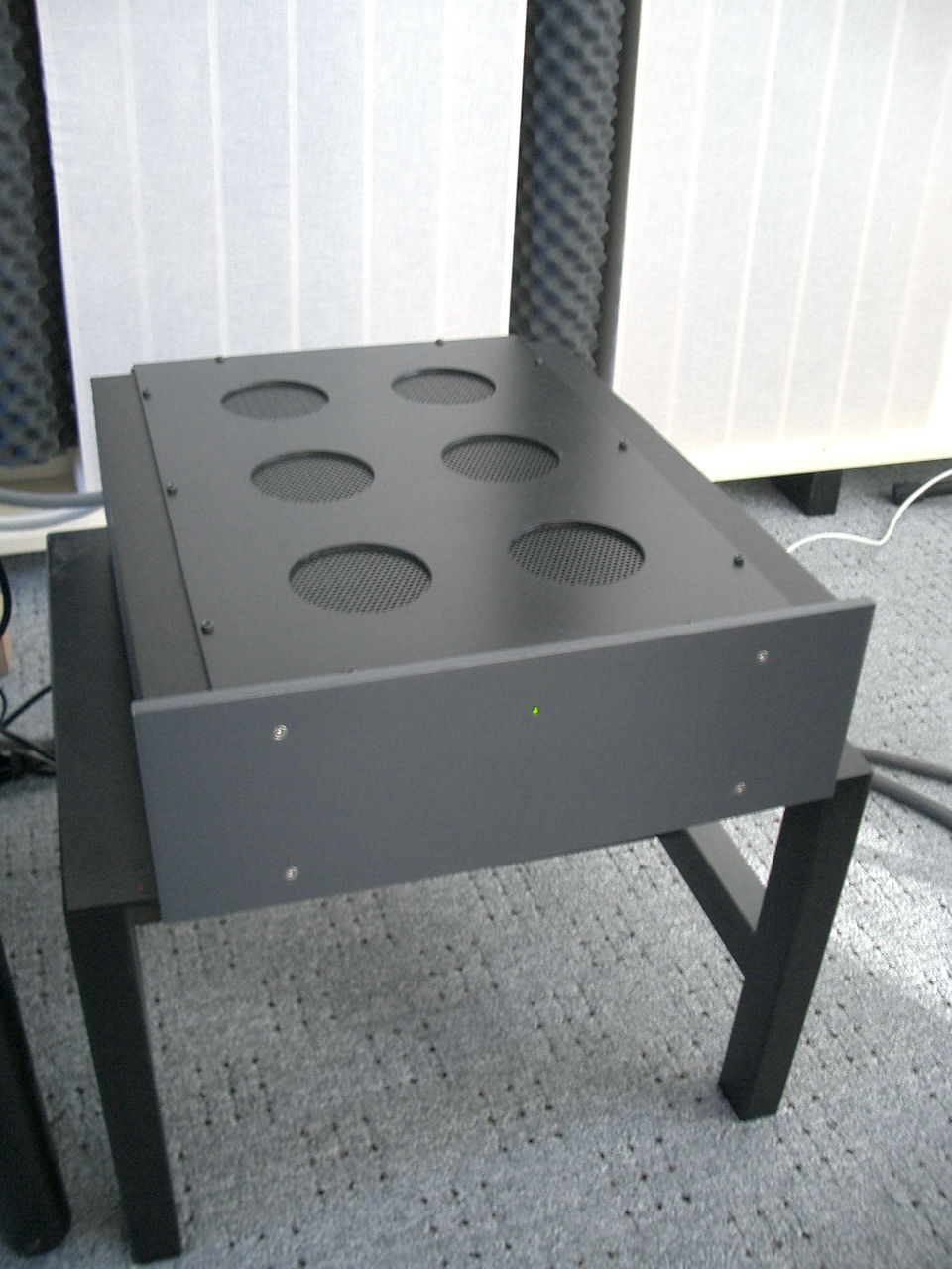

Hi Hugh,
My amps are up and running today. I constructed them without any problem. They are playing now a few hours and they sound great right from the constructing table. I heared the amp opening up already in the first hour of playing. Probably it will become better in the next days. I can hear that the Naksa 70 is a sister (or brother if you want) of the Naksa 80. They have some common characteristics but I think the Naksa 80 surpasses the 70 in a few area's. When I think the amps have reached their top I will write a review. For now I have posted some pictures.

Looking great Eric,but my advice turn your heatsink vertical.The way you did it the heat will stay under the sink

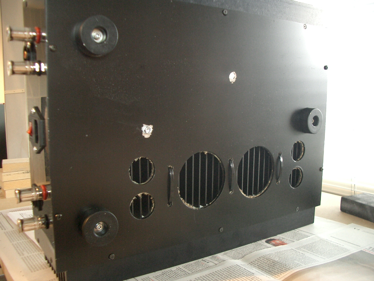

Hi Meanman,
Thank you for your tip but I have thought about that. I have made holes in the bottom of the case, right under the heatsink, so the case can "breathe" (see picture). I checked the temperature of the heatsinks after some hours of rather loud playing and the heatsink became lukewarm. I can keep my hand easily on the sides of the heatsink. By the way, you can see on the picture that I have fasten the amp with 3 firm tie-rips to the bottom of the case. The amp is located on a slab of lead bitumen, even as the transformator, to reduce vibrations. It was just an idea to do it this way so the amp is much more attainable. I discussed it with Hugh and he thought it was possible. I think it won't lead to heat problems, but again, thank you for your advice.
When I tested my N80 I had my sinks the same way on the workbench.When I turned my sinks vertical there was a difference in temperature just keep an eye on it to be shure.
Eric,
A wonderful implementation, very well assembled. Patrick's comment concerning the heatsink is valid, particularly in a hot climate and high outputs, but I am do not believe it will be a problem as you have it. In summer with high volume you will notice it runs hot, but while turning the heatsink through 90 degrees would cool things more I don't think it's essential in Holland. In Australia where temperatures are up to 45C yes, but not in northern Europe.
I'm so thrilled you think the sound surpasses the NAKSA 70. I chased after this pretty hard! The resolution is quite stunning, particularly at low levels - it sounds like a Class A in this sense.
Thanks for the piccies!
