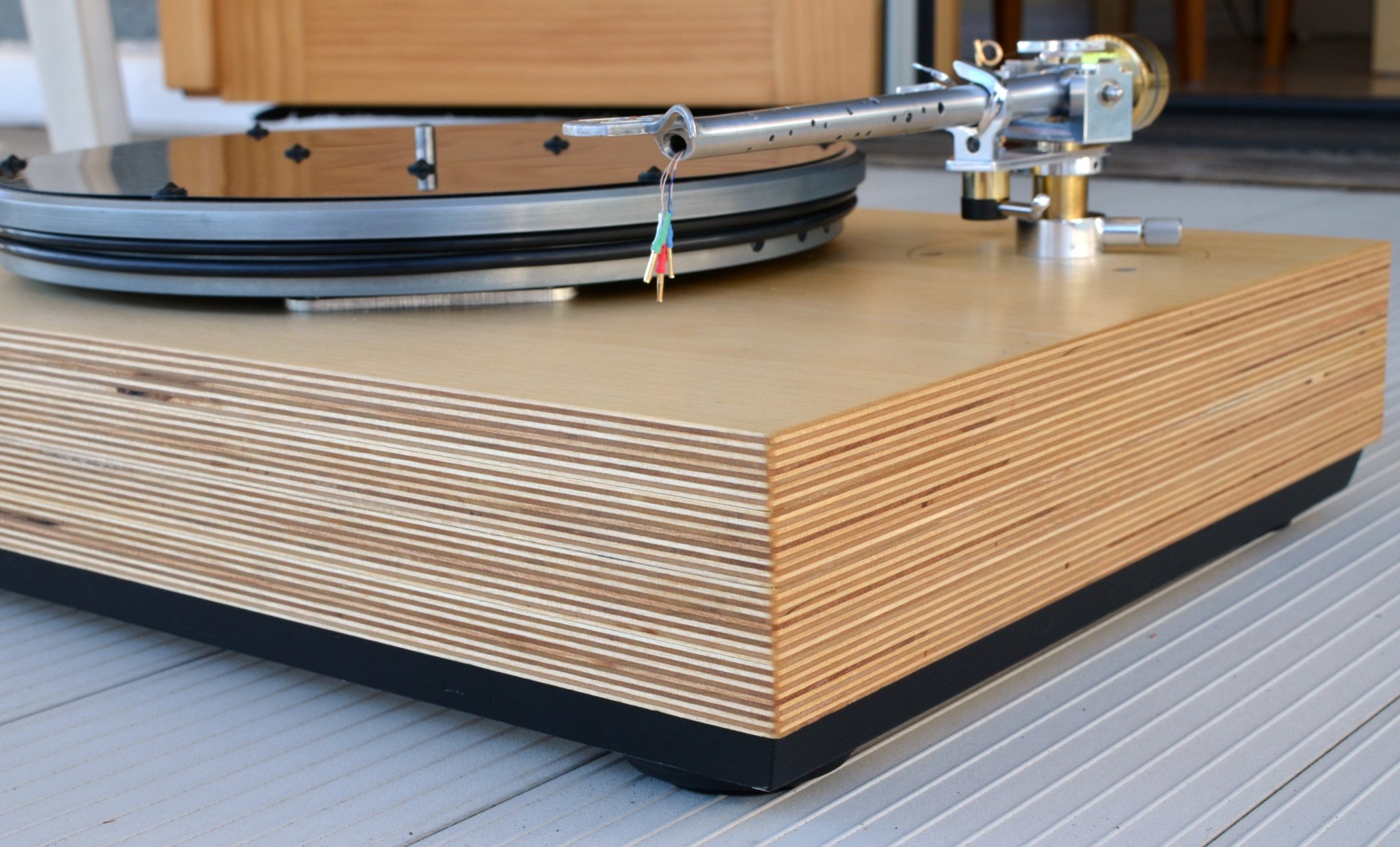

A more affordable solution could be a good second-hand SL1210.
You have to be lucky though, but my brother found one for €100 in perfect shape.

First and foremost, congratulations on getting started.
Your story brings me back to the mid 90's, when I was a hifi salesman and our store would regularly be visited by enthusiasts who would inquire as to how feasible it would be to start their own hifi brand (predominantly speakers, back then, occasionally an amplifier designer). Usually a conversation and tour around the shop would outline to them how hard it would be not so much to design something that would sound great, but to do several other things:
1) distinguish themselves in a crowded market (i.e. story)
2) scale up from prototyping to real manufacturing and distribution (i.e. operation)
3) be a profitable business (i.e. finance)
Apart from seeking expertise from people in sales, marketing and operations, please talk to some guys who actually done it. Investigate the businesses building and selling cartridges today (you may be surprised about what you learn). Also, please understand that the regulatory environment makes it not easy to properly sell a consumer product in Europe or North America.
