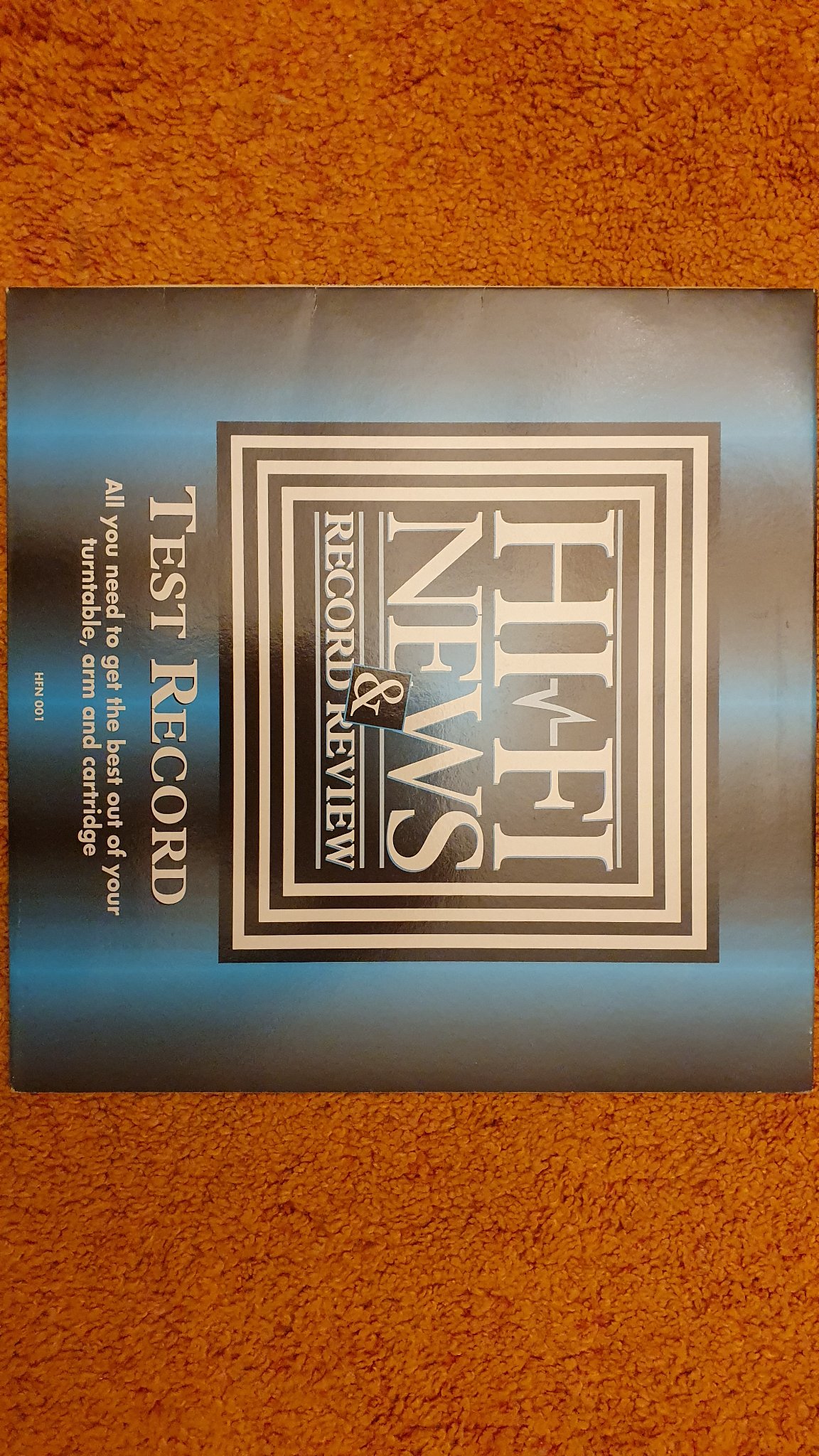

As for the measurements, I can recommend the most important parameters to measure. Both geometrical, dynamic, static electrical, and using test records. I have done all of them on my Denon DL-103. The most difficult was to measure the azimuth and the vertical tracking angle using a microscope. Distortion, channel balance, frequency response is the easy part.
Reactions: mahurkars

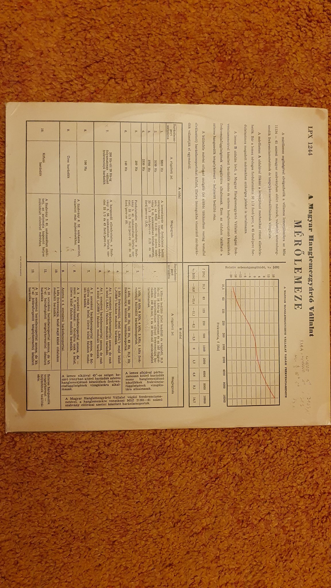

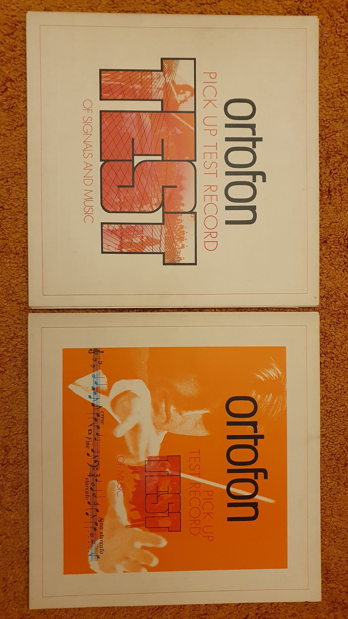

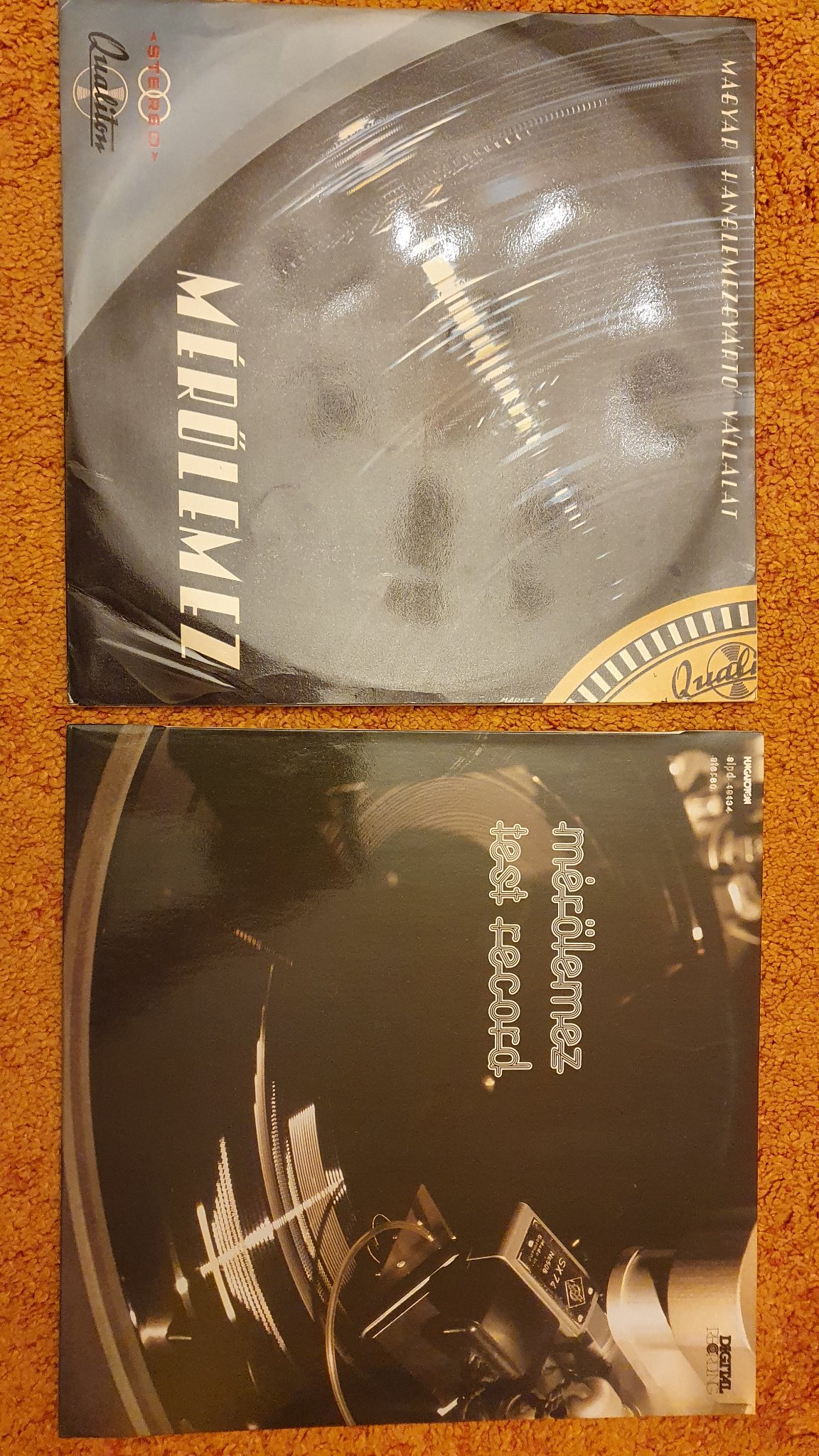

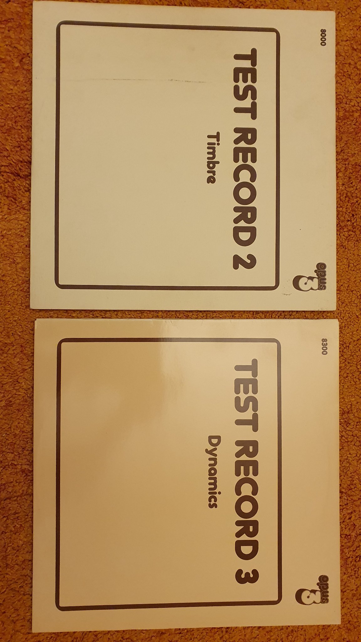

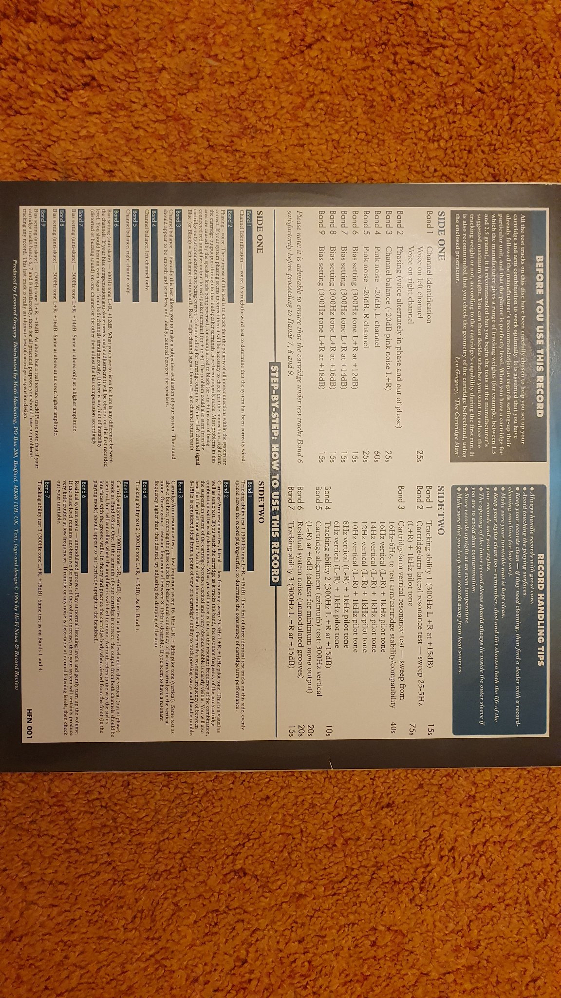

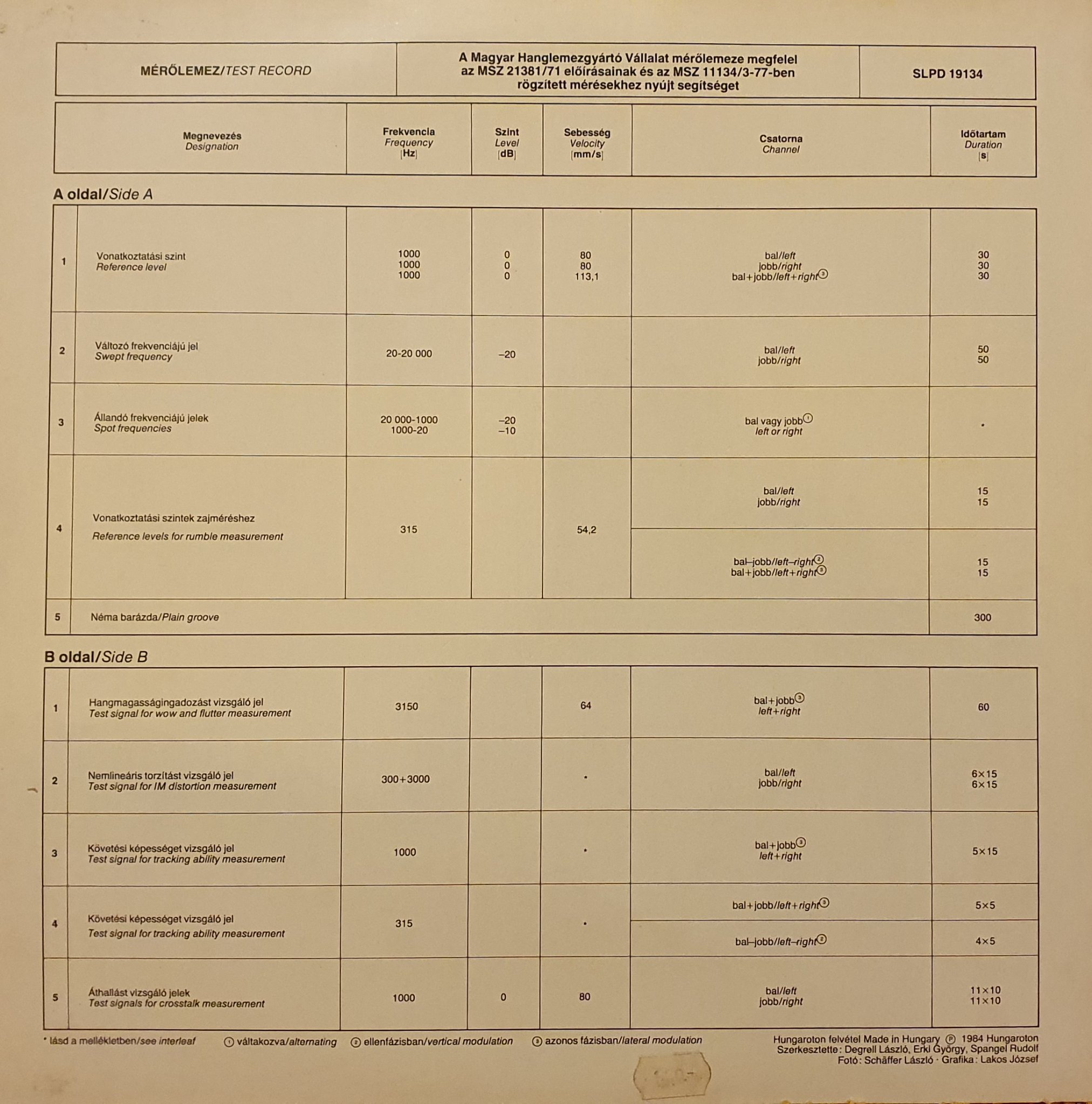

I have these test records (and more with music only). Most useful is the HFN&RR and the new Hungarian. I think the new or the old has azimuth tracks +/- a few degrees, but that is most useful for alignment of the cartridge and headshell.
Your VTA will be 20° or 25°?
