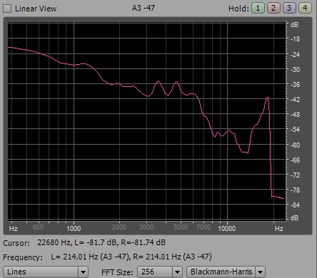

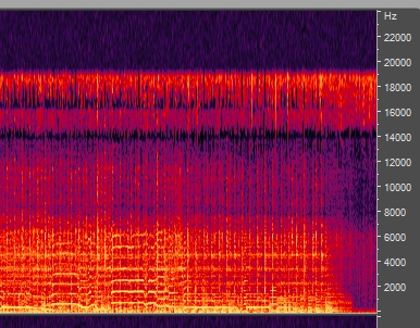

What is the weird (noise?) band in the 14-19kHz range in post #44? What about the linearity of the frequency response? Is the Audiolab set to MC?
You will need a test record with a frequency sweep.

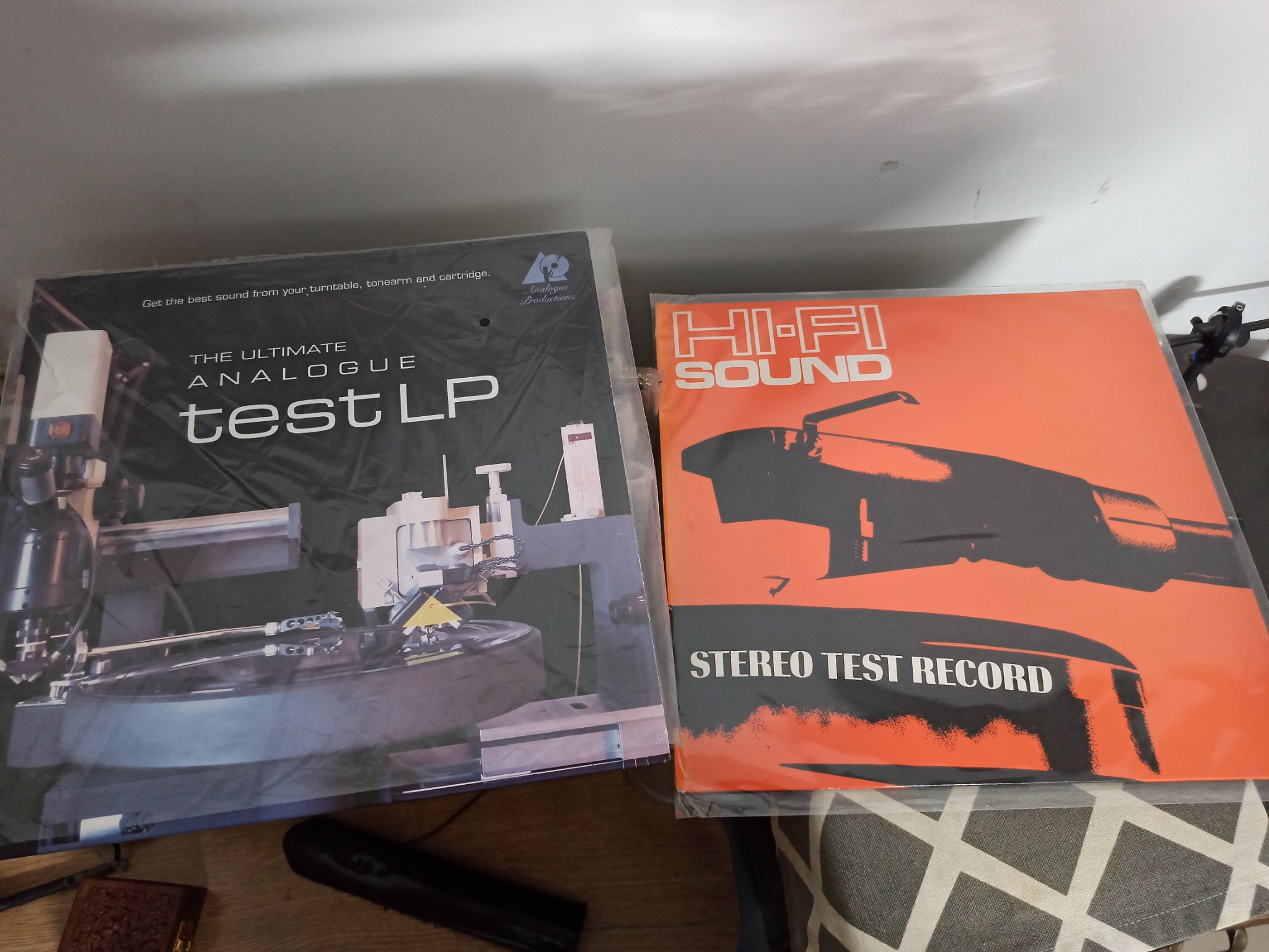

Yes Audiolabs is set on MC, can eliminate Sansui. Have couple test records, let me check freq. sweep.
I use Audition ($$$). In case you don't have that, Audacity is a free alternative, but I'm not really up to speed with that one.
It can be done in REW too but all of these programs have a bit of a learning curve.

As for the tracks on your test LP.
You can use track 6 & 7 on side one of the Analogue testLP.
Instead of using a voltmeter as indicated, I record the results with Audition (or Audacity) for analyses.
