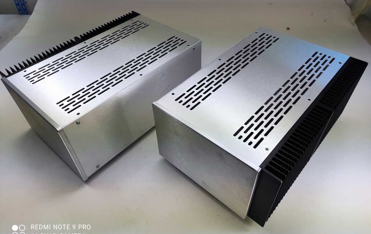

Thank you - that is very good news. Will there be a 4U/400mm and 4U/300mm version available?We plan to release this chassis around 1st - 2nd week of february 🙂
For now we plan to release a 4U/400 version only, if we see there is enough interest we could go for other models

I too would like to see the front faceplate cover the entire front including the end of the heatsinks if possible.

Front panel covering the heatsinks please.

No, this is an entirely new product which uses different 3mm thick aluminium panels. You can see them here https://www.diyaudio.com/community/attachments/img_20220111_122455-jpg.1014099/
Is it possible for the non heatsink side to have countersunk screws? And are the heatsinks mounted from the inside or are they tapped from the outside for mounting?No, this is an entirely new product which uses different 3mm thick aluminium panels. You can see them here https://www.diyaudio.com/community/attachments/img_20220111_122455-jpg.1014099/

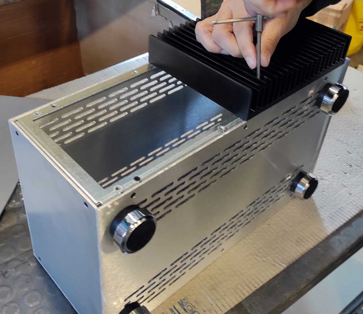

as I understand pictures, inner frame is tapped for screws
so, heatsink is having simple holes for screws, screw heads between fins
https://www.diyaudio.com/community/attachments/img_20220111_115139-jpg.1014092/

That's a shame, I like the extrusions, plus with all those exposed screwheads, including between the heatsink fins, I'll be less inclined to purchase - call me particular but I like to pay attention to the look of my projects. Still, I can always custom build using the old heatsink mounting arrangements and the extrusions.No, this is an entirely new product which uses different 3mm thick aluminium panels. You can see them here https://www.diyaudio.com/community/attachments/img_20220111_122455-jpg.1014099/

now, regarding screw heads between fins - that's matter of one's aesthetic sense/taste; can't argue with that
for me - nothing ugly there; as long everything is perfectly aligned and not too crowded, there is mechanical beauty
Thank you!
Anand.
The heatsinks are mounted from the outside, we have made some holes between the fins. The reason we are doing this is because some users have asked about the possibility to easily install and remove the heatsinks without having to remove the top cover and the brackets first. The inner cage also allows us to use countersunk screws for both covers (something which has been very requested for other chassis with heatsinks as well!) and if this project goes well we may use it for Dissipante series too to avoid problems with brackets when mounting everything.
