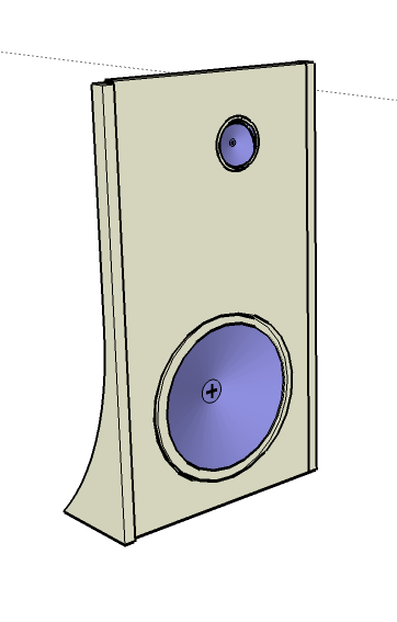

well a sketchup of my idea...
asthertically similar to the Linkwitz Orion (which I think is quite nice to look at).
No other changes. (except perhaps a change to the Hemp Acoustic FR4.5c from the FE127, which in modified form is excellent. Dave, your thoughts?)...
Baltic Birch Ply, or hardwood IKEA counter top for the baffles themselves.

BHD said:but by wiring two sixteen ohm woofers in parallel gives you an extra 3db of efficiency and would halve the impedence, making the design of a crossover to an eight ohm full range easier...
Here the 8 ohm driver is going to be your friend. Put 2 in parallel for 4 ohms. You have just gained 6dB at the same voltage. That helps a LOT. Not only that, now your (passive) low pass filter will need an inductor of only 1/2 the size the 8 ohm woofer(s) would. That's also a big help.
Don't worry about making the design of a crossover to an eight ohm full range easier, it isn't easier. In fact it will be more expensive, because of the larger inductors needed. It's a trick that works well, the 4 ohm woofer, or 2 8s in parallel.
With 2 15" 8 Ohm drivers you will gain 6dB of bass over a single driver. Those 6 dB will bring you much closer to your mid/high driver. That's a good thing.
