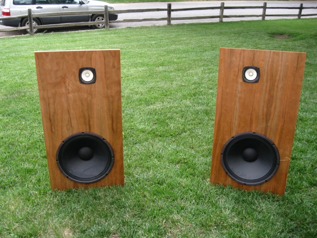

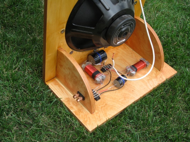

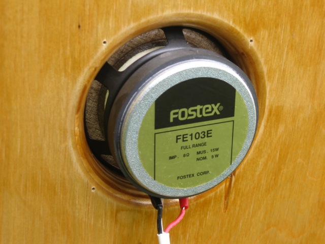

Another pair
I've been listening to these, 'unfinished' for 3+ years. I just got around to the wood work and router work behind the Fostex.
There are a few mistakes in the finish. I guess that adds to the character. I sure do enjoy how they sound.
Ryan

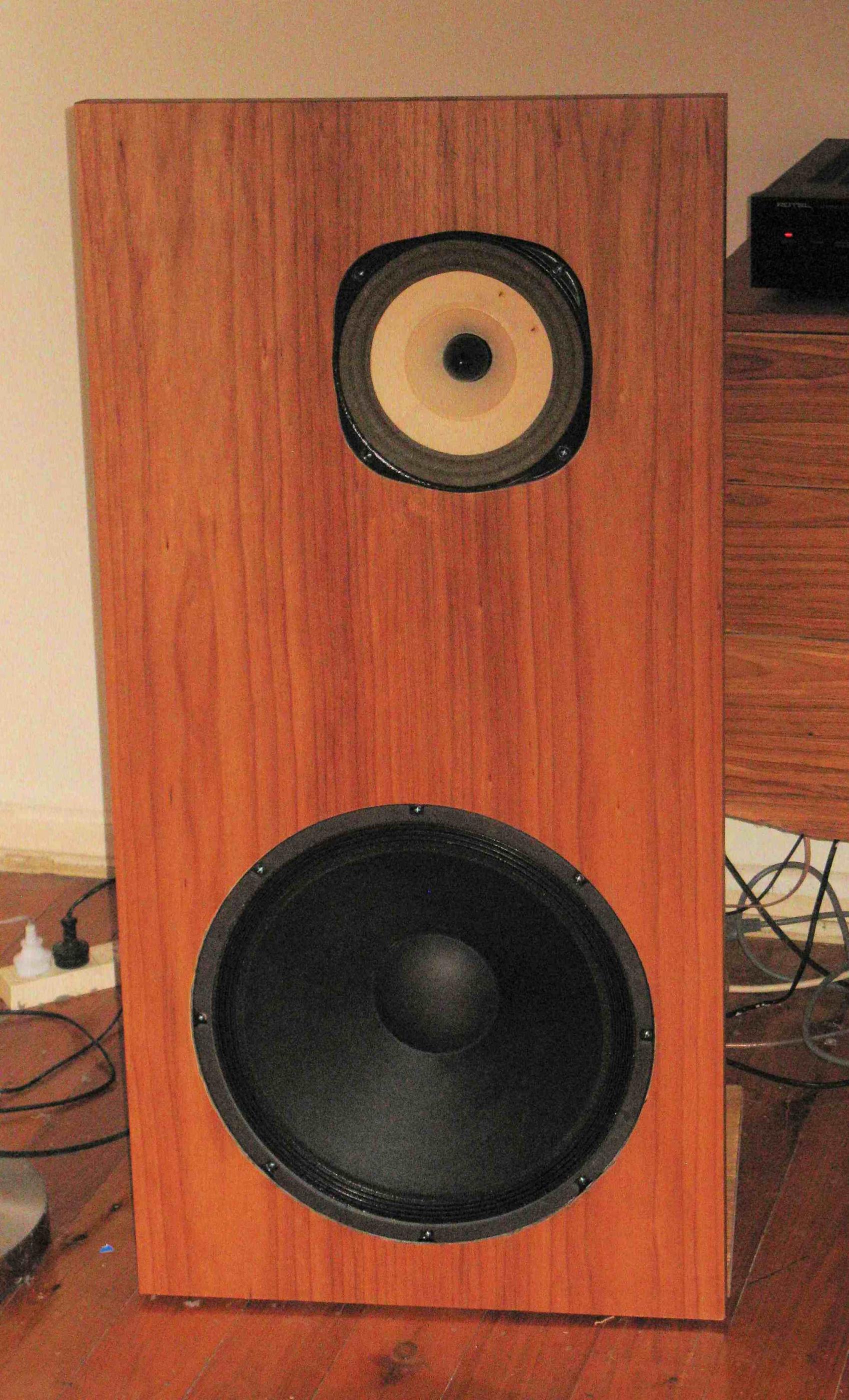

I too have just built a pair of MJK open baffles. My implementation has used Lowther DX3s, Alpha 15s and miniDSP as an active crossover. I drive the DX3s with a Trends T-amp and the Alphas with my old Rotel 40 watt amp (a little small I know but just fine my for modest volume needs) I used Martin's crossover points of 200 and 400hz and no equalisation.
Result: fantastic - if you're reading this you've probably read the other posts about MJKs OBs - they're all true. I was in the fortunate position to already own a pair of DX3s, however I'm sure any one of many other wide rangers would fit the bill.
I would recommend the miniDSP - it gives you the choice to run the driver of your choice and its a breeze to configure.
Just a note on the bass sound - it is articulate, sounds like about 40hz and its a "big natural" sound. "Normal" 6.5 - 7inch polypropylene mid bass units (to my ears) have a more "authoritative drier slam" - not bad but different. I'm very happy with these - I can't imagine building anything better.
