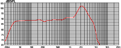

I know you have used the Alpha 15 in this sort of application. With a crossover at 300hz it seams that the 10db rise at 2K is still an issue, do you use a notch?
Sean
Sean
Sean,
In both my OB designs the crossover for the Eminence Alpha 15A is second order at 200 Hz. At 2000 Hz, the input signal is down 40 dB according to my quick calculations. Are you worried about a 10 dB peak for a signal already down 40 dB with respect to the reference SPL? I am not too worried about it and have heard no evidence of a peak at 2000 Hz from my Lowther OB system which uses two Alpha 15A's per side.

MJK,
DOH!, I need to remember to actually check my math. Between using 300hz as the CO and missing a doubling when doing the mental estimation (meaning I really used a 600hz CO) I was off by ~16db.

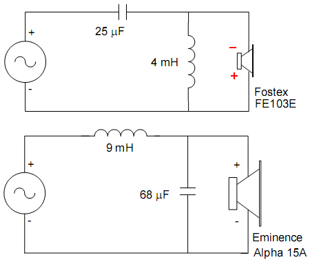

Hi Gio,
The polarity does not need to be reversed. If this were a textbook case, pure resistance load and coincident point sources, it would need to be reversed. The picture below shows the SPL and phase of the two sources at the listening position.

What about hacking out the Alpha 15's dust cap and installing a wacko wooden phase plug? I think that the Eminence's huge mount of midrange ringing might be sabotaging overall clarity even if it is located far from crossover.
I think that is a terrible idea. A phase plug will have no impact on the frequencies being produced by the woofer in this design (40 to 200 Hz). I have never heard a ringing problem from the four Alphas I am using in my open baffle system. In my opinion the risk of screwing up a good driver are far greater than any slight potential for improvement. Have you tried the Alpha 15A driver in this type of system and heard a ringing at 2 kHz?

Hmmm, Impulse response will show in its trail edge. You won't hear it clearly ringing but you will hear it by its absence if fixed. A hobby knife taking out a dust cap is nothing to be afraid of on a cheap woofer. It can be easily glued back. No I haven't done it on an Alpha. But you thinking its an outright terrible concern, maybe it isn't.
I quote Tom Danley: "A bad sign (regardless of cone material) for a direct radiator is a large peak(s) associated with its hf roll off. It is assumed that a steep or low crossover fixes this problem but it is not gone. So, picture a driver with a big mound in its response associated with breakup.
Lets say that mound is 10 dB high above the “flat” response zone, this represents an frequency dependent acoustic gain element AFTER the voice coil.
So, here is where it is not fixed even with a brickwall crossover.
The driver’s motor produces harmonic distortion, that acoustic gain amplifies it by 10X (10dB) for harmonics when the fundamental is N fraction of the peak.
In other words, if the mound were at 1200Hz, the third harmonic of a fundamental at 400Hz is amplified by the acoustic gain even if one had a 120,000dB / octave digimatic crossover at 500Hz. Here it is better to fix the source.'' Its taken from
here . In the attachment is the published Alpha 15A chart.
