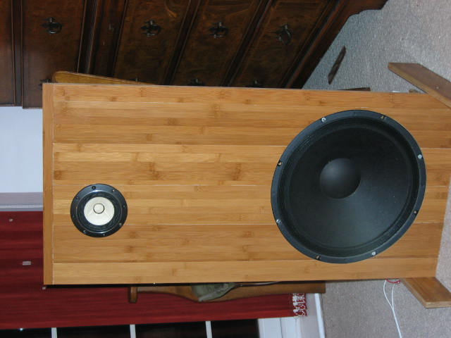

Here's a half-completed, half pair, just couldn't wait to listen...
Spot the deliberate mistake. :-(

And here's the half completed pair.
Note the important point that they are in my workshop / diningroom, rather than my summerhouse / workshop where such projects are usually completed!
Quote from distaff: "Aren't they nice?" "And don't they sound nice?"
Incidentally, this more or less confirms my initial impression that they are a little bright, she being a little deaf... LOL....
The imaging is excellent, hanging between and behind the loudspeakers, which disappear (acoustically!). I really like the way open baffles drive the room and these are my 3rd pair and by some margin the smallest! The bass in particular has lots of air and tonal detail. I was listening to something on R3 this morning and was struck by how nice they really were in this respect.
I'm going to put a pad in for the 108ez and tone down the top a bit, but, on the whole, quite pleased.
Thanks (again!) Martin....

Additional information: When driven a little harder, the image collapses, the sound becomes confused.
At the listening levels used early morning I was delighted that i could detect no vibration on the speaker. At the later levels, there was significant vibration on the baffle.
If the flapping baffle is responsible for this degradation, I have two solutions:
(1) Mass load the driver and isolate from the baffle
(2) Improve the characteristics of the baffle.
Any suggestions?
If it isn't the baffle vibration, what else might it be?
Mark
Ah, you mistake me!
I would imagine that the 108 was nowhere near it's limits. This is a small room and I don't listen loud....
I did wonder whether a cheap inductor might be saturating, but I even doubt that.
I could stick an ac voltmeter across the loudspeaker if this might help. Personally I wouldn't know what was ok!!
