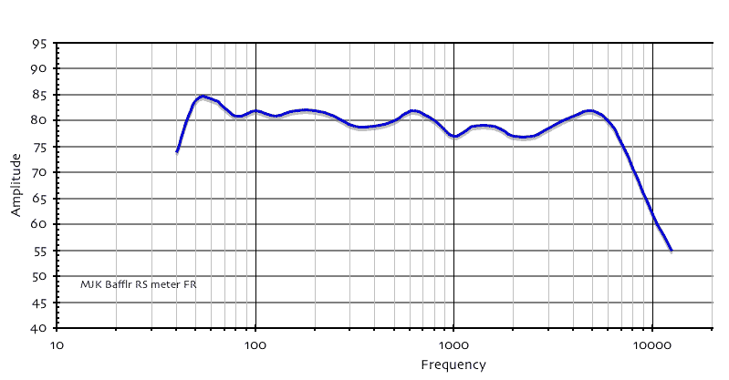

mor2bz said:
with the cheapo ratshack analog meter at about 8 ft with
the bass boosted 5 db at aprox. 50 hz. (boost curve unknown)
Here are my measurements with some small tweaks to the initial build. I have also measured my B&W Nautilus 804 for comparison. The 804 may have a better curve; but it's absolutely no match to the OB sound to my ears. I'd welcome any suggestions on how to make the MJK OB even better.
Here are the tweaks I've made to the initial built:
- upgraded to FE108EZ
- added a 2" wide "frame" around the back of the baffle
- rounded the baffle edges
- added a 9"x25" triangular wing behind the baffle
- added an L-pad (currently set to max)
Measurements were made with:
- ETF
- Radio Shake digital SPL meter as mic/pre (with the analog SPL meter compensation file on the ETF site)
- EL84 push-pull amp
- Creative MP3+ USB Sound card
Measurement at 1m on axis to the FR :
Measurement at the listening position (approx 4' x 8' off)
Comparison of the above with a B&W Nautilus 804 pointing directly at the listening position.

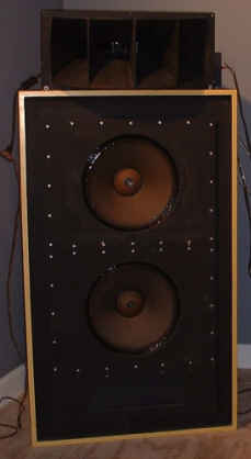

FYI, in the early days of audio, speaker systems were designed by some of the country's best electrical mechanical engineers money could buy and they chose 1" no-void marine grade plywood framed/braced with full size 2 x 4s for their woofer OBs used to fill in the below the large mid-bass/mids/HF theater horns.
Overkill? Maybe, but I built these 20 ft^3 cabs almost 40 yrs ago with 3/4" no-void marine grade framed/braced with the down sized 1.5 x 3.5" '2x4' stock of the day and can still balance a coin on edge and play 16 Hz - up as loud as most folks can tolerate that aren't stone deaf without it moving, so considering an OB is a lean-to wall, I'm thinking not.
GM
