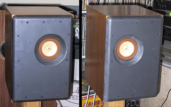

I haven't seen this mentioned in the thread so far (maybe I missed it) but has anyone thought of rear mouting the FE103 on the baffle and using a front roundover? Rear mounting would better time align the drivers, be less restricting on the rear wave, and facilitate better (possibly) mounting methods (i.e. clamping the driver to the baffle instead of using 4 screws).
The newer 103s aren't as ameniable to this as the older ones because of the shape of the bezel.
dave
