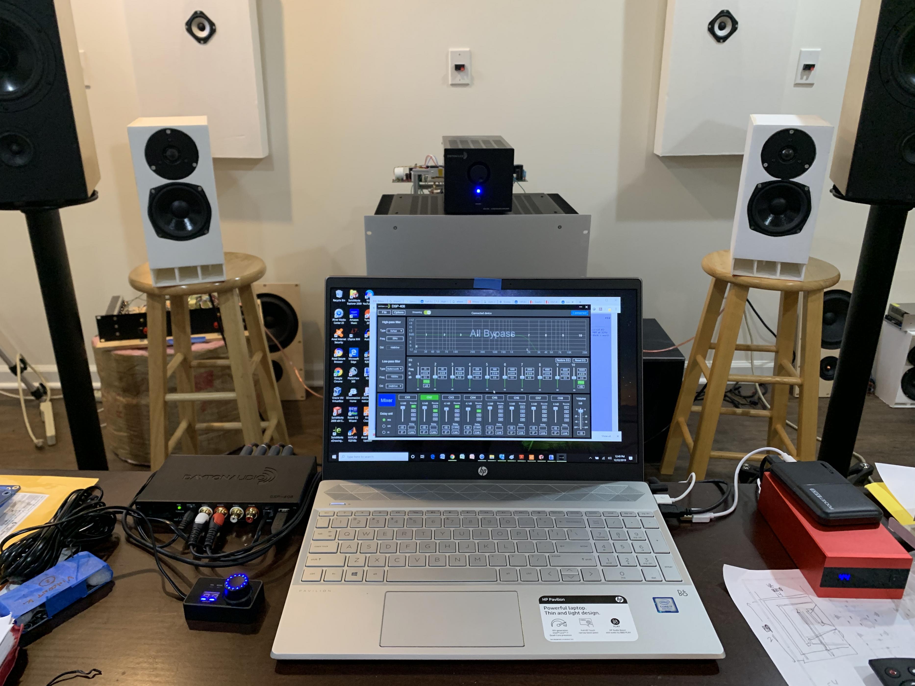

I recently tried out a Dayton DSP 408. Very nice build quality - thick CNC machined black anodized aluminum case. 4 in and 8 out with optional remote digital volume and 6 preset selector. The software is a single page single executable. Everything you need on one page, no nested menus. Has an Android or iOS app for changing DSP instead of a PC. Probably fewer advanced features compared to miniDSP, but has essentials you need for all typical IIR active speaker. Price is very competitive at $150 plus $20 for remote. With available $30 BT dongle, you can stream music too.
Dayton Audio DSP-408 4x8 DSP Digital Signal Processor for Home and Car Audio
I found it very user friendly and the sound is good - similar to miniDSP with Analog Devices ADAU-1732. Worth a look if you need ability to change between settings without a PC needing to be connected. Smartphone connectivity is a bonus.
