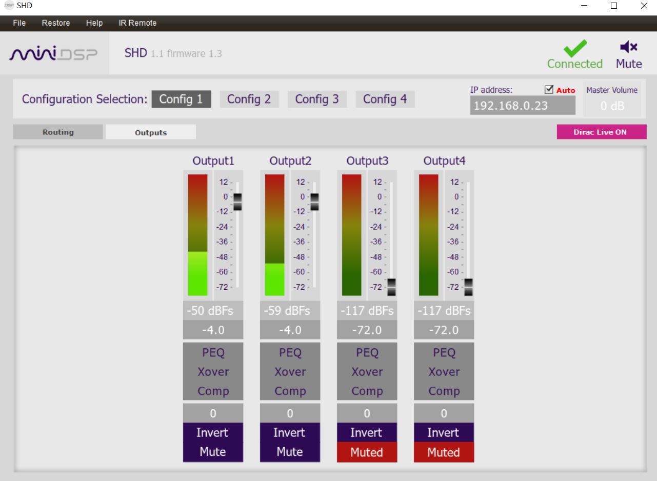

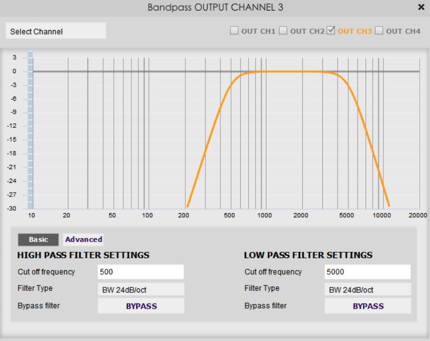

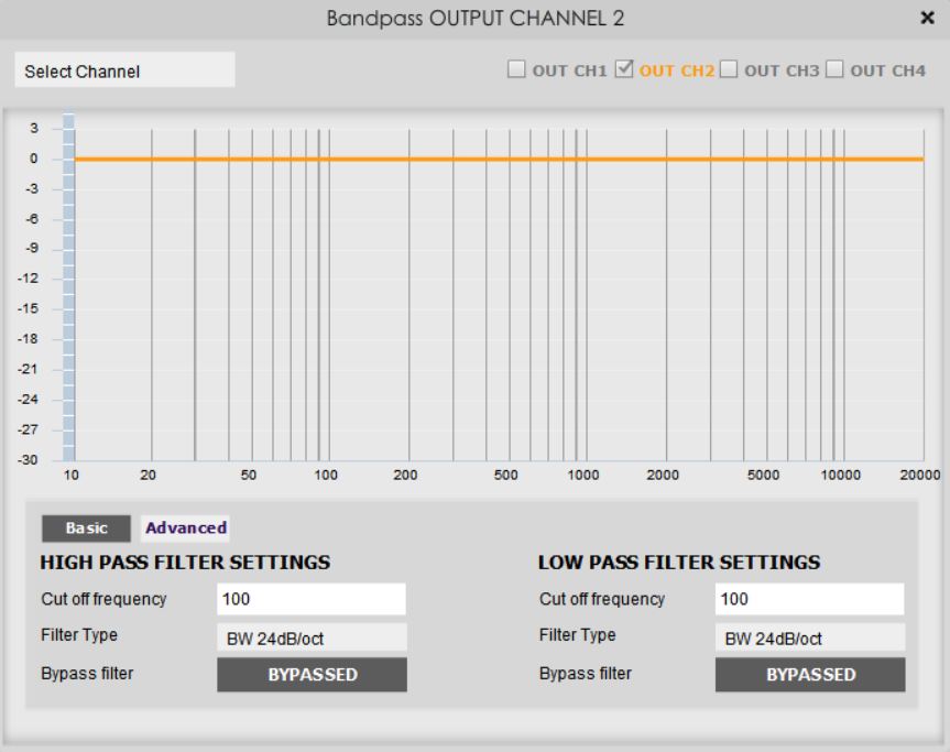

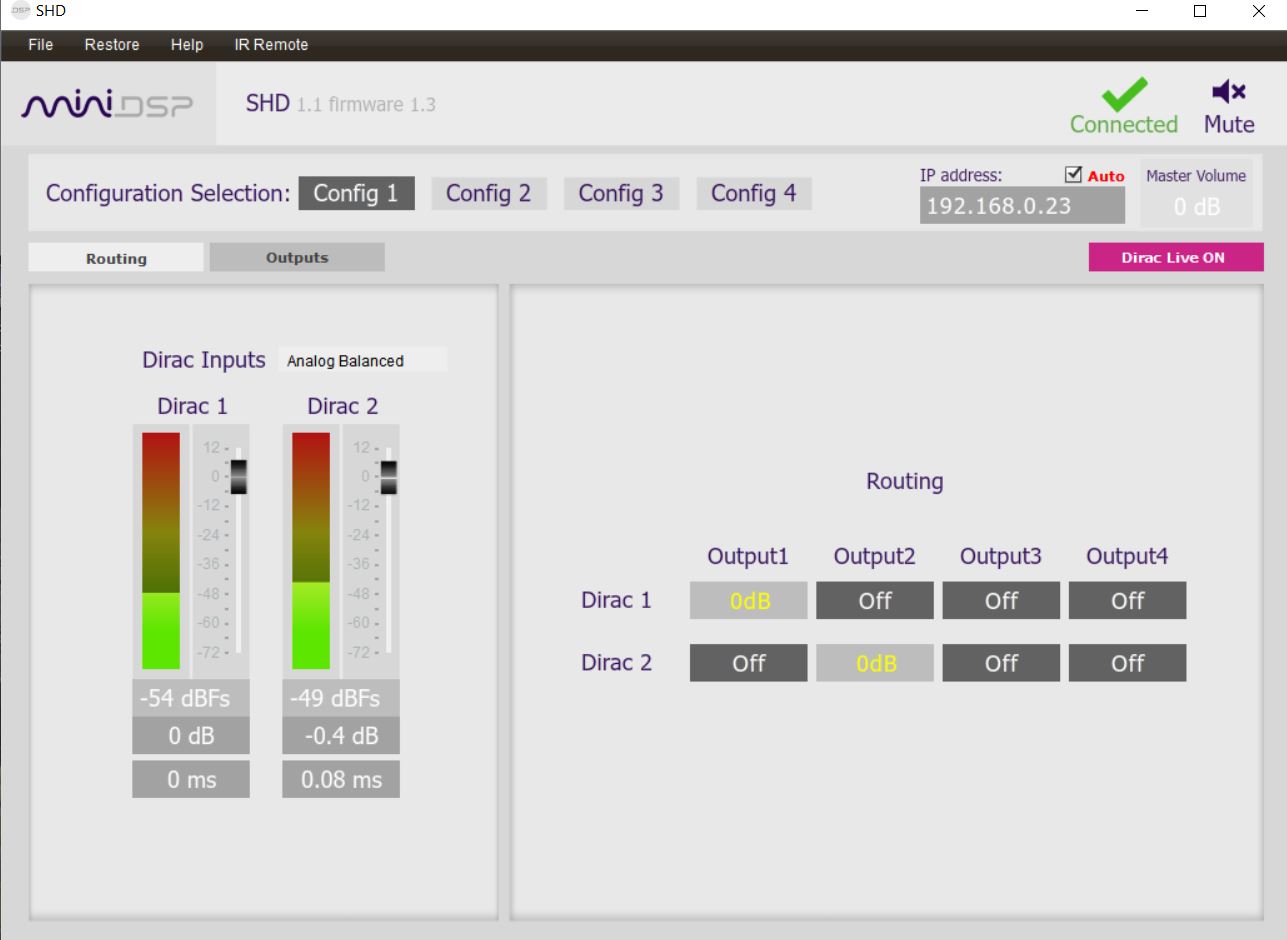

The crossovers are quite flexible if you need them. Note that each of the 4 channels is fully independently configurable for both high and low pass. Outputs can be assigned to either right or left input as desired. BW 6dB - 48dB in 6dB steps is supported, LR12/24/48dB is supported as is Bessel. (2nd order only IIRC)

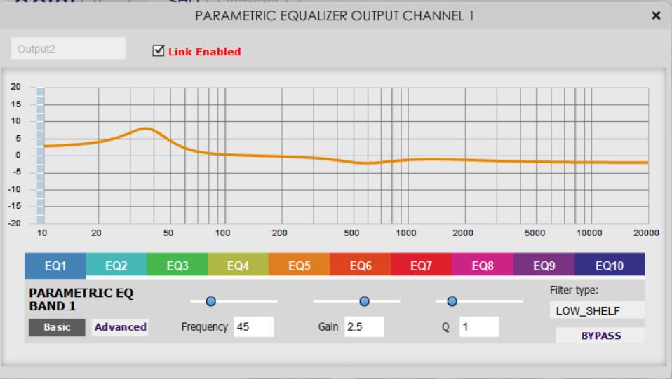

The PEQ in basic mode is quite useful for my purposes, advanced is a lot more flexible and gives you direct access to 10 biquad filters per channel.

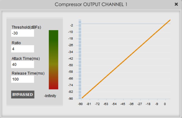

I have uploaded some screen shots from mine.

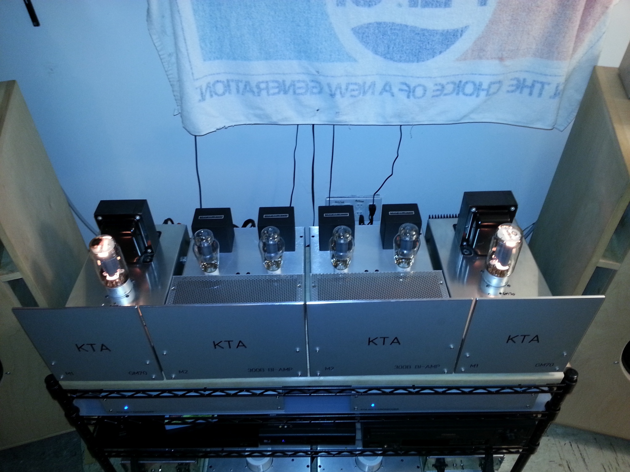

The system it lives in is quite outside of the normal environment for a device like this.
Six channels of DHT amplification driven by 24dB/oct LR4 electronic crossovers, line stage is transformer coupled DHT, and lots of transformers. Connections between amps, crossovers, SHD, and line stage are all balanced. Speakers are horns and Onken bass cabinets - very efficient. The SHD is quiet enough to work unobtrusively in the system.

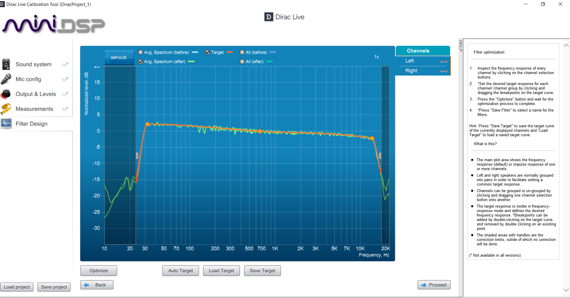

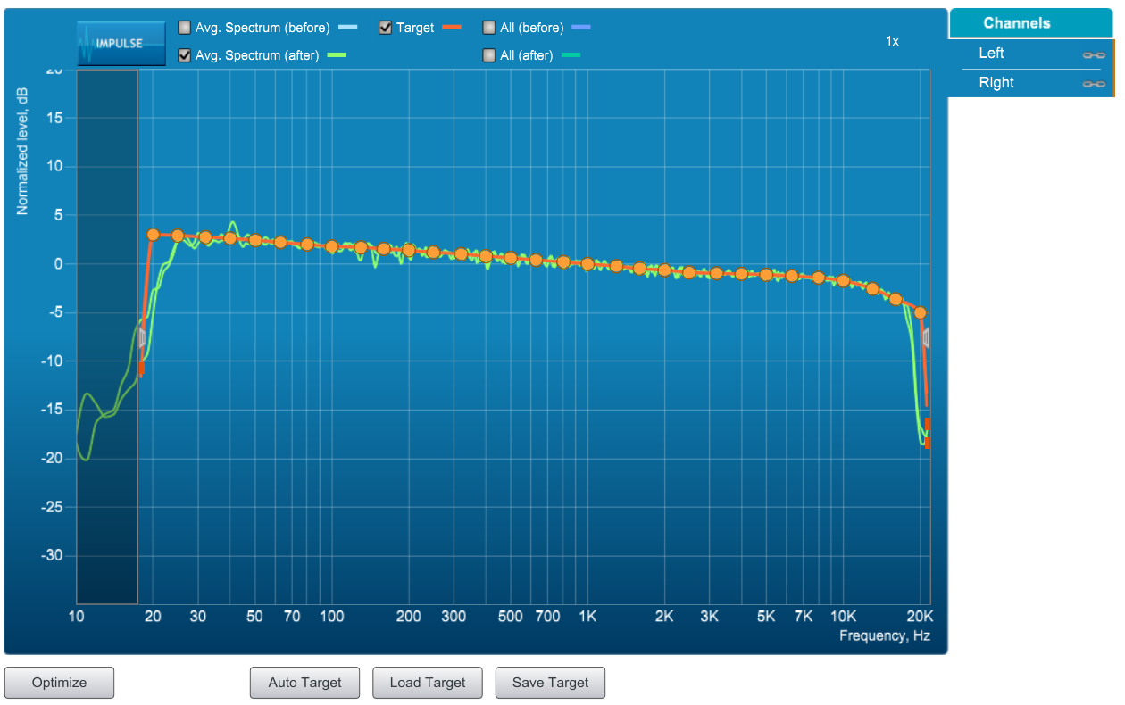

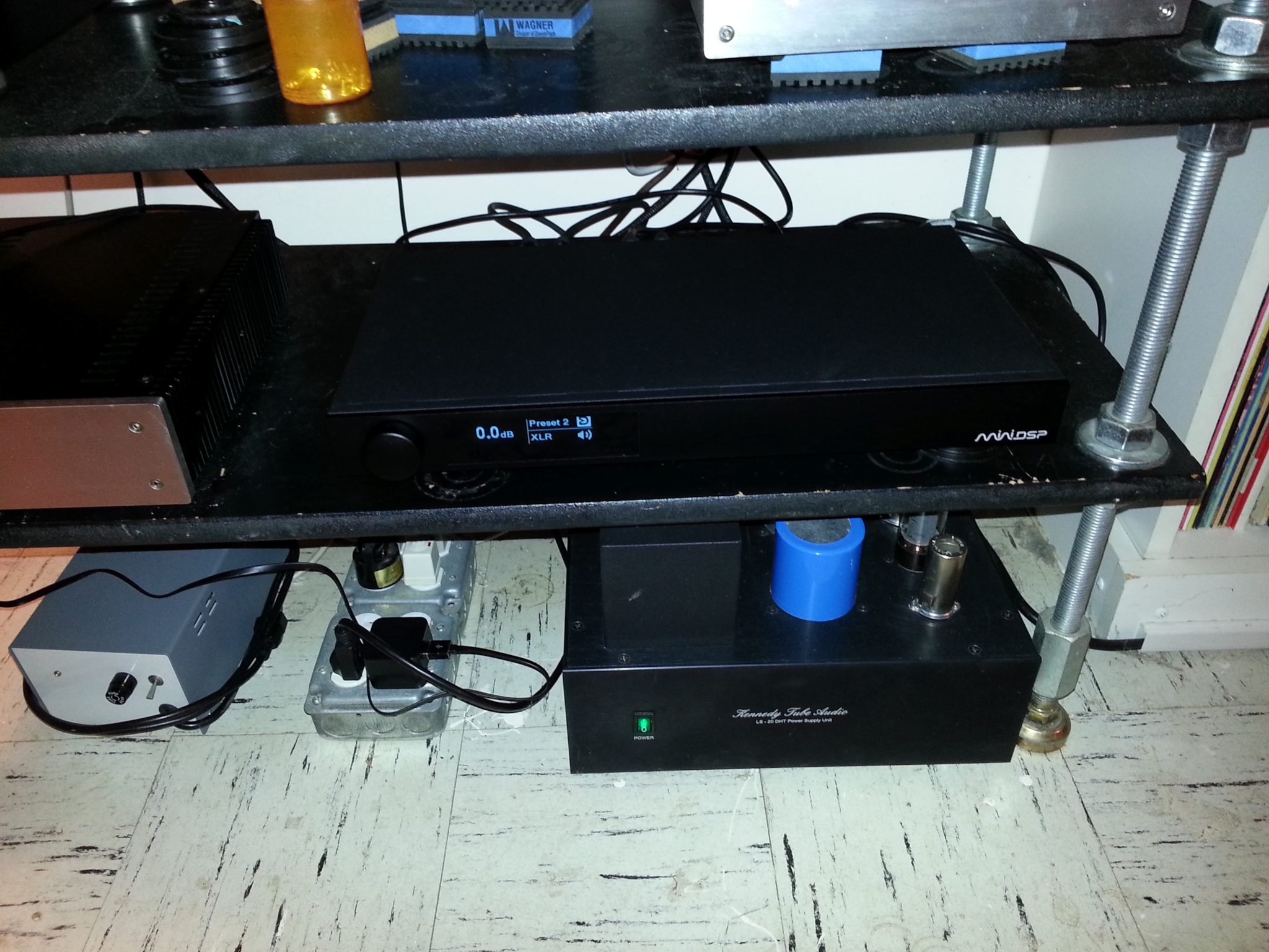

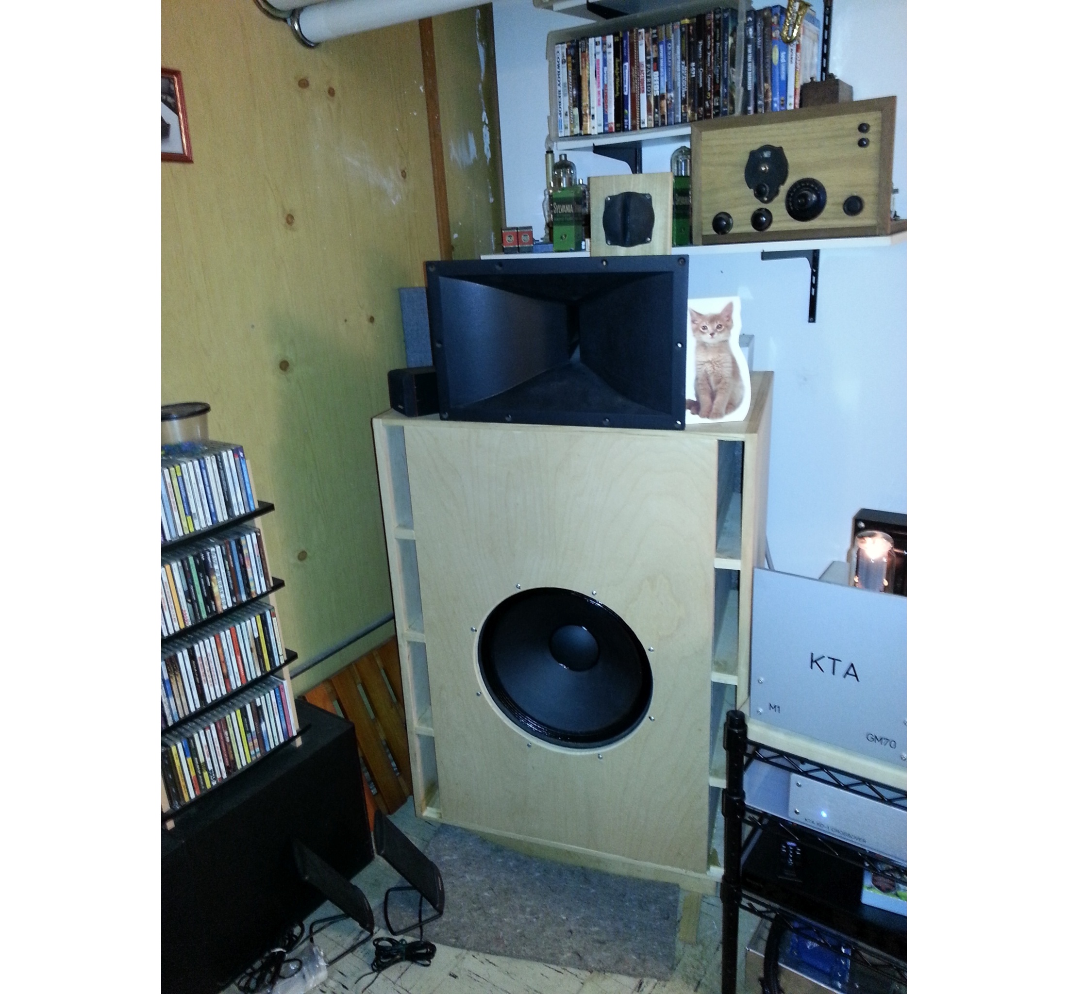

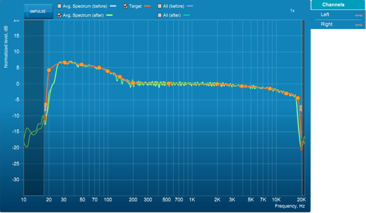

I'm pretty happy with the unit at this point. I have reconfigured my system a bit an rerun the calibration today.
I've read commentary here and elsewhere about how flawed Dirac is, but the difference I hear actually isn't particularly subtle.. 😀 It seems to work quite well and I'd rate it as pretty effective. I have done manual measurements and equalized things manually using REW and parametric EQ in the past and I'm quite happy to let my laptop do the heavy lifting for me.

A further comment..
It's pretty transparent, and quiet enough there are unlikely to be many if any systems that it could degrade from an SNR standpoint in any meaningful way.
It does what it is advertised to do, and quite well.
I stepped out on a limb when I bought this thing, turns out to be a pretty substantial limb.
I am going to experiment with some of the other features, it offers a lot more than just room correction processing. It would make a pretty good control center for a pretty high end set up.
The only review I found was very limited in that it only dealt with its D/A converters which it remarked are more than respectable. The reviewer had none of the proprietary software and couldn't test the performance of any of the features which are the primary reason for my purchase.
I was more than a little queasy jumping into the deep end of the pond with essentially no information not gleaned from the rather comprehensive user's manual. (Not an easy read for anyone with ADD 😛 )
Fundamentally I relied on MiniDSP accurately representing the merits of their product, and if anything I'd say they slightly understated the case. Rather refreshing difference from the typical hyperbole in high end audio where they promise you the moon and deliver something considerably short of the goal. This device by the way is most definitely high end. Does its job pretty unobtrusively compared to the analog EQ it replaced and does things that unit could never do.
The remote interface is clearly buggy, but that will likely get sorted out over time.
