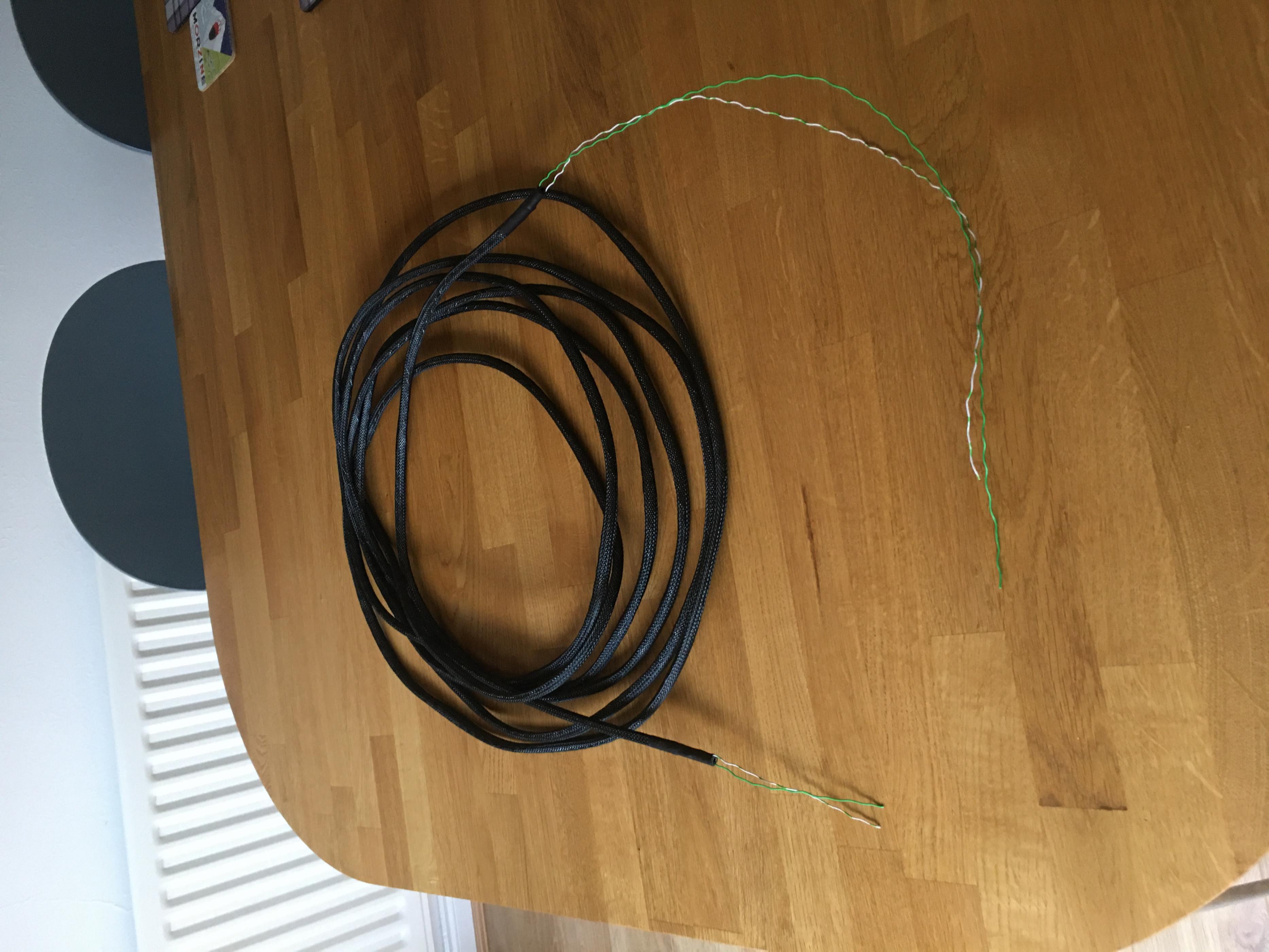

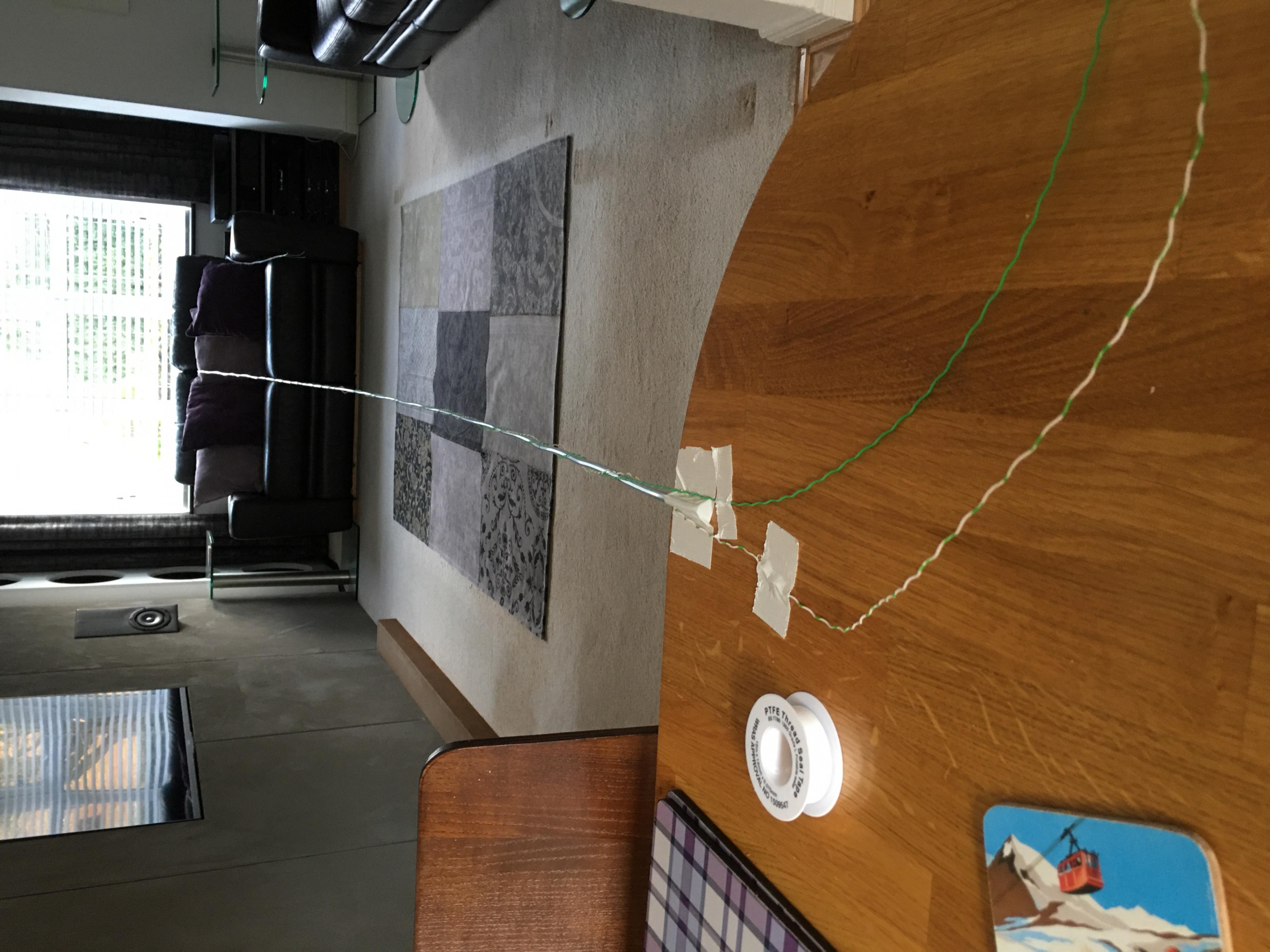

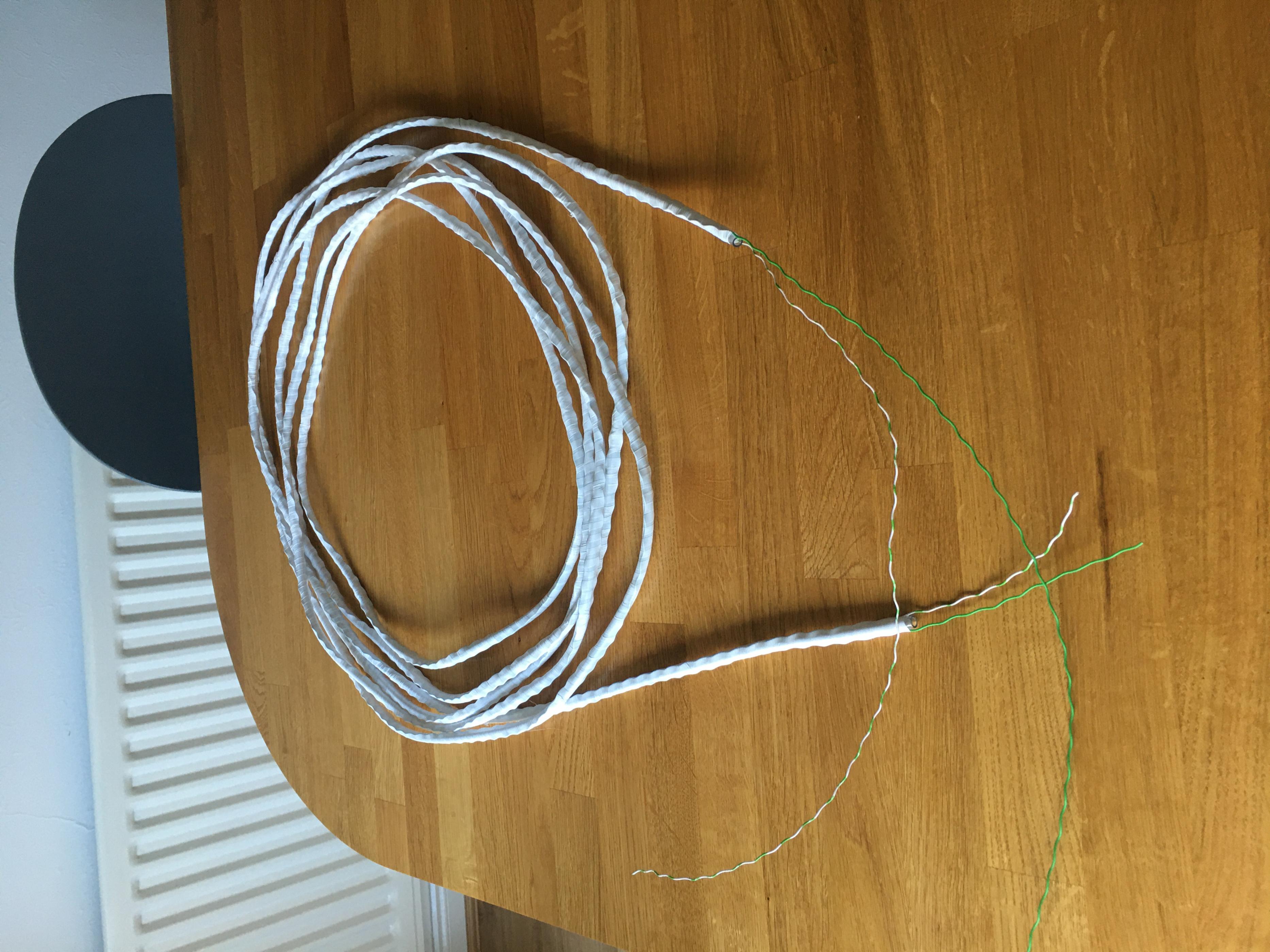

That’s one speaker cable done, very time consuming winding the conductors evenly around the central tube
Now this has me confused!
Just connected up an old speaker to measure impedance, the speaker direct to multi meter measures 3.6 ohms, I then measured the same speaker via approx 2metres of old Chord co speaker cable I have laying around & same 3.6 ohms, I then measured via my new thin, 23gauge QED cat6 cable expecting the impedance to drop but it rose to 4.8ohms?
Did you measure the two cables alone? Thin cable should have more resistance than thick. Dave and Scott did mention as much.
Yeah, I measured the new cable, each conductor, end to end, measured 1.2ohms, the old Chord cable measured 0.6 ohms but made no difference when measured as a circuit via the speaker?
Just connected up my A11MS with the new cat6 cables, sure enough, the impedance has risen from 7.6 ohms with the old 1.5mm VanDamme cables, to 8.8ohms with the new cat6.
I am guessing this is because, the speaker cable resistance is no different to adding another driver in series, where the resistance adds together?
