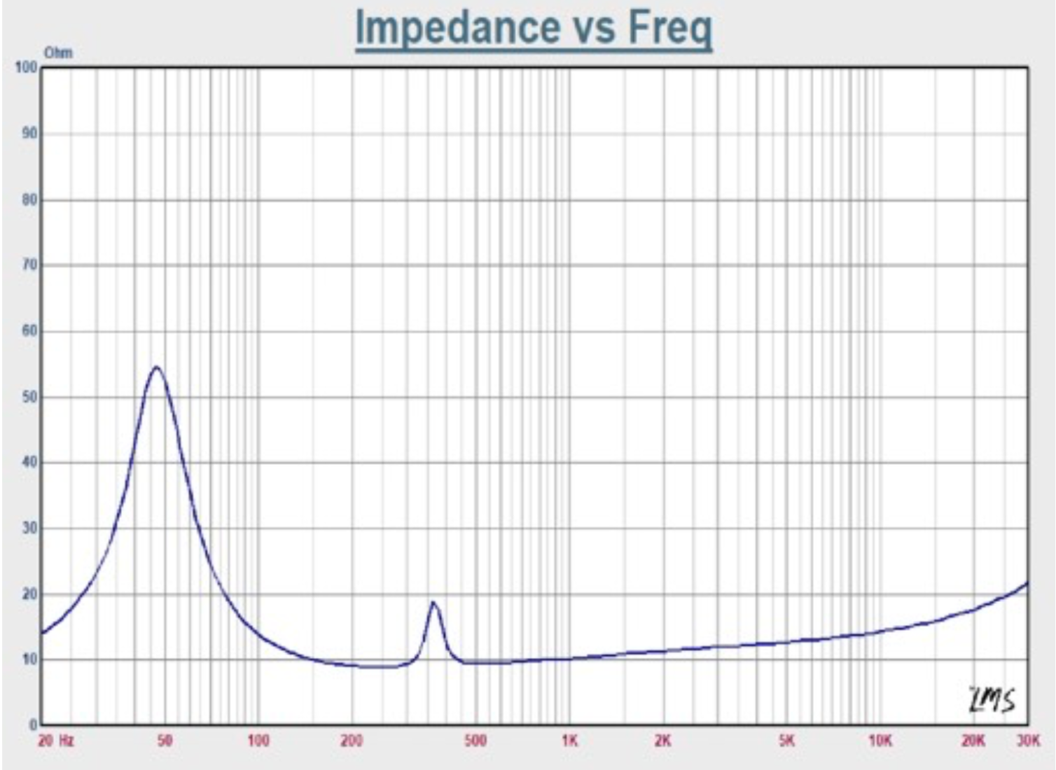

Hi all, what speaker cable do you guys recommend using with MarkAudio?
I have just switched out my MacMini for a dedicated music server, Innuos Zenmini & the improvement in sound quality has prompted me to investigate other areas of my system to see if I can make further improvements, I’m currently using VanDamme 1.5mm speaker cable.
Given that situation, you have a lot more latitude.
When Scott talks about EQ he is talking about the effect of high impedance speaker wire on FR.
In this case, even thou 6m is quite long (you want both wires to be the same length), that they are being used above 250 Hz, well above the drivers bass resonance that bump is not an issue. The slight rise at the top likely will not have any effect given the (strongly suspected) low output impedance of the Lyndorf. The dip near the XO corresponds closely with the measured dip at the same frequency, this could act to lift it a bit… it might mess a bit with your XO, active or passive.

What kind of box are teh A11ms in? They may contribute their own impedance issues.

If you're only running above 250Hz, then there is less in the way of significant impedance swings or current demands, so as Dave says, this removes the major potential issue (which can sometimes be beneficial in itself with low Q drivers run on the end of low output impedance amplifiers, assuming this is factored into the alignment) & may be worth trying -especially as it's cheap.
Possibly / potentially, but it depends on circumstance (as in specific driver, particularly its motor design & midrange - HF impedance + FR characteristics, along with those of the amplifier) so no fixed answer to that. I have some data filed away but currently laid up in bed & dragging myself to my office PC isn't high on my priority list today if you'll forgive me. Since many people have or can access offcuts of CAT5 or its gauge equivalent, the cost is pennies and a few minutes of time to play with, so on the whole, one of life's less harmful activities.
