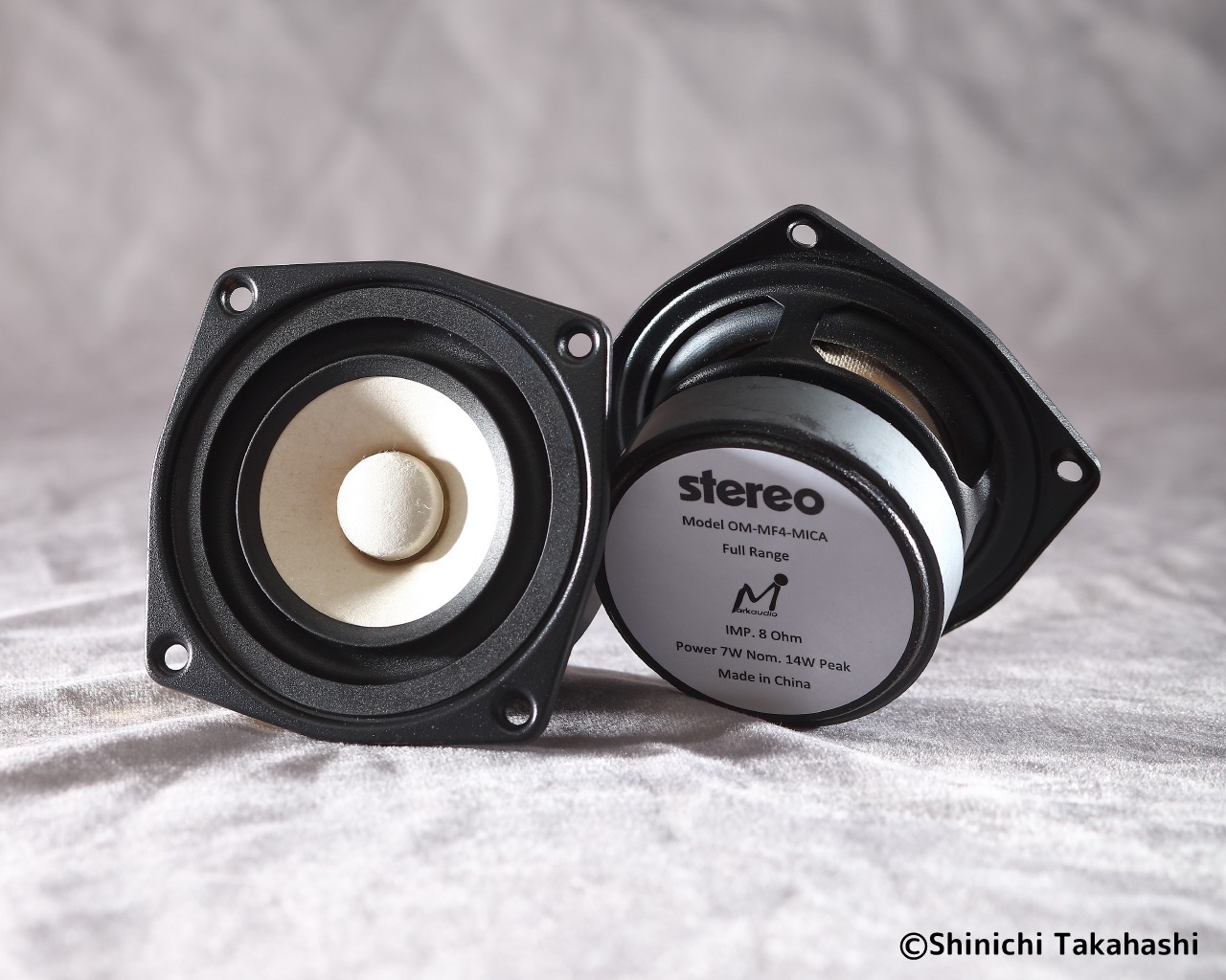

OK, so these are OM-MF4-MICA.
As I said before, if a CHN-40P existed it would be similar (probably externally identical) to this driver, but that doesn't make it exactly the same thing.
(Note that this isn't a quality judgement in any direction. Is it better than an international retail CHN-40P would be? Worse? Just voiced differently? I don't know! Nobody does, because there isn't a CHN-40P available to compare it with)

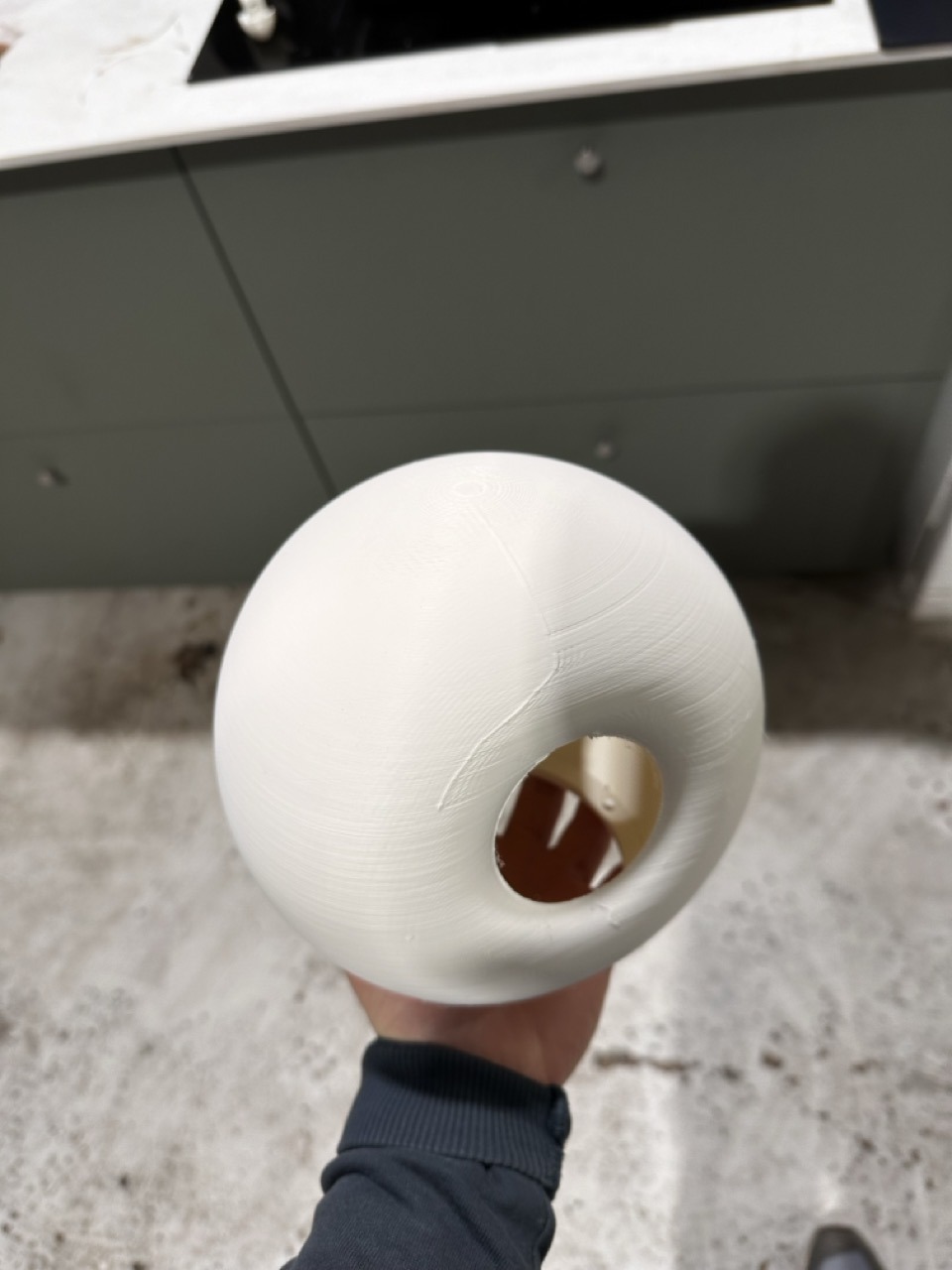

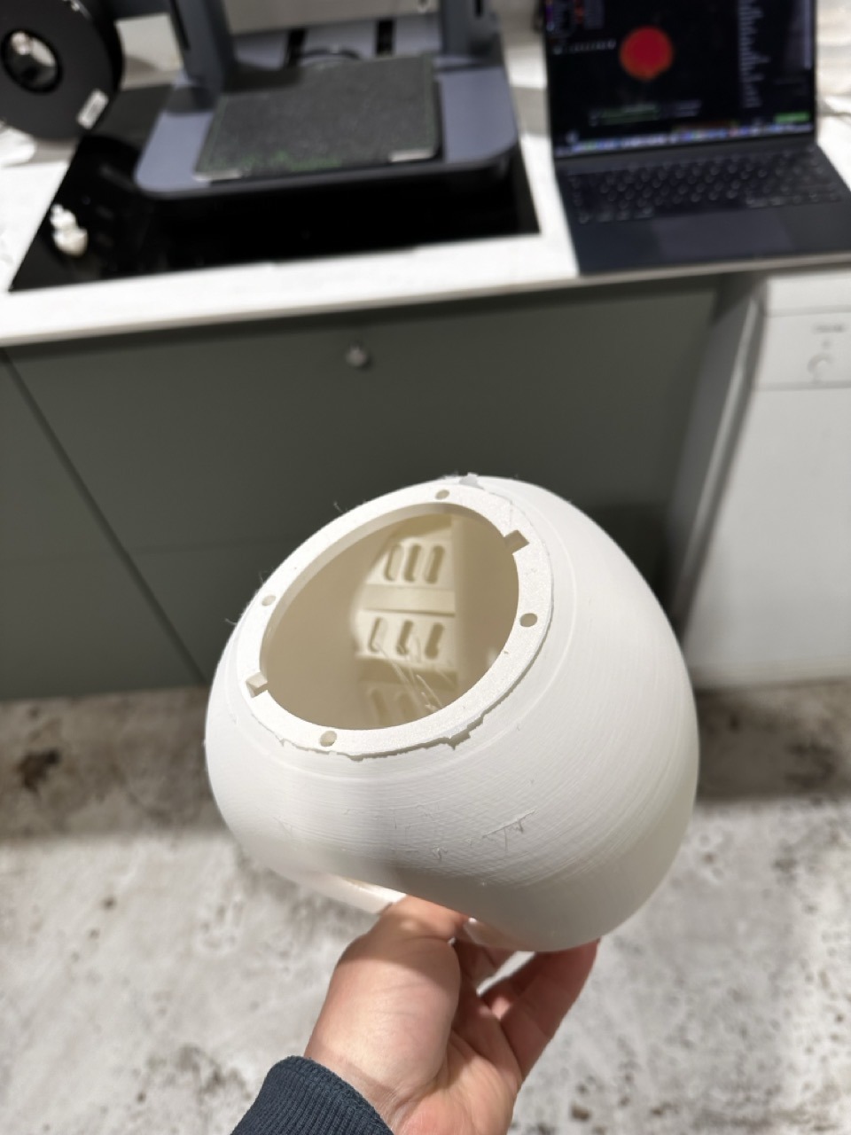

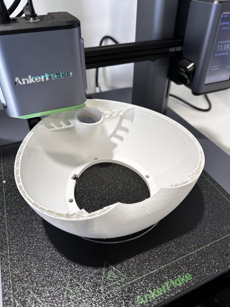

17hrs later, its complete. Not sure if the general print quality can be improved or if it just needs a bit of polishing and sanding.
