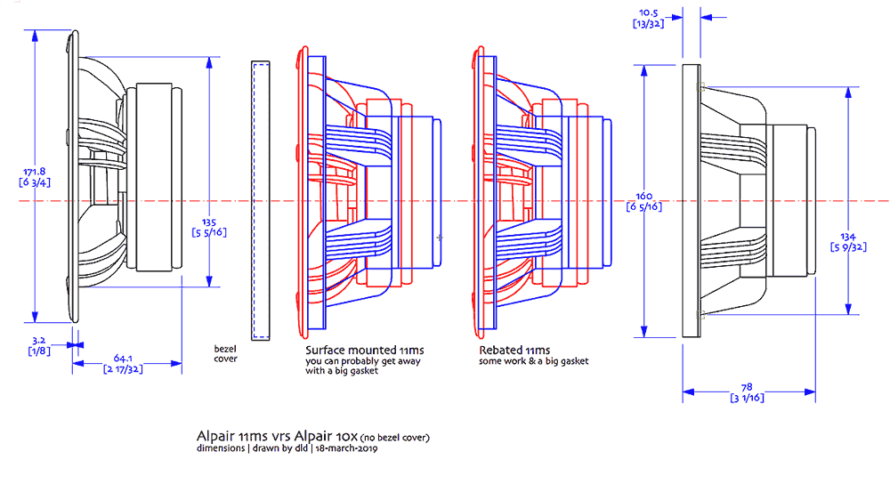

The A10 cutout (134mm) is essentially the same as the Alpair11ms (135mm). This means fitting A11ms into boxes like the FHXL that host either driver.
Reflex boxes will be an issue since the combo of Q & Vas means these want to be in a small box. ie Optimum A11ms miniOnken is 9 litre (ie same as A7.3/FF125wk/most CHx), A10.3 is 13 litre, A10p/A10.2/A12p is 17 litre.
Thank you
Another thing the A10 vrs A11ms baskets shows us is how much the MS reduced the depth of the driver.
dave
Are you sure ? When I looked at this - they are incompatible as much as I wished otherwise. The cut out for the 11ms driver would obliterate the screw holes for the A10.3 - even rotating the drivers doesn't get you far because they have different number of mounting screws - so you can't make a cut out for both in the same box. Maybe you can change from A10.3 to 11ms but then you can't go back the other way so it's a one way ticket? You may have more up to date information as I was comparing the A10.3 with the Pluvia 11, I think. Now I'm not sure which data I used.
