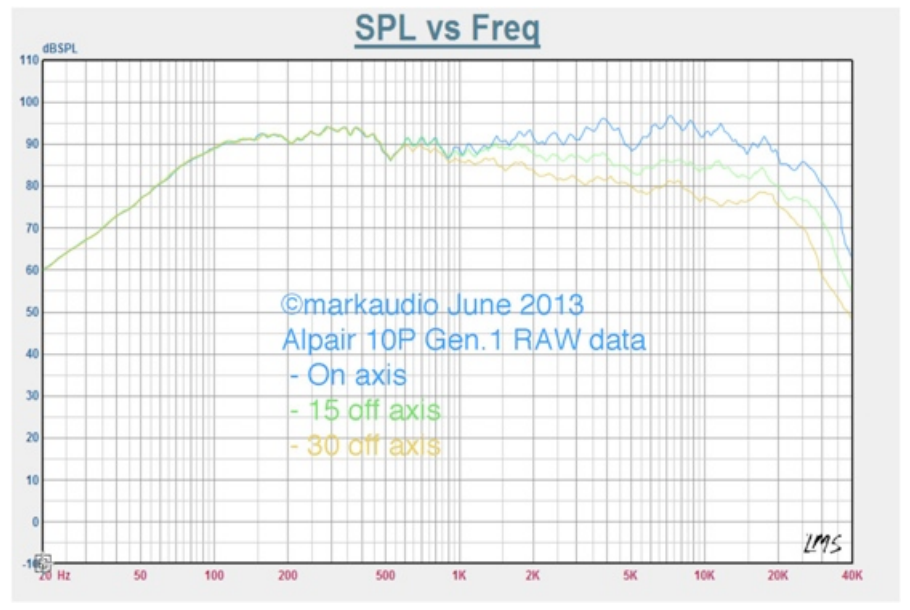

the FR graphs are still key, in combination with the impedance plot. Whilst a driver with a good FR may not be guaranteed to sound great I’ve found amongst drivers I’ve heard with poor FR that they often have issues. For my ears, ragged treble is a worry and although it brings for some that detailed sound, I grow tired of it over time unless it abates quickly as you move off axis. The 11ms has a troubling on axis FR but hard to say if it’s a problem for sensitive eats as I’ve seen no off axis data for it. The 10.3 has a rising treble response compared with the 10p and folk who prefer one over the other often cite the treble as the reason for it. Some like the 10.3 over the 10p, but the 10p is smoother to many folk and it out sells the 10.3 from what I’ve read.

Does "vintage" = flat or falling response above 8 - 10K?
Attached is the published FR for the 10p. It looks rather well behaved. I would NOT describe the FR as a vintage driver. It may sound a little tame compared with the elevated treble of the 10.3, especially off-axis, but by itself it looks like a thoroughly modern FR driver. The off-axis data looks well behaved too. I can see why it's so popular.
Bigun’s evaluation is probably correct. Besides the A10.3, many utiways have an elevated top.
What the FR does not tell us is that the A10p also has the kind of characteristic paper cone colourations/character one associates with the vintage driver si have hears.

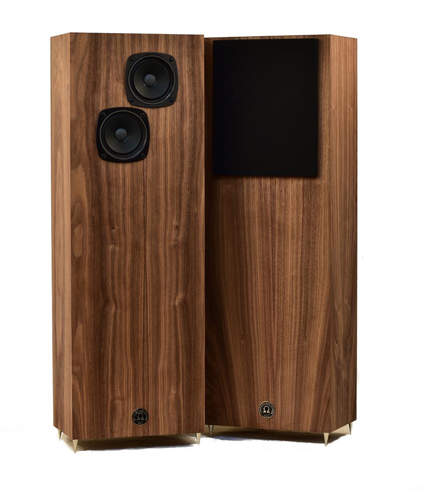

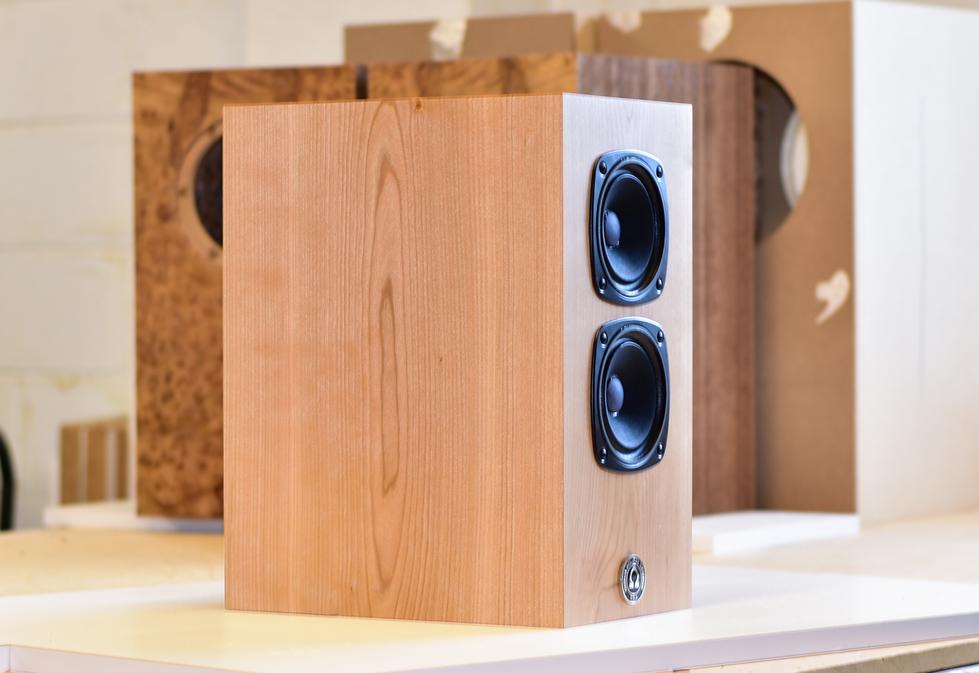

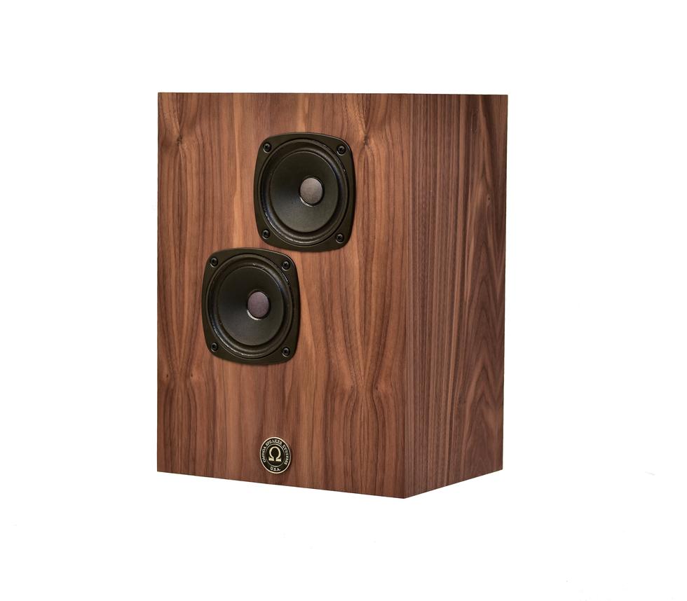

And here some examples of omega audio.
Omega uses a lowpass on the lower driver in the monitors. I would like to use both drivers full range. 2 times the ms11 gives the same demension of a 8/8,5" driver. And the same moving mass as many 8/8,5" woofers.
