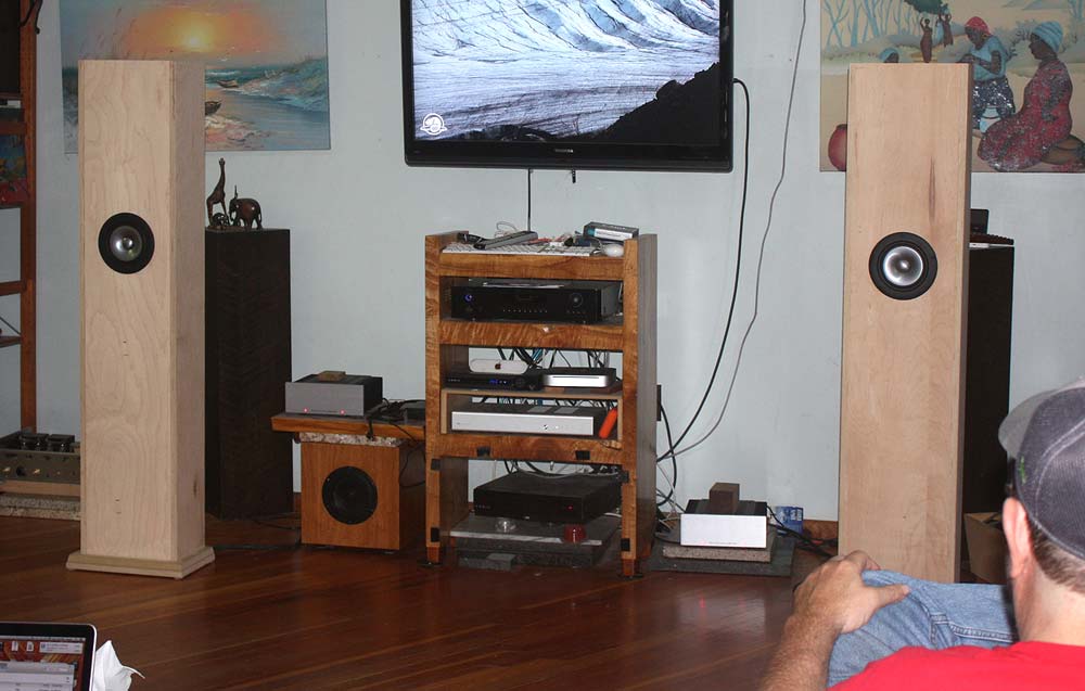

First of all a big thank you to @orangeart for posting some nice videos on YouTube with Mark Fenlon and the wonderful speaker design ideas of dr. Scott!
One question I had after viewing the one about the designing of the Alpair 11 MS: at some point it is mentioned that the 11 is good for larger sized spaces whereas the 7 MS is more suited for smaller rooms; what sizes of rooms would be considered "big" or "small" corresponding to the various driver sizes? And is the bigger driver in a small room in some way detrimental or a worse idea than utilizing the 7?
While the larger driver's higher acoustic efficiency is ideally required with larger rooms and/or lower power sources, it's more a function of listening distance, i.e. the closer one sits [LP], the wider the speaker's polar response ideally needs to be whereas with a longer distance more directivity is required to keep first reflections > 500- 1 kHz [depending on who you ask] to the side/behind the [LP].
In the case of needing a narrower than normal 'sweet spot', a larger driver is the better choice in any size room, ditto where the speaker, LP are near/at opposite walls.
Ideally then, one would spend a little time drawing the room's floor plan to scale with major reflective surfaces, speaker, LP positions [normally should always be at odd harmonics] to see what polar angle works best overall for keeping > 500- 1 kHz off the walls, floor, ceiling or at least where damping is required.

Funny thing is, I took over my present apt. from a guy who works in architecture, so he had the whole place drawn up in Sketchup. Whilst moving in the first thing I did was map in some loudspeakers, off course!
The room is pretty small ('tis the part of Yurp with some of the worst property prices on the planet, after all!), the Frugel Horns pictured are done to scale. Ceiling height is only 2.40 m and the ground plan is 4 x 6-ish. The room has therefore some pretty neat ratio's, approaching 1.414 - but reflections are an issue. There's carpet, curtains, books on the walls and double doors opening into a bedroom, als well as a relatively large sofa now, so it's by no means a lively room in terms of acoustics.
The CHR-70's I have now fill the room nicely at my listening levels - again, nothing too loud, this is an inner city place and I like to thinkg of myself as a good neighbor.
In theory frugel horns with the 7 MS should work nicely, but I have this nagging feeling that IF I'm going to build my be-all-end-all, I should just go with the grand daddy of the driver range.
Maybe I should just shut my trap and build those damn Frugels already, they're the only really design icons of the DIY loudspeaker world anyway 😉
