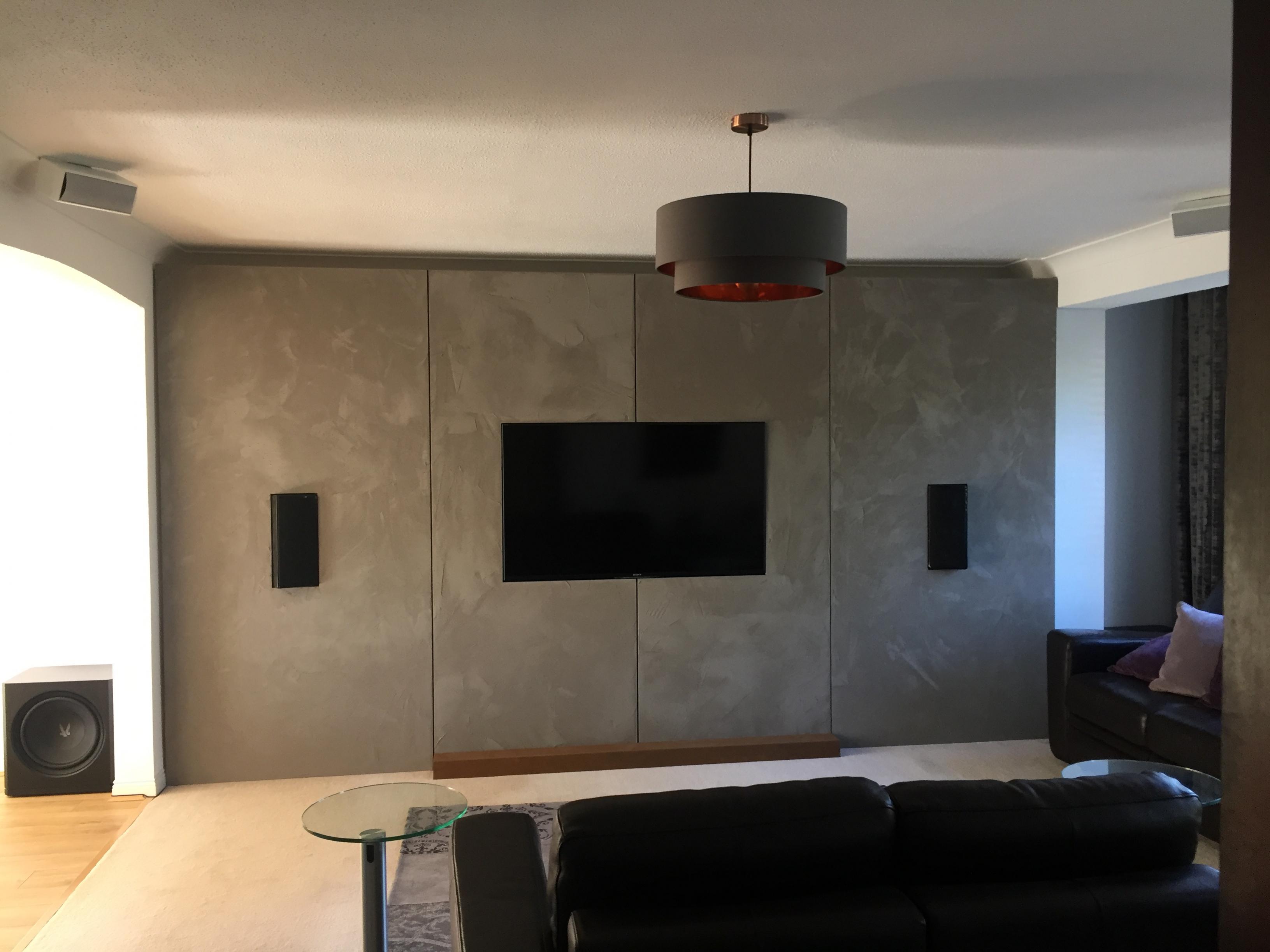

My A11MS have been sitting in their boxes for a few weeks now while I’ve been making my bass system, I’ll be getting onto the cabinets for them very soon & as they will only be used from approx 300hz upwards, I was wondering if it’s worth trying them in an open backed cabinet ?
Their cabinets will protrude from a partition which is stuffed with approx 30cm of rockwool, thus would probably absorb the backwave quite efficiently.

Thanks Scott, I’ll take advantage of your experience & straight for the sealed cabinet.

........will only be used from approx 300hz upwards, I was wondering if it’s worth trying them in an open backed cabinet ?

Hi GM, thank you for your comments, unfortunately, if I understood what you’re saying, I probably wouldn’t need to be asking you guys questions 🙂
Are you suggesting that even crossing the A11MS at 300hz, they’re not going to provide much SPL ? I’ll be crossing over actively with choices of 2nd, 4th, 8th order slopes in BW or LR flavour 🙂

Greets!
You're welcome?
I've no clue how you could get this out of what I posted. 😕 The goal here is to protect the driver at higher power, which will be required to get decent output for HT apps and/or wide dynamic range [HIFI] recordings.
I'm a believer in acoustic solutions for acoustic problems as much as practical, hence the high Qt alignment suggestions Vs lower ones combined with > 2nd order XOs in the critical telephone BW where we ideally don't want any XO influence [250-2500 Hz decade].
This will 'push' the XO point somewhat above 300 Hz and may require 'gapping' [offsetting] the actual XO point of each for flattest in-room response since it's down in the room modes BW.
'Easy' way would be a 'textbook' 2nd order sealed [0.707 Qtc] plus 2nd order XO at its F6 point for an acoustic 4th order.

Hi GM,
Apologies for being rather dumb, I’m a complete novice.
Yeah, I’m going to run them sealed 0.707.
Thankfully, the amp I’m using (Lyngdorf TDAI2170) has excellent room correction built in & does a fantastic job of blending satellites with subwoofers, it has the ability to run two different speaker configurations so I can choose different xo’s & switch between them to compare.
All good fun & I’m looking forward to hearing what these drivers can do.
