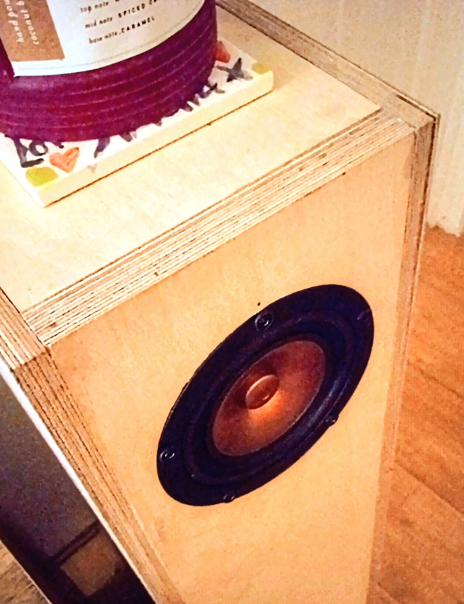

Here is my quick and a bit dirty well braced MAOP7 Pensil prototype. All precision cut 12mm ply, screwed together, with doubled 24mm walls at the base, and behind the driver with magnet brace, 18mm baffle. The original idea was to skin in 6mm Bamboo, for an external wall of 18mm-30mm +/-.
This design allows for easy flush routing of the port slot, and is very quick to build with no power tools needed.
They are nearly ready to install the drivers.

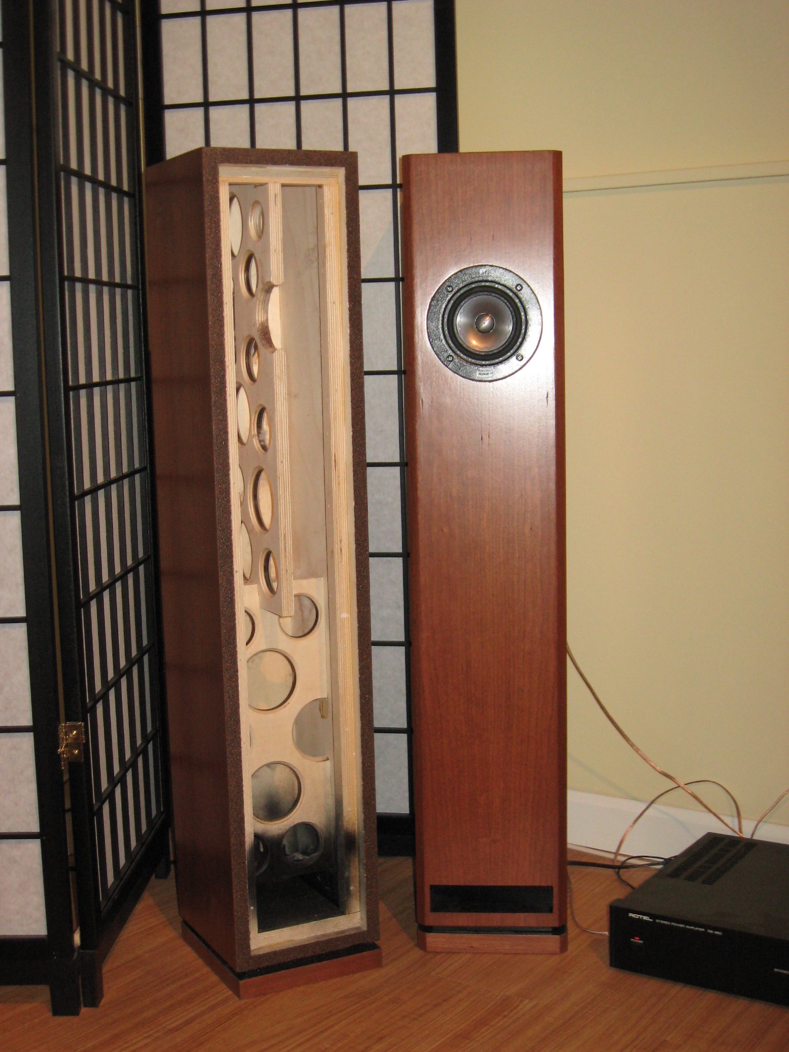

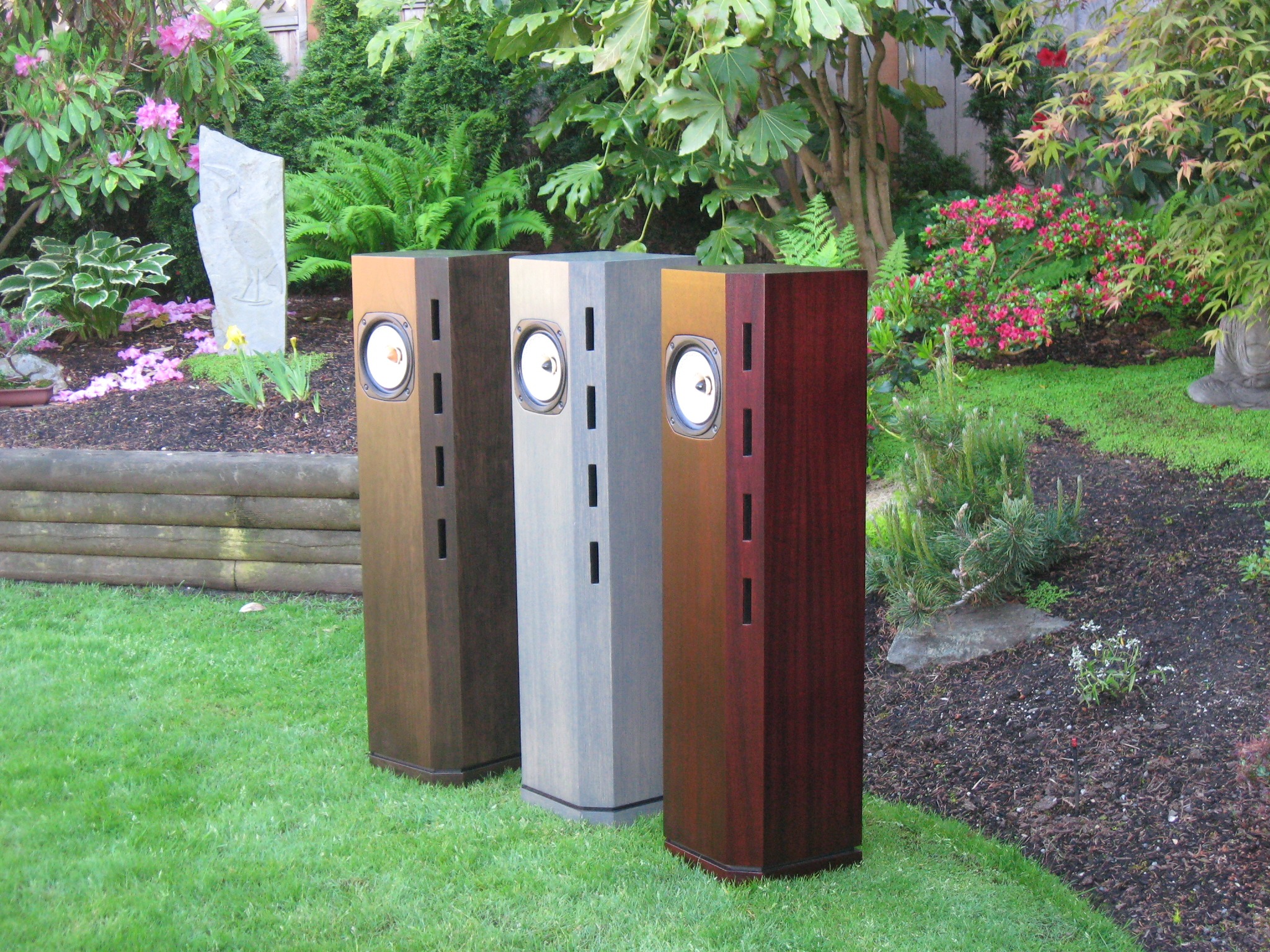

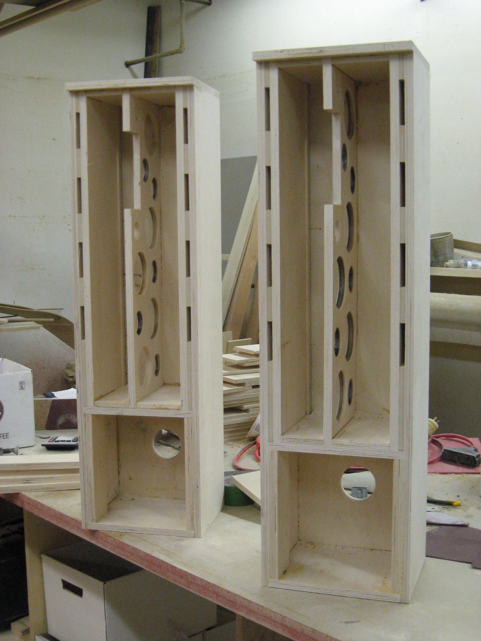

For reference, this represents the general Planet10 bracing scheme used in most of the scores of enclosures ”we” built. Pensil with A7.3
Single layer of 15mm BB, with rear panel screwed to perimeter cleating and off centre vertical brace coupling front to back for approx 60%(?) of line length, with interlocking lower brace side to side.
edit: note no obstructing horizontal shelf / window pane bracing, and IIRC the CSA was increased slightly to compensate for the material thickness of the vertical members.
I was always more of a fan of floorstanders than ”bookshelf” / stand mounts, so on occasion had to seal off the bottom portion to retain an optimal acoustic centre height of driver, such as with the FE167E.
It was just an experiment, they were nested onto another projects cut list, as it was 12mm I thought the holey bracing would brace and be fairly transparent inside the cabinet and was more worried about panel resonance I hadn't really considered the quarter wave loading would be interrupted. I'll throw in my 7.3's soon and see how it sounds. I haven't yet cut the port slot. Would it be better to leave it sealed/port elsewhere and negate that loading?
There is always more ply and I can always make another set...
Not really, it will still act as a BR, though all things considered, might want to experiment with a second vent as close as practical to the driver (block the lower one) to see if you like one over the other as it will change both the amount of reflex loading and wide range response IME, ditto in sims unless heavily damped of course. 😉
Personally I would be removing it for design spec. Not a big job. Then listen you may be pleasantly surprised. If too much resonance just clad the outside. Out of harm's way.It was just an experiment, they were nested onto another projects cut list, as it was 12mm I thought the holey bracing would brace and be fairly transparent inside the cabinet and was more worried about panel resonance I hadn't really considered the quarter wave loading would be interrupted. I'll throw in my 7.3's soon and see how it sounds. I haven't yet cut the port slot. Would it be better to leave it sealed/port elsewhere and negate that loading?
