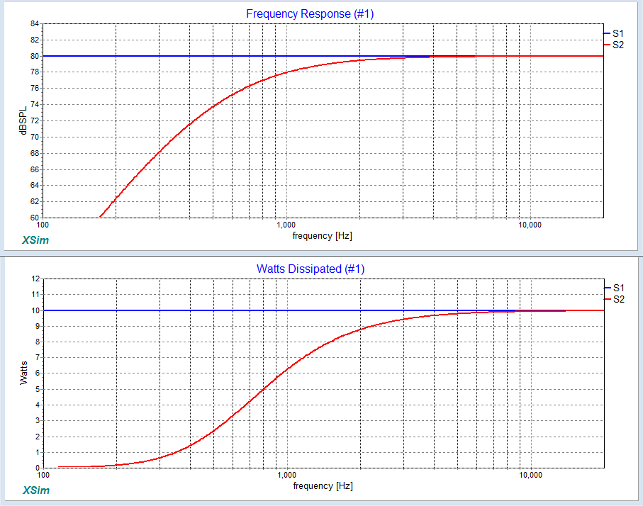

This is not excursion but I just happened to have Xsim fired up and this should be relevant enough. You can see from the theoretical power dissipation (of the driver) that if anything in the lower hundreds of Hertz and below that previously would have overdriven it would now have to be many times higher (in volume setting) to do so.

A very high XO, well above the nominal half-energy point of ~300Hz, the A7ms will essentially think it is a tweeter. It should be able to play louder with less strain.

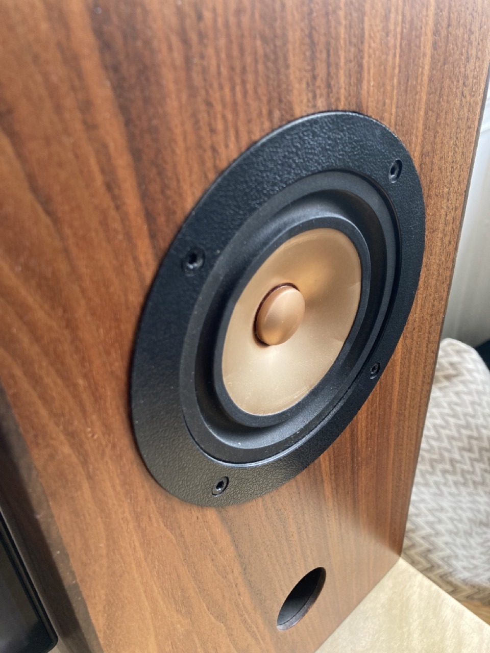

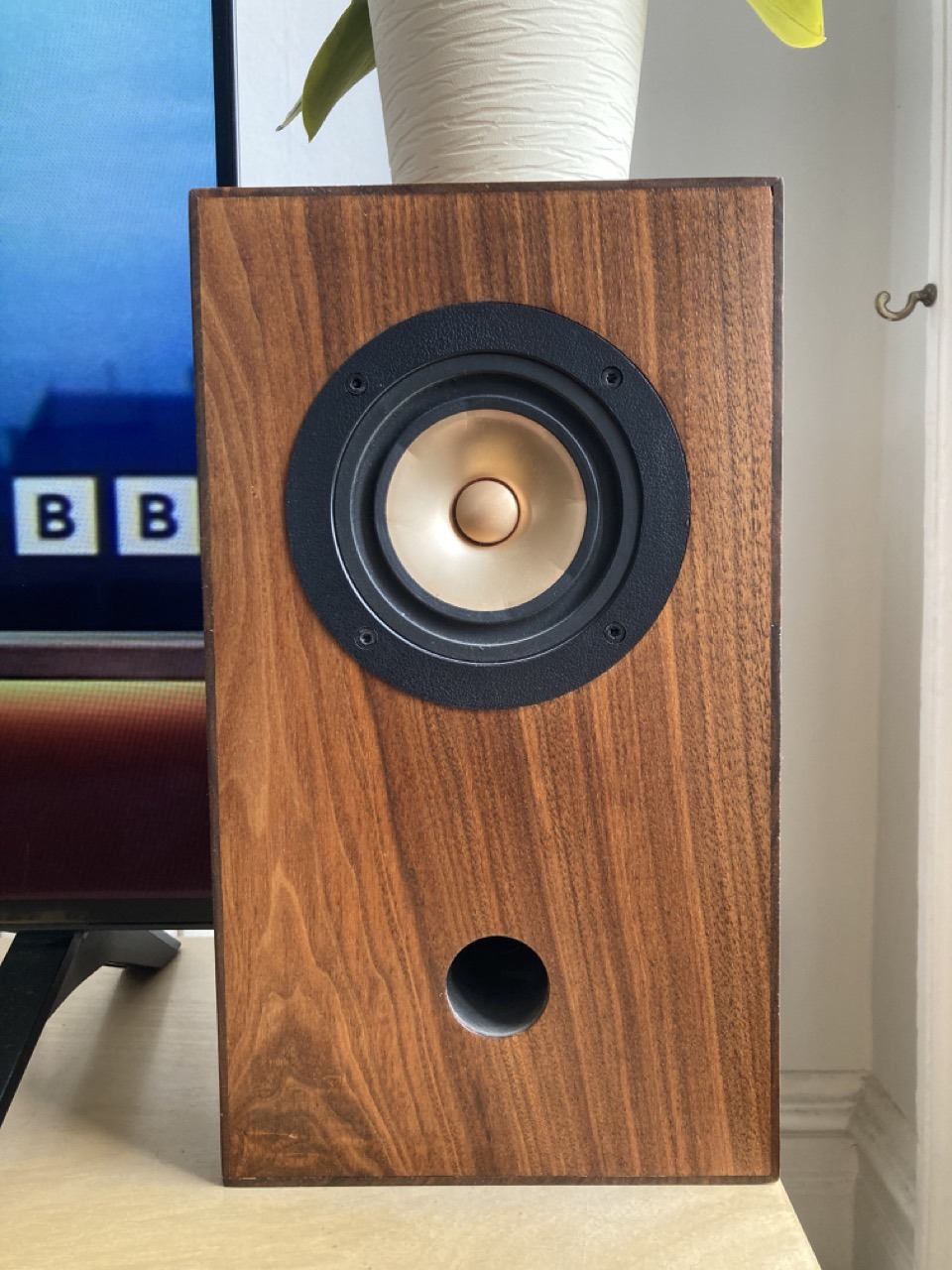

Sorry to hear about your accident with the drivers - do you have any images of the crumpled cones? How do the speakers sound now?
They are running true full range, but they are never played very loud. I use the NAD's XO to cut below 60Hz for movies and Apple TV has a really nice 'reduce loud sounds' setting as the dynamic swings in some modern movies is huge.
For reference the NAD amp can run in % or DB, in percentage its never higher that 45% for tv/movies and 30% for music from Roon server. I think I will get the NC252 though as 250w (125 into 8) I'm sure would be sufficient, and the 500w modules can power a subwoofer.
They still sound fine, it only went crazy loud for a split second before I could turn off the amp. Someone clever could probably tell me the Hz that caused the star crumpling around the edge.
I have a new boxed replacement set of Alpair 7.3's to replace at somepoint soon.
