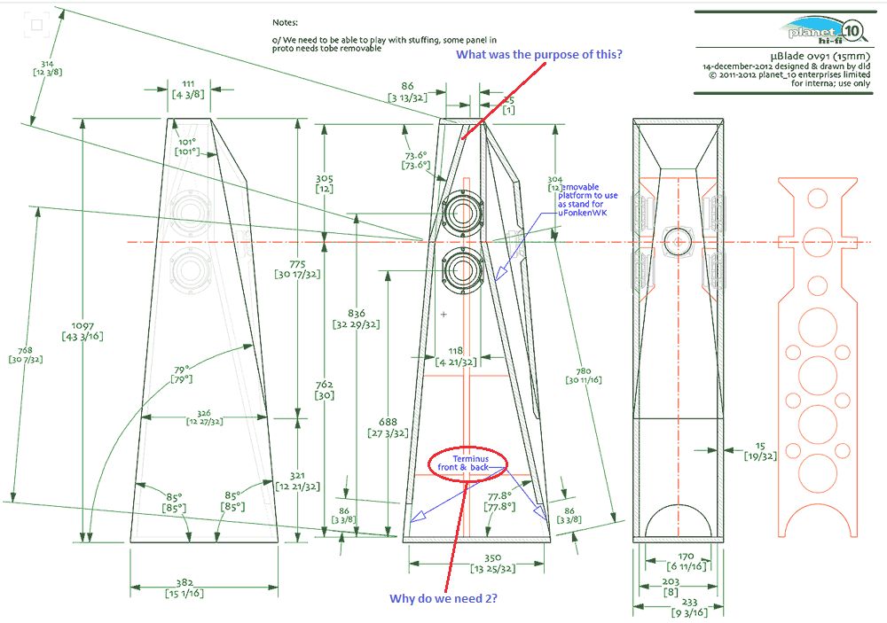

We choose the 830870 because we had found it suitable for the woofT that goes with the µSize trapezoid. But yes, in retrispect the W14 we like would also fit into about the same volume.
What you suggest is a brace is the back wall. The line had to be “twisted” to accomodate the front line.
2 vents are often used instead of one. Using 2 in this case was a cosmetic decision.

Noting the date on the drawing, that was almost 10yrs ago😵
have you got a photo of the rear view to depict the upper portion of the back wall of mid-bass section?
also, the dual terminus made for convenient hand holds on an otherwise rather awkward enclosure - did you ever get a weight on them once the sold cladding was applied?
They are currently in Nanaimo. But as Chris suggests, the top back is inset at the top sort of like you see on the back of some Wilson’s. There are 2 sets of binding posts there.
It is the first pic with the veneer, and Bernie’s setting is quite nice. :^)

Good designs never go out of style. Some of my favourite speakers (AR 2ax, Ohm Walsh 2, Magneplanar SMG, Klipsch Forte II, Snell Type C, ...) were designed 40-50 years ago.Noting the date on the drawing, that was almost 10yrs ago😵
Bernie delivered them back yesterday. And sent me a bunch more pics.
