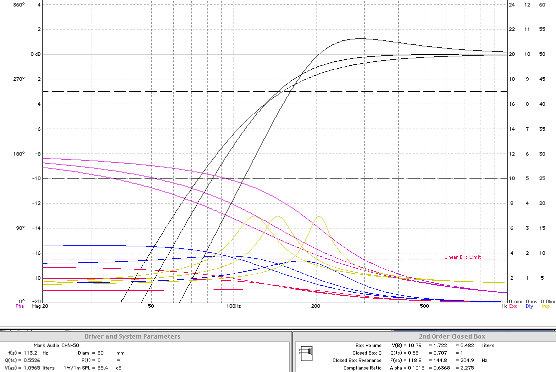

I've just plugged back in my little sealed boxed CHN-50's and I hate them. I've eq'd the bass up and they still sound dreadful, super thin and fall apart at any modest volume, in a new house and I don't remember disliking them. Does anyone have a box design they like them in?
From memory they are in sealed cabs 12mm ply, wrapped in 12mm Valchromat so ultra stiff & dead cabinets, 12mm chamfered edges, test boxes so no lagging as suggested, dimensions based on Scotts compact sealed standmount design. New amp too so they are being driven by a NAD C298, Purifi based design.
Just thought I'd ask if anyone has a design they prefer that would get a little more out of them, I was hoping to use them as near field desktop speakers hence the small sealed boxes, but I'm not sure I can live with them as is...
Sealed CHN-50 is a midTweeter.
If you want to get bottom, try Girrafe or Frugel-Horn Lite.
A 3” driver wil really struggle to play loud withut bass support and a high pass filter — your sealed box has a second order low pass, looks like about 130 Hz (F3 only the crosove scares) and doesn’t make even 80 Hz F10 (max flat/Q[0.707)
dave
As Dave says, you're not going to get any LF out of that enclosure (assuming it's basically the little sealed box I did). Assuming a conservative 1/2ohm series R for wire loop & connection resistances, anechoic F6 is roughly 100Hz, as shown in the sketch. It's really meant to be used with a compact sub or by themselves as desktop boxes for basic things like conference calls etc.
I cut the XO on the pre-amp and boosted the bass and it sounds a bit better. But I think I'll shelve them or try and add a sub for a small office system.
