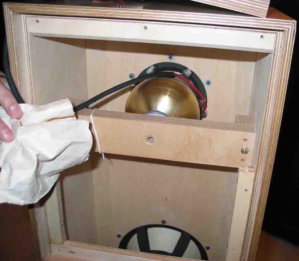

I have another idea about how to connect the driver in the rear with the M8 bolt. How about making the "floor" of the reflex chamber a removable access panel? This would allow access to the inside when mounting the driver, making it possible to use a standard cross-brace right behind the driver that the driver would mount to. The cross-brace could be installed when assembling the cabinet.
The access panel could be attached with screws along all four of its edges. The screws screw into narrow pieces of wood that are glued around the bottom of the compression chamber. Or, small metal brackets could be used instead of narrow boards.
Here’s a picture of the back of a cabinet that shows narrow pieces of wood glued along the sides that the access panel screws onto. In this cabinet, those pieces of wood are only glued partway around the access hole, but they could be glued all the way around the hole in the Maiko cabinets. You can also see the cross-brace that the driver mounts to (but there is no bolt in it in this photo). That’s the back of a gold-plated D5nf driver, by the way. You can also see a Feastrex 9” passive radiator below it. (Sorry the picture is so low-res. I had to lower the resolution to get it small enough to post here.)
This method would eliminate the need for a long threaded M8 rod and the need to make a hole in the back of the cabinet. As long as the access panel is securely fastened, there shouldn’t be any rattling or vibration problems, I think.
Can anyone think of any disadvantages to doing it this way?

Oh, and maybe the narrow boards should be lined with something like felt or rubber on the side that faces the access panel. That would seal the reflex chamber better and could also help prevent any vibration or rattling, etc.

What you really want as an ideal is nothing but very tight, precise wood-to-wood glued joints throughout the enclosure. Having portions of the enclosure held in place by screws is considered bad construction practice as the structural integrity of the enclosure is greatly reduced wherever screws are used as the sole means of holding a piece in place. Obviously the driver itself needs to be held by screws, and there obviously has to be a hole for the driver, but ideally that's the only part of the speaker where things would be held together by screws. Another possible exception might be around the binding posts, but that "window" would in the nature of the case be quite small.
I'm pretty sure that what you propose doesn't make a lot of difference since it is just moving the opening from one face to another.

That Feastrex picture is cool, Mike. I see he has double layer plywood construction. Neat!
Rich, it does look like two sheets of plywood, but it's actually a single sheet with a rabbet cut for the access panel. Rabbet cuts in plywood sometimes create the illusion that there are two sheets instead of one.
