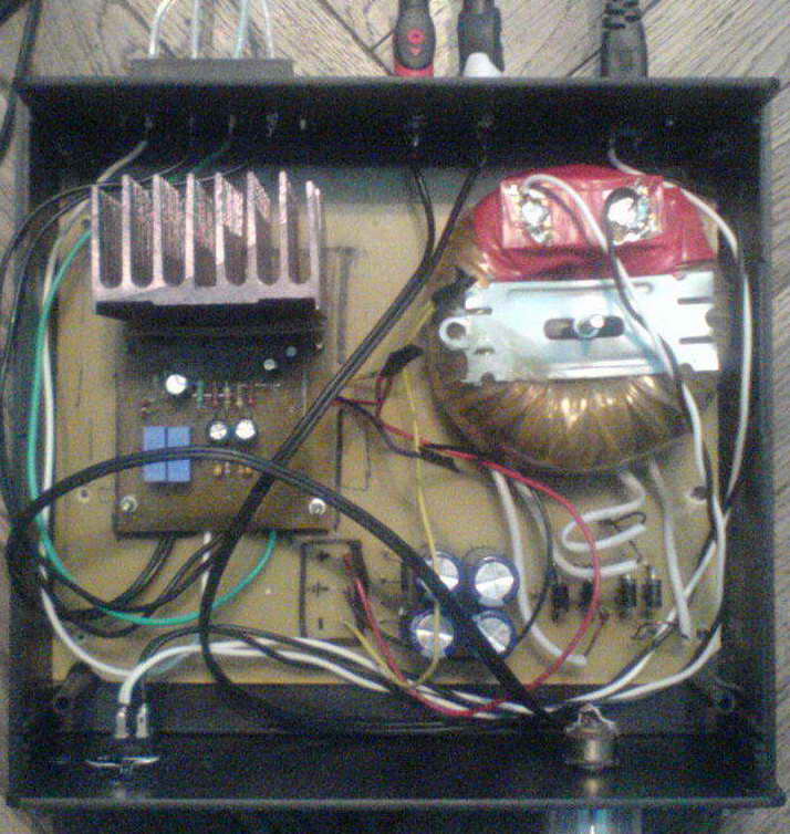

454Casull said:Got a question about the casework. I notice that the piece you've bolted to the chip will likely be a chassis panel in the future. How best to drill the holes so that everything fits? I mean, to get the spacing between the chip hole and the standoff holes correct.
I haven't put together a case yet. The piece of aluminum is just a scrap that I had in my basement. I marked the holes with a marker and drilled them. I used a larger little larger drill bit than necessary, and bolted it through. For a normal heatsink, I typically would measure much more carefully, and then center punch the hole, drill it and tap it.

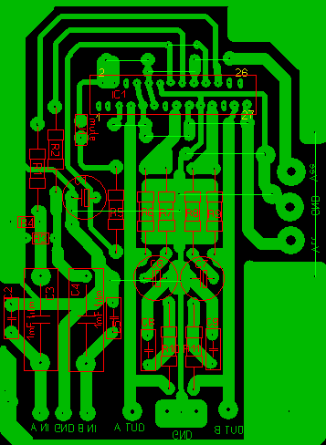

The only issue that I found with the boards is that it is a bit tough to secure the chip to the heatsink on the left side. It is possible to do it, but there is room for improvement when I get around to get another batch of boards made. To make it a lot easier, one could not install the last decoupling capacitors until after the boards are mounted to the heat sink.
As for the boards, I had some extras made if anyone wants to be a beta tester for this new design. I can offer the boards for $9 each by themselves, or put together a kit with all parts needed to stuff the boards. Based on the feedback, I will revise the layout, and mail all that beta tested the board and provided feedback a board from the first production run. Drop me an e-mail if you are interested.
I will provide a BOM with the boards.

As for LM4780 vs LM3886, according to National Semiconductor, the LM4780 is simply 2 LM3886 cores put into a single package. The only difference in the two packages is that the LM4780 doesn't have quite quite the heat dissipation abilities of the combined heat dissipation of two uninsulated LM3886 chips. Though, it still should be more than a pair of insulated chips.
As for the LM4780 board design, if you are bi-amping, it should be a great solution for that. There is a line on the bottom of the board for jumpering the input together, which would work great for a parallel amp, or a bi-amp setup, with both channels of one board running off the same signal.

Hi Brian! I'm going to betatest your two boards..
a couple of open points:
I suppose C3,C4,C5,C6 are 100uF, C1, C2, C7, C8 are 100nF
but what about R1, R2, R3, R4 and R7, R8, R9?
My guesses for now:
R11 and R10 are 2.7ohm, 2w
R5 and R6 are 22kohm, 1/2w
which are now the 10k and 1k ones? and the 680ohm?
and finally what is R9??
I also noticed no zobel so no couple of 47uF + 0.1uF cap, right? ok for me..

Tent, I don't think going higher than 10k will do anything too much for an amplifier with this current demands. Don't waste money on bigger caps.
Let's see .. C7 and C8 are the Zobel network caps, right ? That'll be 100nF ?
C9-12 are basically whatever high value you can fit in those positions, as mentioned above, going too high might prove of little benefit.
C3-6 are 100ish uF bypass caps.
C1-2 are 100nF bypass caps.
R12-13 are capacitor discharge resistors. They should be a large value, if you put 1ohm there, you'll literally vaporise them or just blow the fuses.
If you look at the schematics & guide from chipamp.com, you can see more or less all the values for the components, just identify them in the new layout.
No, there isn't a snubber on the PSU.
That's more or less it.

Thanks a lot Atilla,
a pitty there is no snubber in the PSU.. anyway.. I got most of them now.. still some doubt on the resistors tough.. so those R12-13 are the ones usually I see on chipamp.com's PSU rated at 2.2kohm 2W+? I'll try to guess the other resistors now.. like R9..
What about that other board, the red mono 3886? Are those C8-11 all 1500uF also in your opinion? Any better value possible?

On the red board, you can probably fit larger than 1500UF per position, depending on the voltage you'll be using. Just measure the diameter and find caps that are suitable. 6x2500uF should be quite allright, but you can probably fit bigger ones - check. it's a balance of capacitance, quality and price.
For R12-13 you can use the exact same resistors, yes. You can use larger values as well, but the discharge time will be longer. Shouldn't be a big issue.
I'd say don't go wild on the caps, but getting good quality 100uF caps and polyprops for the supply bypassing shouldn't cost you too much.
The caps in the input are for blocking DC and they're not present in this design. You should make sure that the source doesn't have high DC offset or you might run into trouble.
