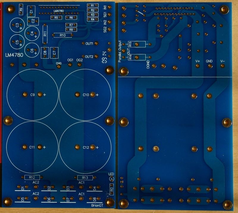

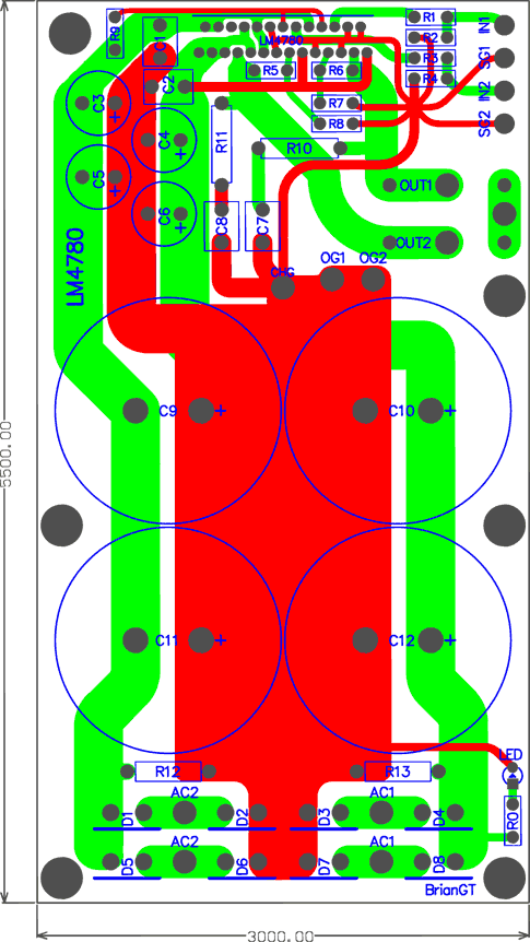

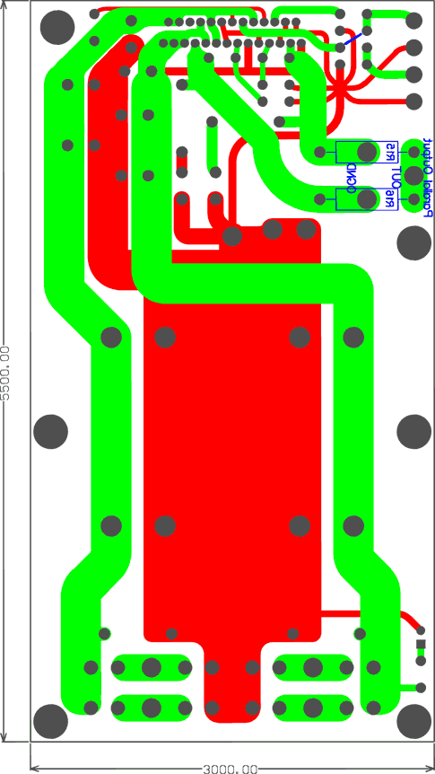

I haven't built up a LM4780 amp for a while, so I decided to make a new layout.
Goals for layout:
- single LM4780 + PSU on a single board
- able to be used in stereo or parallel
- reasonably compact: 3" x 5.5"
- decently robust power supply
- attempt at decent separation of grounds, allowing for a star ground for the inputs, going back to the main ground, a separate ground return for the output zobel networks and also the output grounds tied back close to the main ground.
What do you guys think?

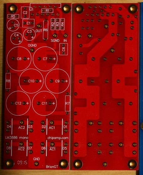

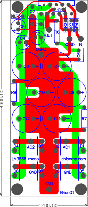

Here is a similar layout that I made for the LM3886, which I haven't finished fully yet.
The idea here is to have a narrow board, so that you can easily pop 2 aside each other for a dual mono amp and avoid having to wire up the power supply board to the amp board. (or to the same effect a 5 channel amp).
-Brian

BrianGT said:
My only major concern is leaving enough clearance to attach the chip to the heatsink. I believe that with the large caps pushed back, an angled screwdriver should be able to screw the board into the heatsink.
Brian
On my amplifiers I placed the screws behind the heatsink and the nut + washer on the chip or transistors, so this might be an option.
Ted205 said:
would be a shame to have the psu connected as the only option. 🙂
I actually modified the design to add pads to the V+ and V- traces, in order to run it by itself, putting a cut line on the bottom of the PCB to cut the top 2" off to form just an amp board. I will post pics for this later, as I am away from that computer now.
Brian
