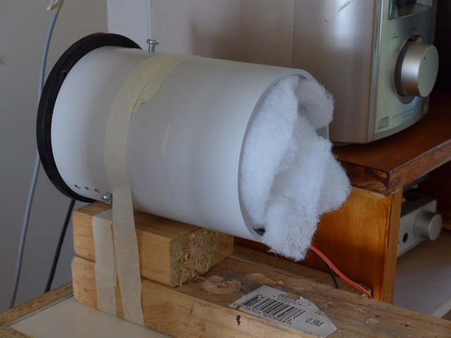

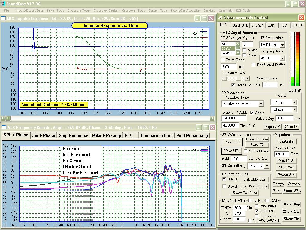

LXMini Driver tests
I did some tests on the MarkAudio driver, CHR-70III operating as LXMini
OB. It seems to work quite well considering it costs about $35 each and
with 86dB sensitivity. All tests were taken with NO equalization.
Enclosed here are 5 tests(gated at 4mS), each tests is named as follows:

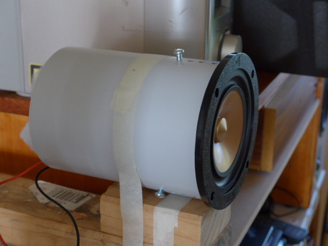

Boxed, driver mounted in a sealed box

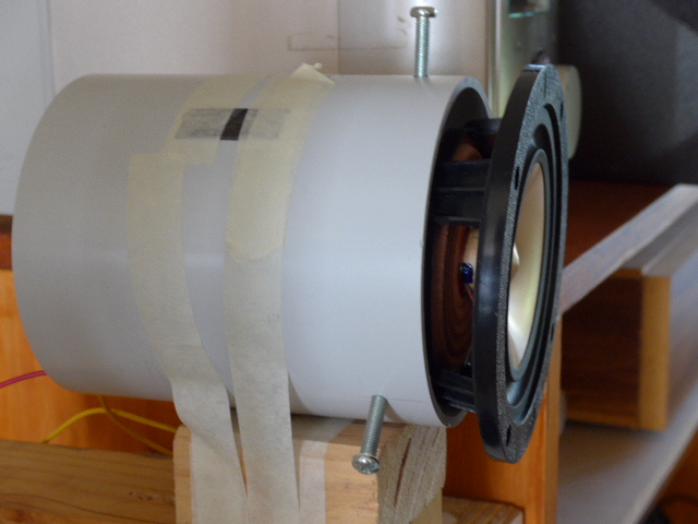

Flushed mount, as shown on image
SL mount, as shown image similar to mount from LXMini
Rear SL mount, rear Freq. resp., driver mount similar to LXMini
Rear Flushed mount, rear Freq. resp., driver is flushed mount.

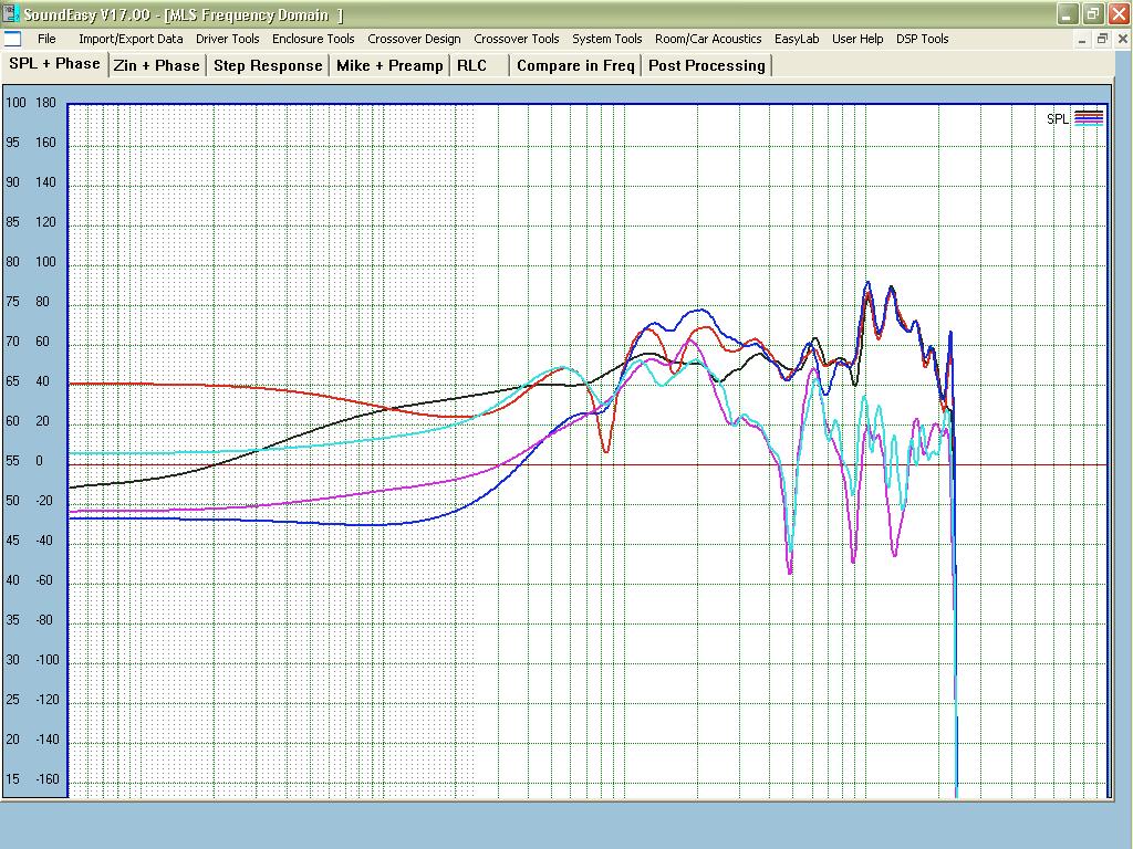

Note that there is a resonance around 6kHz(see rear response), this is
not really caused by the resonance between the tube and driver, this
resonance is a function of the driver, see the kink around the same
frequency around the the same freq., 6kHz when driver is boxed.

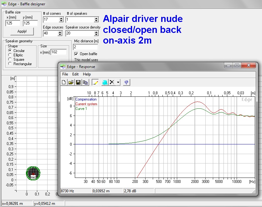

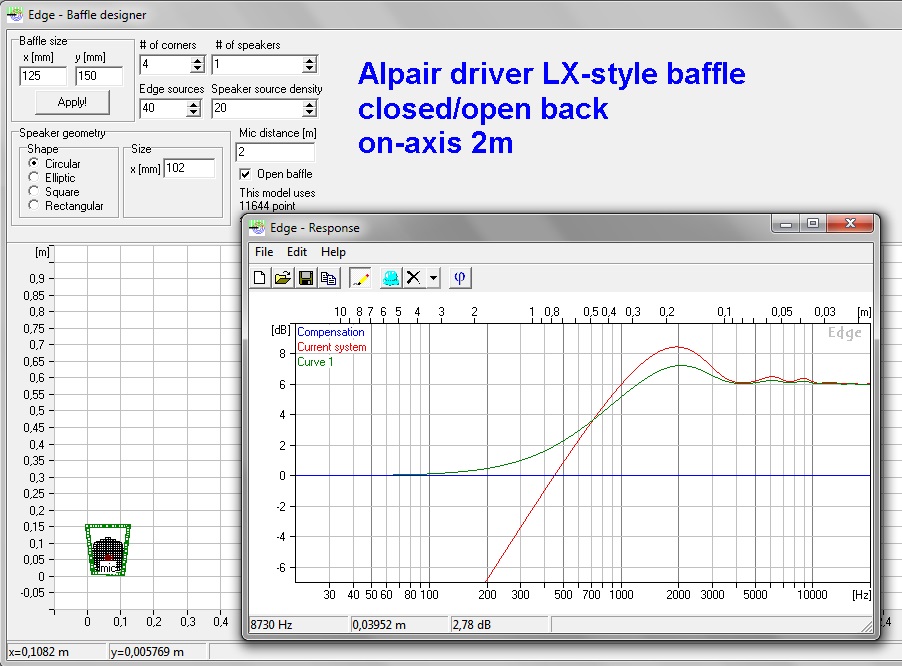

This Alpair flange (baffle for dipole) is 5" (125mm) radiating membrane is 4" (102mm)
Here is a Edge sim of it open and closed back. We can see what round "baffle does to treble response. For comparison the datasheet response in large flat and angular baffle sort of LX521 style
