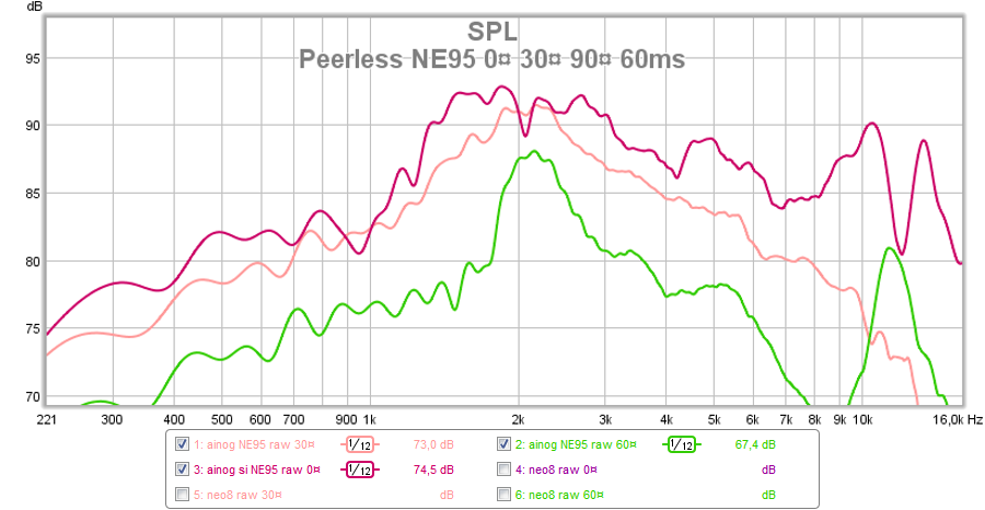

I've done actual measurements on "nude" drivers (unbaffled that is) and they look more like this:
The plot above is the predicted response for the case that the circular baffle radius (b) and the radius of the driver's cone (a) is the same. For a nude driver that is essentially the case, or perhaps b = 1.1*a which is very close to the model, so it's not all the surprising. If you go to SL's web page where these plots are located, you can see the effect of increasing the (circular) baffle radius, b. As b gets larger, dips and peaks develop in the response. This to me is very strong motivation for using a driver unbaffled, at least in a midrange application.
Before I did these measurements, I was very wary of trying to use a driver above the first dipole response peak. But now I realize that things are not always as bad as they seem. The real driver does not display the extreme peak and null on and off axis like the point source model, or even the plot you posted. As a result I know that I can effectively use my driver as high as its off-axis response tracks the on-axis response. In my case, instead of having to cross over below 1kHz I can use the driver up to almost 3kHz! That makes a huge difference in terms of the demands on the driver used above it in frequency (e.g. the "tweeter").
I did similar measurements on a range of drivers close in size to the one that I finally decided to use. For some of them, the response would break up off-axis around the frequency of the first dipole peak, and for others the on and off axis responses were relatively smooth. One problematic driver had a phase plug, so perhaps this is to be avoided - not sure, I only tested one like that.
The bottom line is that you need to take lots of measurements and then decide how to use the drivers, or whether the drivers used can support the application. Modeling can only take you so far, and does not capture things like the resonances behind the cone, reflections off of the magnet structure, etc., etc. Measure, measure, measure.
