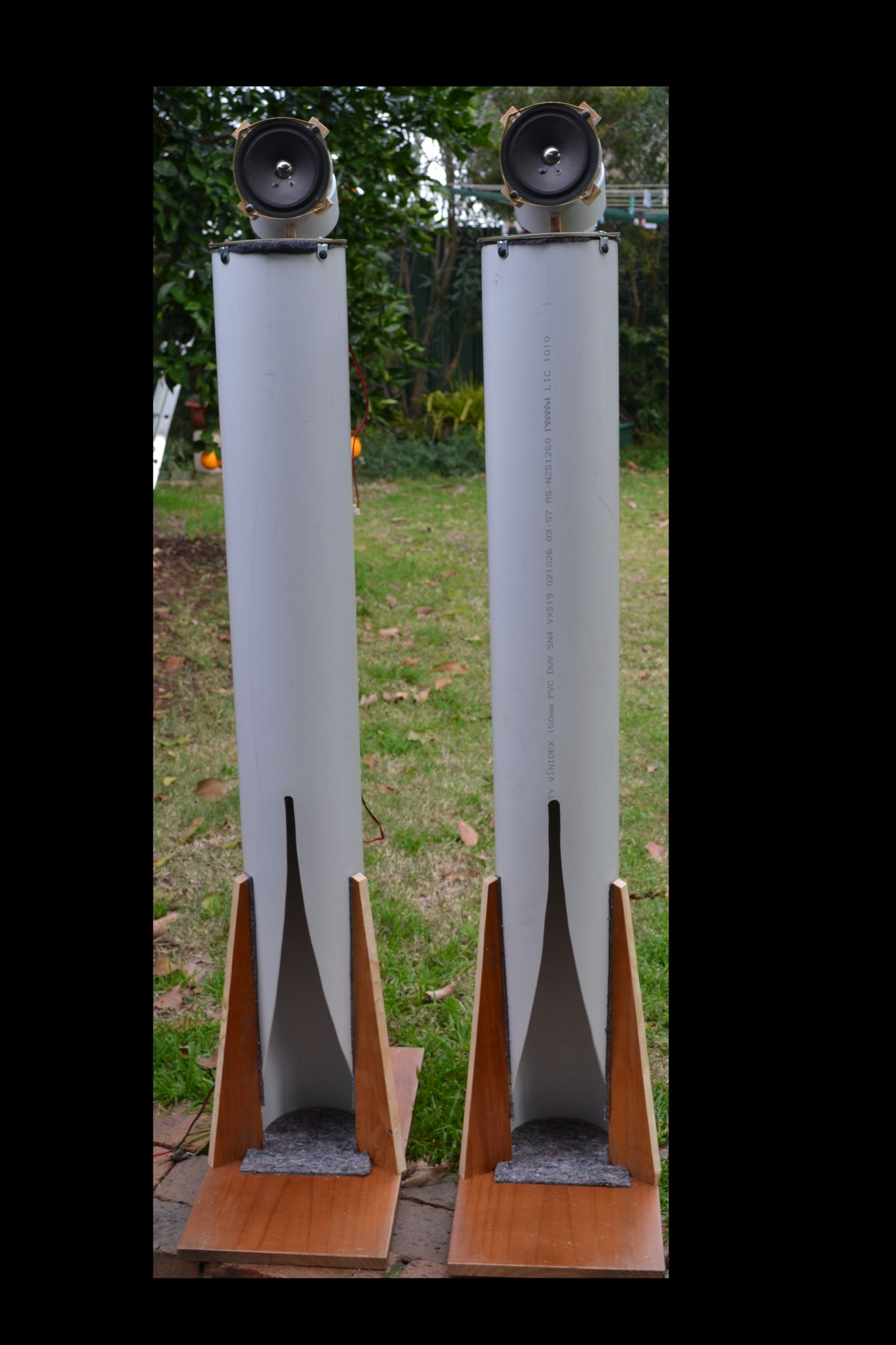

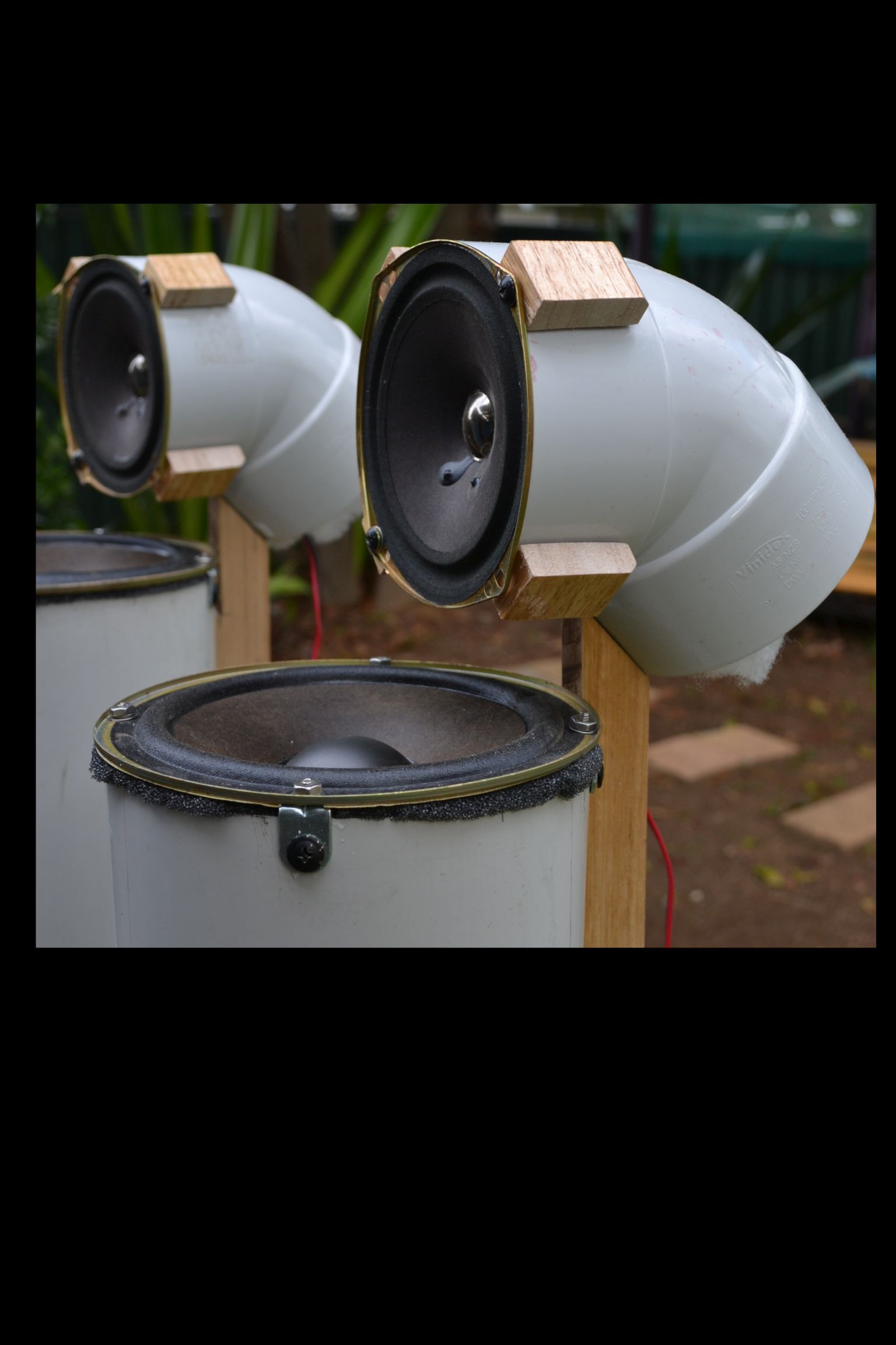

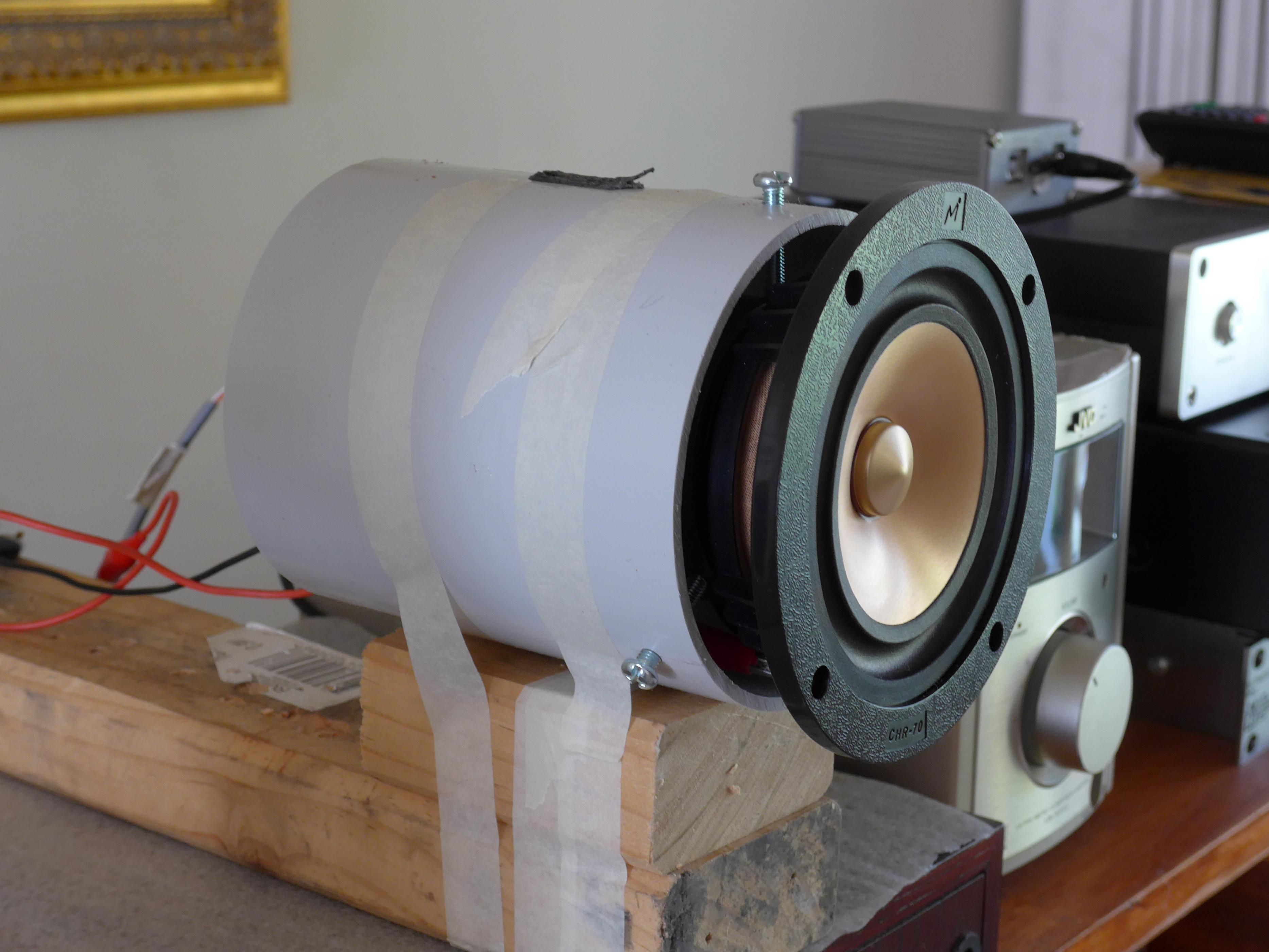

Beta Testing of LXMini "Clone"
I thought some of you maybe interested in my mock up version of the LXMini. More info will follow once I have performed more testing of this setup.
It seems to work with Mark Audio CHR-70 III, the driver I am using, I am testing the top section first. The sound seems promising, very open and large sound stage for such a small speakers. BTW all the info of this speakers comes from Linkwitz's website I didn't buy the construction package.
Cheers.
Cheers.
re: the next step: it would be interesting to know how the omnidirectional bass/lower mid should be sized relative to the full range top. SL seems to have given a smaller driver a lot of boost via miniDsp. maybe a bigger driver on top of a sonotube would have done better? please continue sharing.
So far I set the midrange boost of 5-6dB(similar to SL) low shelf set at 750Hz, I need to do more testing via measurements and listening.

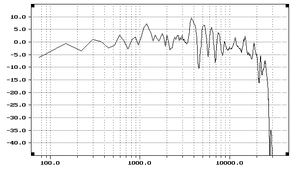

Funny thing about diffraction. I remember examining the circular plate that
Terry Cain used on the Abby loudspeaker. The FE166 driver he was using
has a 4 Khz peak which is a bit of a problem, and with the plate you see a
comb filter situated in the same zone.
Looks awful, but sounds better. I believe Terry achieved this using only
listening tests and experimentation.
Way cool! Terry used to come around to the little DIY shows that Dan Wiggins would throw. RIP 🙁
Circular radiator in circular baffle, concentrically is the worst scenario, above diffraction first null! As a dipole one should never let them go up there! However the ears are not as sensitive to this combing as a measurement mic.

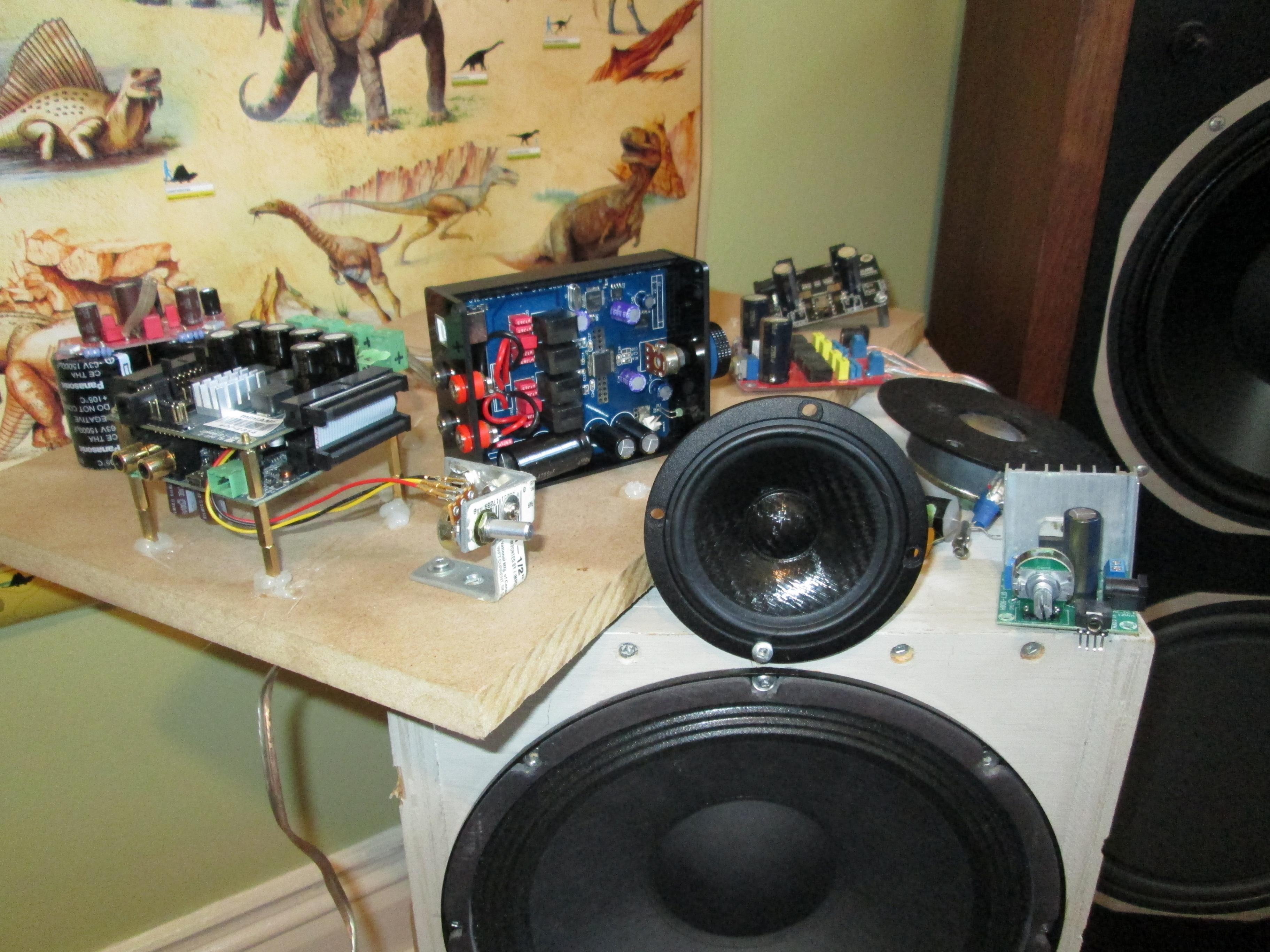

Roadkill version:
I found if you mount the FR driver your way the frequency response will be different if the driver is mounted 2-3 inches away from the circular mount. The sound will be different too.
Hi TTan, how different? The 'roadkill' was just cobbled together with junk I had lying around, the 'omni' woofers from side-of-the-road Akai speakers, the front firing driver a Sanyo "FR" from a boombox. Xover is a 47uf cap, all I had lying around; sound is "revealing" i.e. no bass ... (The Sanyo driver is too efficient, needs to be padded down) hit the loudness switch & wind up the bass controls , not too bad, Horn sections (Louis Jordan ) sound amazing, however Rammstein sounds better on my BR cabs... 'specially after a few lagers....
