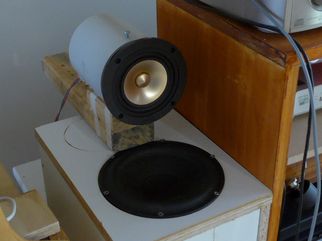

Now I am putting the 2-way together just to listen to them working together. See image, the woofer is sealed,.This project is still a work in progress, very promising, enjoy listening to the combo.
BTW I have built many speakers based on many designs including those excellent designs by JK, J. Clayton(Eminence Physics), 2-way cabinet, etc., the speakers from SL's LXMini, this speakers configuration design sounds quite good.. a worthwhile exercise to proceed to completion.

ttan98: what are you crossing them at? would crossing them lower than SL (at 700Hz?) with a bigger bass driver, change the sound significantly for better or for worse? in other words: does playing 300-700Hz range omnidirectionally do something special for the sound? just asking since you have a chance to experiment. THanks.
I cannot answer all your questions because I don't own the original LXMini,
1. I cross my LXMini Clone around 700Hz, it depends on your full ranger, even then
you have to raise the lower shelf, lift it about 5-7dB, see SL's curves.
2. This is the first time I design an Omnidirectional speakers, it surely sounds
different the sound is more diffuse rather than directional, if you don't own one try
it, it is cheap to build provided you already own measuring equipment, speakers xover
system with equalizer e.g. Minidsp($85), etc.
A worthwhile exercise. Initial testing and hearing the sound, I believe he overall sound quality is determined primarily by the quality of the full ranger and secondary factors are the quality of the rest of your equipment, eg. amplifier, DAC, etc.

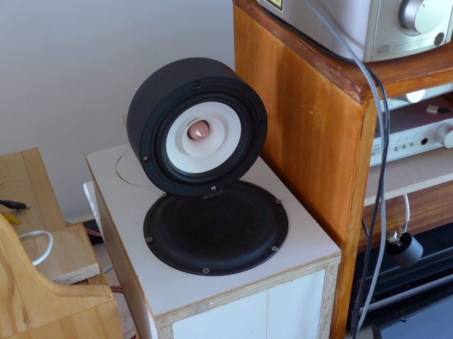

Using a 5in Full Range(FR)
I thought you guys maybe interested in my experiment, I switch to a different FR which is a 5in Chinese FR made from paper. I replace the Mark audio 4in CHR-70, the cone is metal coated.
The system sounds totally differently even though the system is equalised for "fairly" flat response. The rest of the system remains unchanged the only change is the full ranger.
The system sound is determined by the type of FR you use. The sound quality of the system is determined by the type,size, etc of the Full Ranger used.

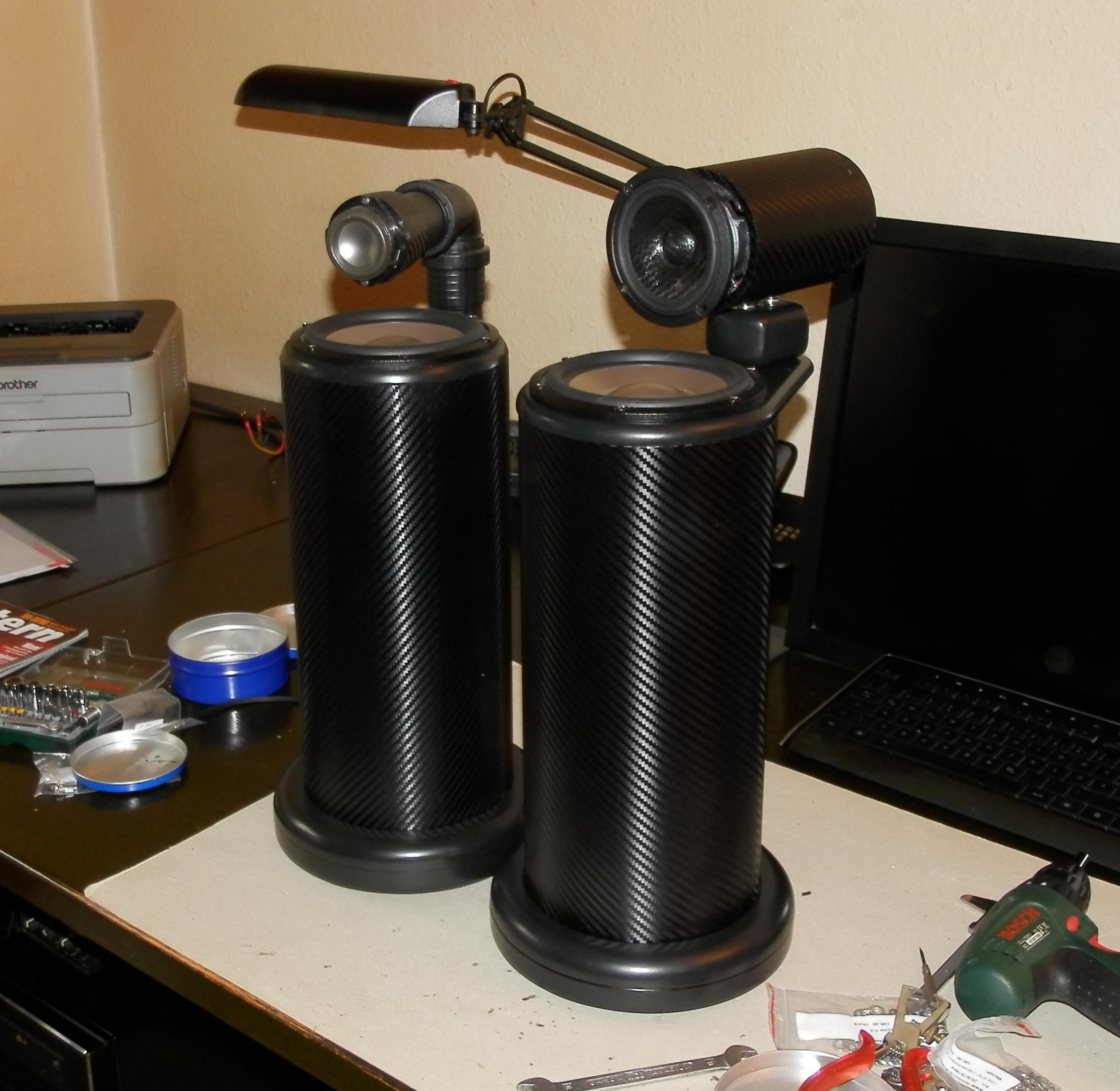

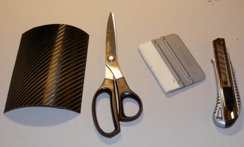

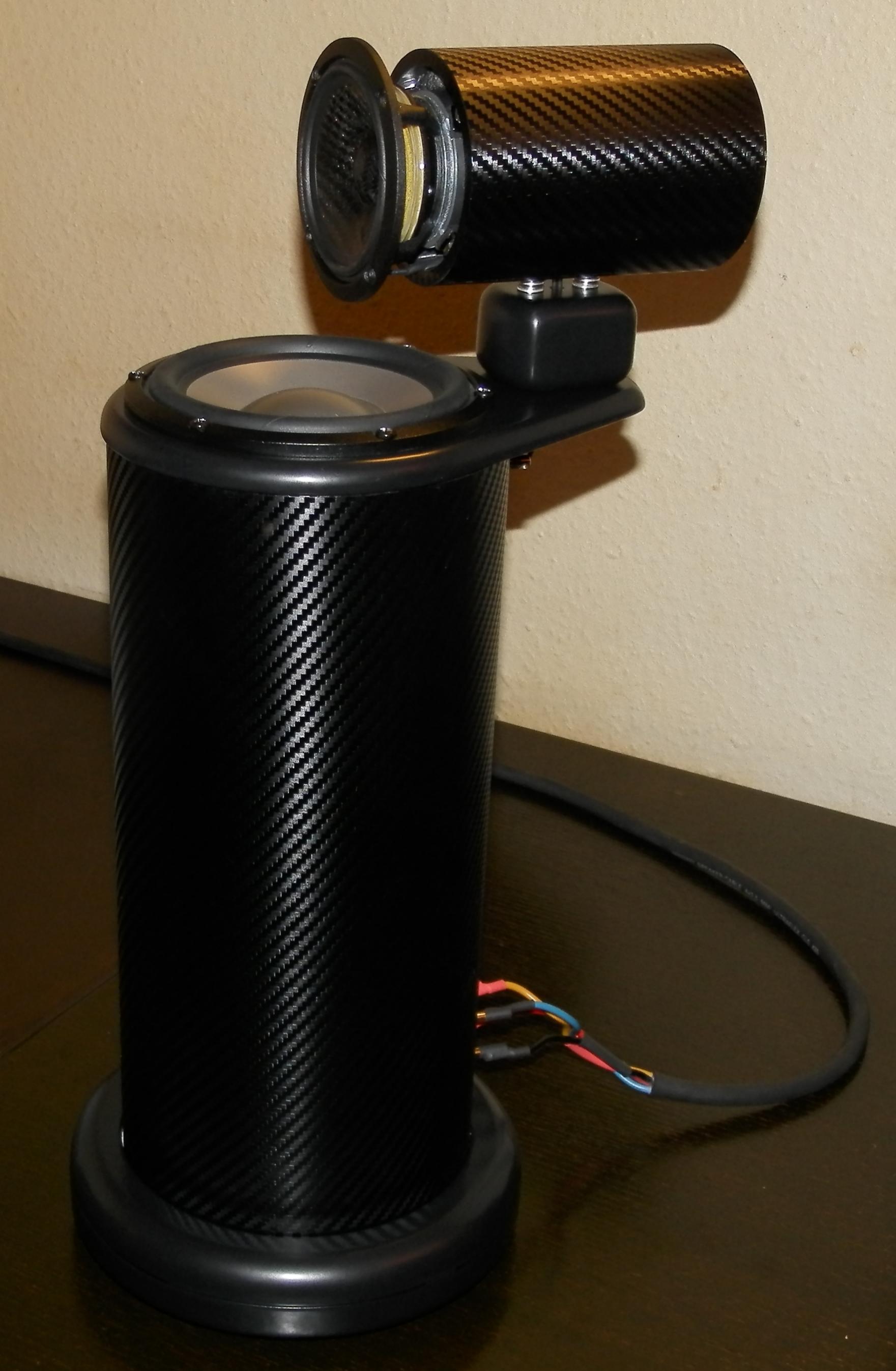

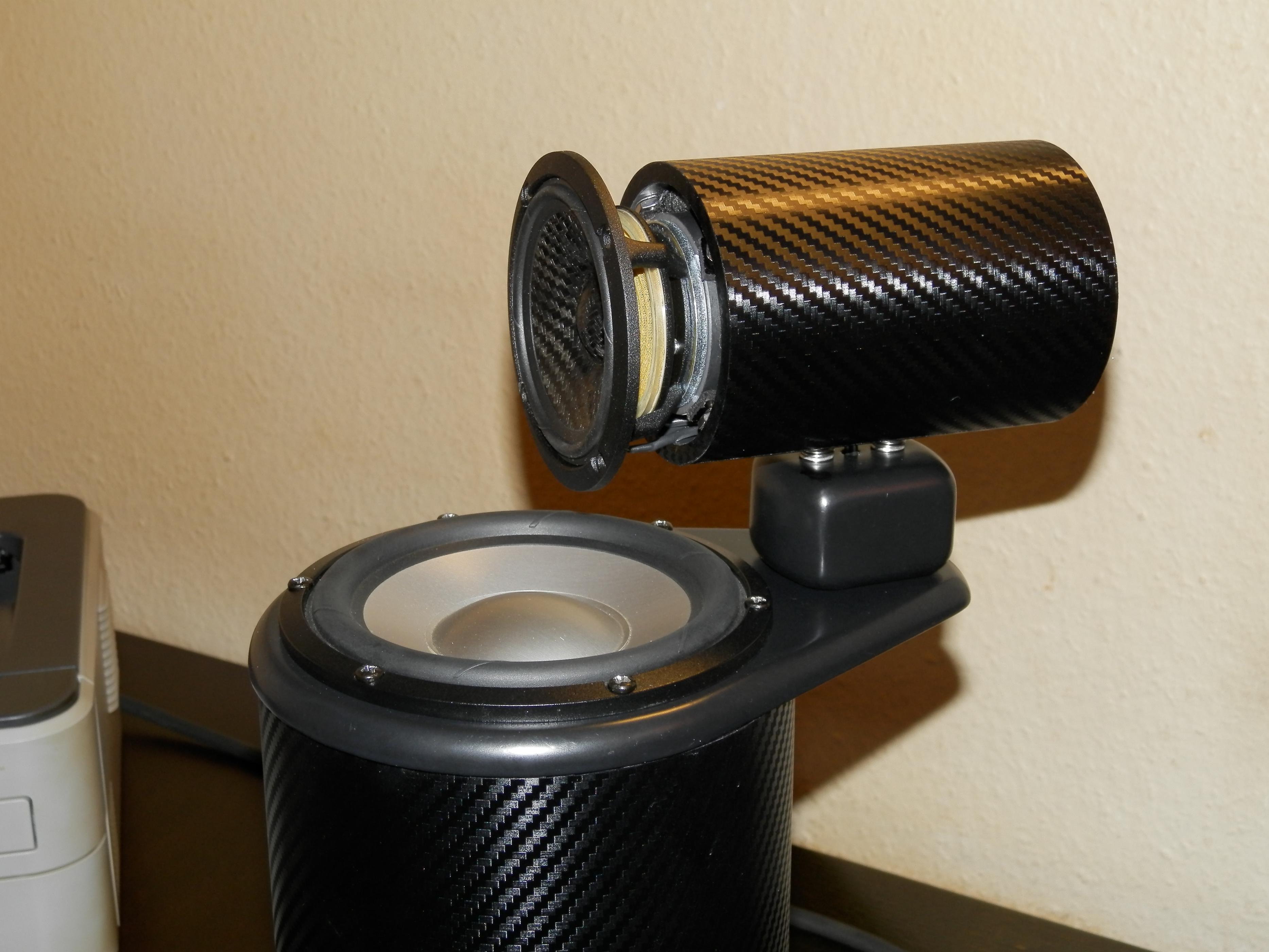

the pipes are made of pvc. The carbon design is simple car wrapping foil.

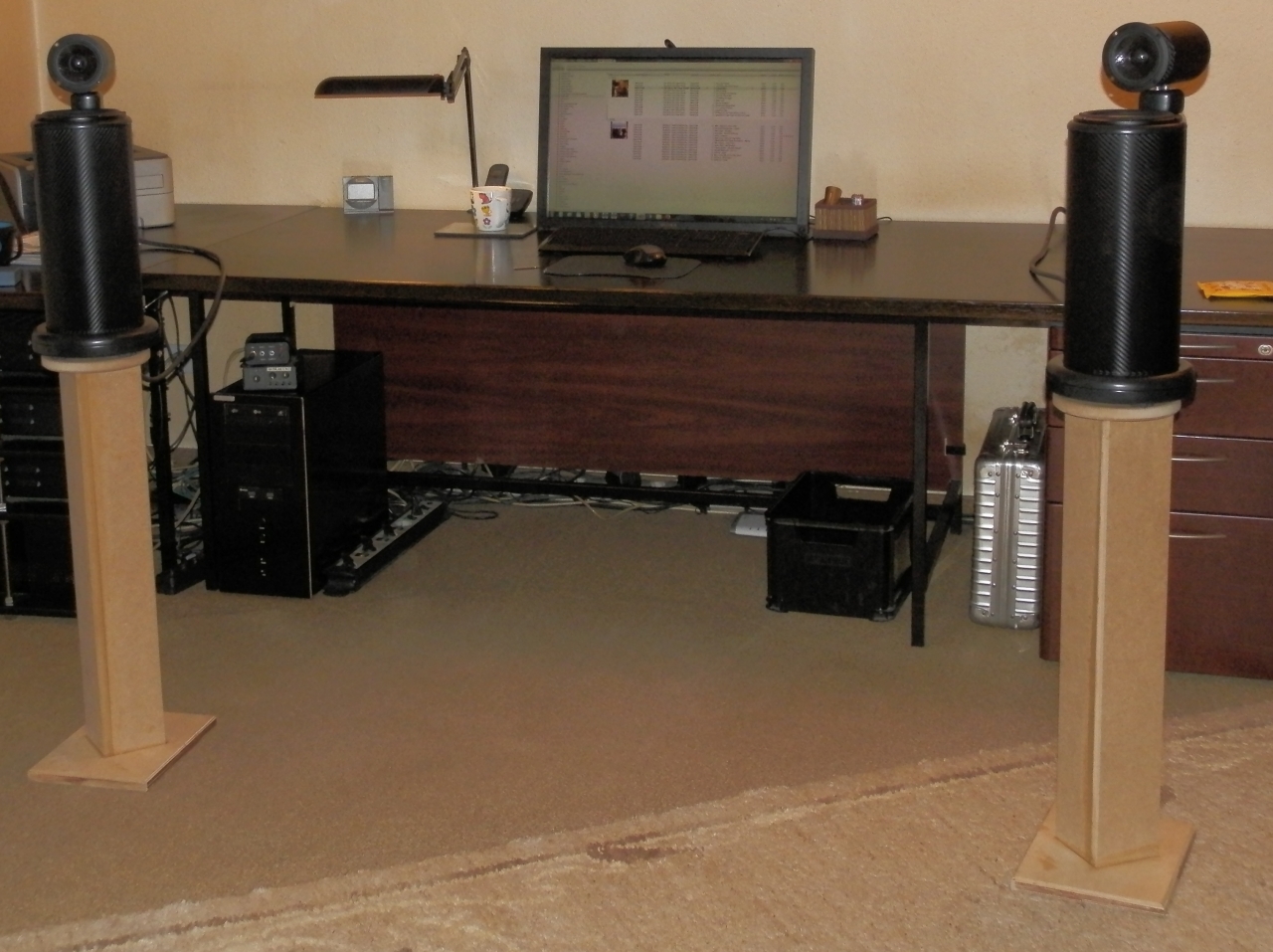

I will have to build new stands, because they are ugly and to tall, if i'm sitting in my armchair. 😀
Michael
