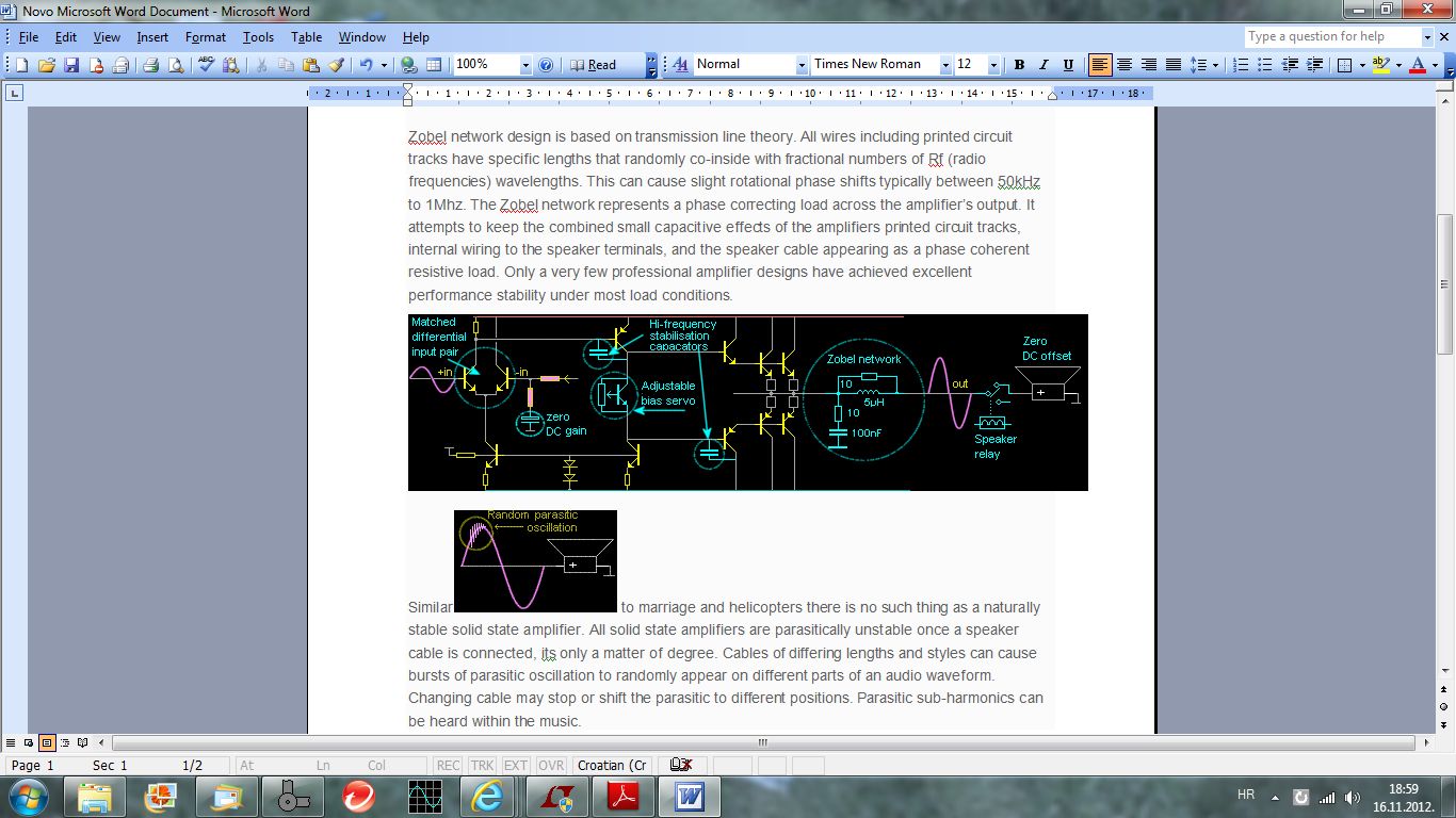

AS Lazy Cat said here,
those 4 transistors in the diamond should be together 2 and 2.
First the two 2SC4793+2SA1837
and also the two 2N5551+2N5401.
It is also good if those two pairs are very close to eachother.
Another thing that was wrong in the schematic I emailed you, sakis
is the output filter.
Inductor+resistor comes first and at the end comes capacitor+resistor(Zobel).
You can see it in this picture:
Most of the power amp zobels use RC connected close to the output and inductance part could be close to the loudspeaker terminal. D. Self does it that way and many others.
dado

Hi Guys
Convention is not necessarily the best way. Leach had output stages oscillate to death with the zobel on the amp side of the coil. If you are tired of Leach, look at Bryston: they place the zobel after the choke, too. Chris Russell and Stuart Taylor are both very smart and tuned-in designers, as is Marshall Leach.
I think even Archie Leach would agree.
The trimpot for DC offset definitely will be problematic in its present position. The concern about performance is real. A less crucial facet is the fact both signal and DC currents are effected by the pot's rotation, so definitely adjust it WITHOUT a speaker in place - unless you like earthquake noises.
Considering the effort so far to create a power buffer with stupendous performance - wide bandwidth, super-low THD - it seems like a major fumble to retain the input offset trimpot. FdW and I seem in agreement on this, but Sakis will only consider Lineup's input for the PCB. His position is understandable considering his effort to design the card, but he has already acknowledged that this is only a beginning: more board designs will be necessary.
