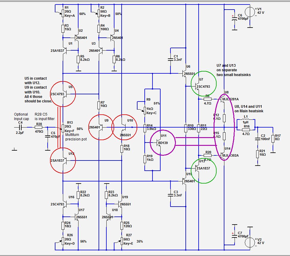

It works, but can you give a justification for this level of complexity, U5 and U9 could easily make up input stage and vas in a conventional design.
I see what you mean. This Buffer became more complex than I like.
But this is not unusual.
There are so complex preamplifiers for many dollars, when all that is really needed is one single OPamp.
The hunt for perfection costs a lot of complexity.
I can give schematics over amplifiers that are horrendous. Not at all on the level with Doug Self's Blameless.

Complexity is in the ear of the beholder. If one wants a conventional design one should visit a different thread. The design here is actually NEW and INNOVATIVE! If that scares some people, they should hide behind Lin.
My PCB layout for my version of the buffer has all four elements of the diamond feedback buffer in contact. It is a simple matter to set the flats of the 2SA/2SC inputs back-to-back so they can be bolted together. The TO-92s are arranged outside of these with their flats against the TO-220Fs. A rubber band or heat-shrink tube can be used to hold everything in contact. Because of how the pinouts work out, the emitter Rs for the TO-92s must be mounted first, lying between the TO-92 and related TO-220F. No traces have to cross, so a single-sided arrangement can be used for this portion.
My PCB is 4.5x3", with two pairs of outputs, local filter caps and decoupling for the front-end. The addition of current sources for the front-end to make it exactly like the latest Lineup buffer would not make the board much larger if at all.

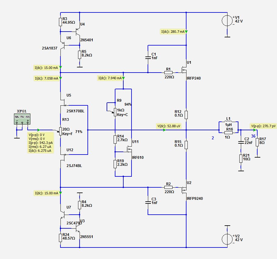

Meanwhile I post a simplified version.
This has Complementary JFET input
and the output is MOSFET IRFP240/9240.
The distortion is a bit higher than for Normal with Triple EF output.
But this circuit is still showing not too bad numbers.
For most applications this will do very well.
.... and it is so simple! :)

Hi Guys
The biggest problem with complimentary jfet circuits is acquiring jfets and matching them.
John Curl famously uses such input stages - complimentary jfet diff amps - in has amps since the 1970s. When he bagen, the range of jfet types was expanding. In recent times, that range has diminished to a great extent. His designs for Parasound are essentially what he has been building for decades, but with a DC servo added, more degeneration here and there to accommodate unselected parts, and other accommodations for production. His own company builds the versions of these circuits with critically selected components and he can only produce a few amps a year at mega-prices. The sim models for jfets will be ideal, reflecting a need for selection and matching for best performance - possibly even for reliable functioning.
Both Curl and Pass bemoan the hunting and hoarding required to be able to sort through and find matched sets of comp jfets. These are very useful devices but industry has generally abandoned the need for p-channels.

Here is a partial layout, just of the diamond feedback buffer area, to show how two TO220s and two TO-92s can be held in thermal contact. Hopefully the PDF allows colour. In the layout, RED is top copper and BLU is bottom copper as is standard. I set the Q1-4 designations out to the side to make it easier to see them in case the PDF is all-black.
Between the TO-220s there is a top trace that covers a bottom trace over part of their travel. In Eagle (PCB layout software), you can turn off layers to see things more clearly.
The schemo shows R1 and R2 intact, instead of the trimpot. Also, there are base stops for Q3 and Q4.
V+ and V- are the supplies.
CS+2 is the current source that supplies the base of Q1.
CS-2 is the current source that supplies the base of Q2
Drive-pos is the signal drive to the upper EF half
Drive-neg is the signal drive to the lower EF half
Input and output are as they sound.
