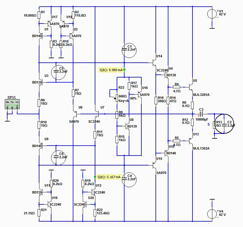

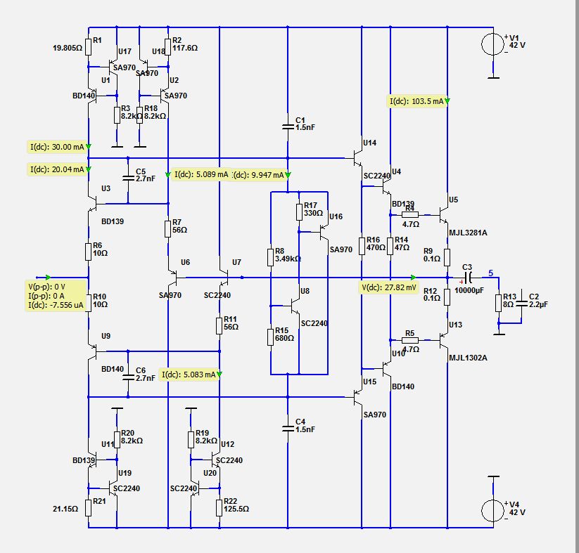

What I have tried so far is 20mA total 10mA throug the frontend. And as can be seen in diagram here below 30mA TOTAL 20 mA through frontend.
The improvement was not big.
The question is WHY should we lower current??
John Curl once said to me: Current is good!!!
I remember this, every now and then ....
This is the new circuit.
As can be seen it now uses 4 capacitors for compensation and to make the amplifier stable and behave good in capacitive loads.
The input impedance is now very high. More than 200 kOhm.
OnAudio, you ask me about the sound. Answer is nobody know - nobody tried it ..
I have not the possibility to try it in real circuit.
I hope some guy comes along and sees the potential of it.
Regards Lineup

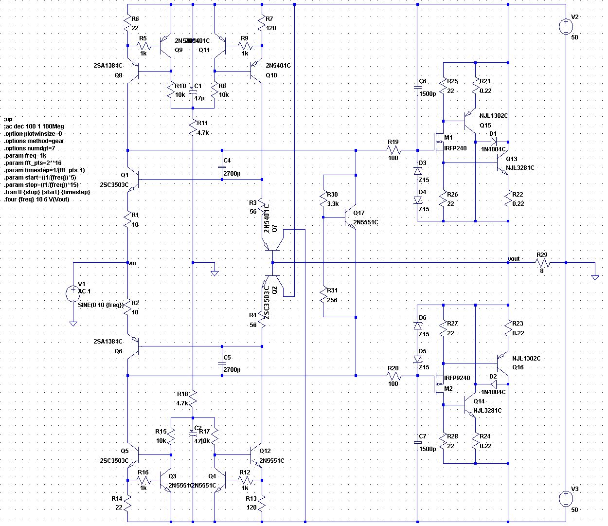

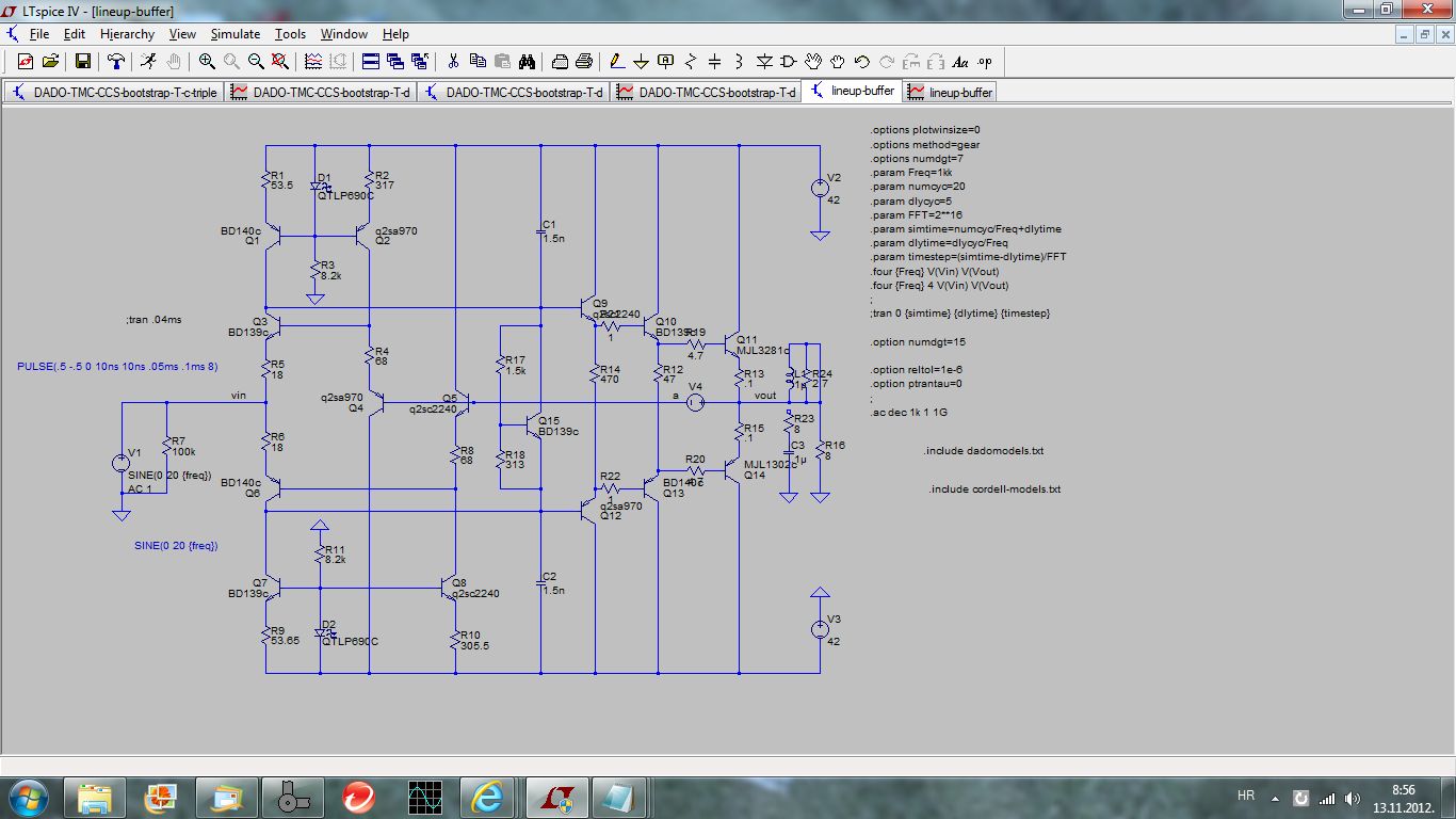

Working on the schematic now, should have something to sim in a while. I'll likely be using different transistor models as I'm using LT Spice. Probably use the Cordell models. We'll see what it looks like.

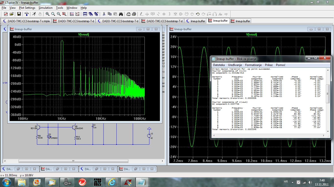

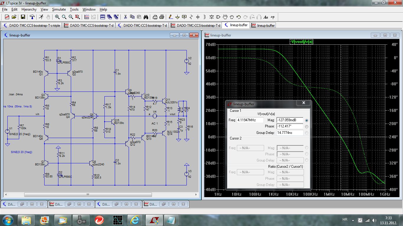

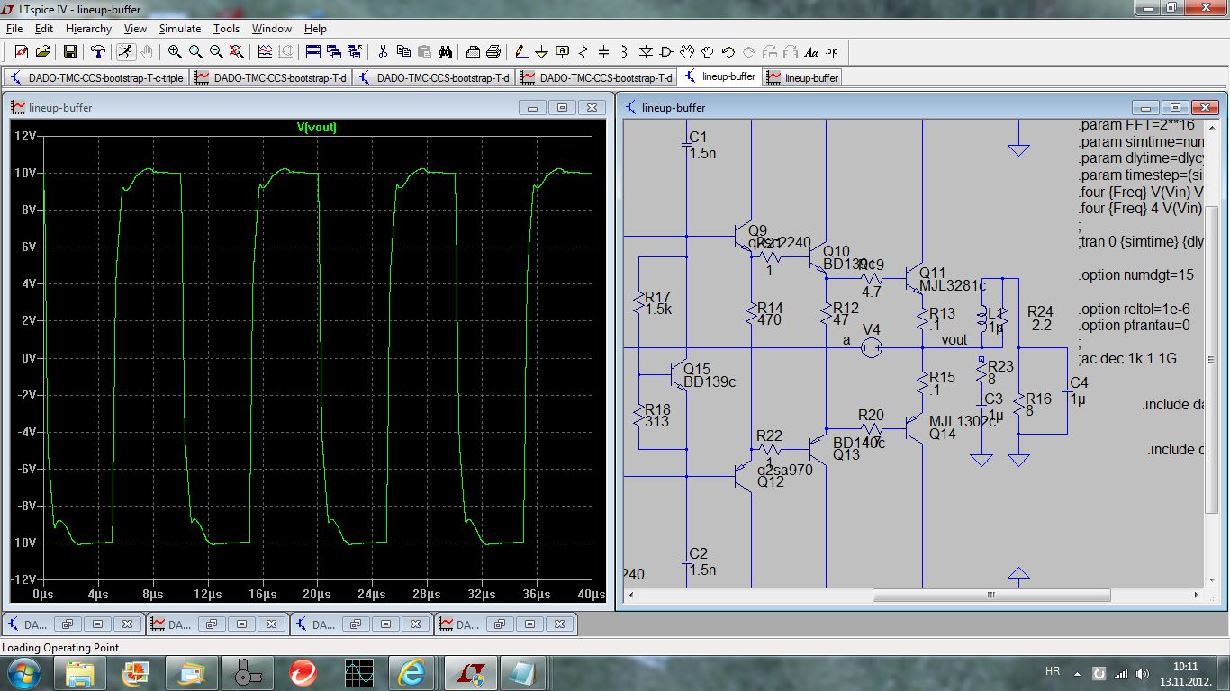

Some simulations, mostly Cordell models used. Bias set to 130 mA.
dado
Hi Dado
please send your simulation comand parameters, graph details looks nice,
thank you in advance
Hi Dado
You can see all from this screen shot.
dado
Great work, dadodYou can see all from this screen shot.
dado

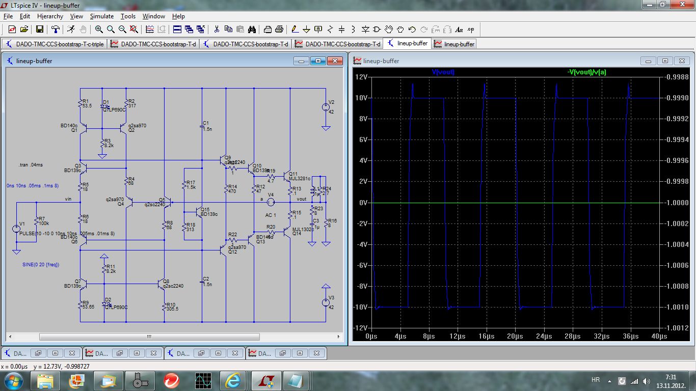

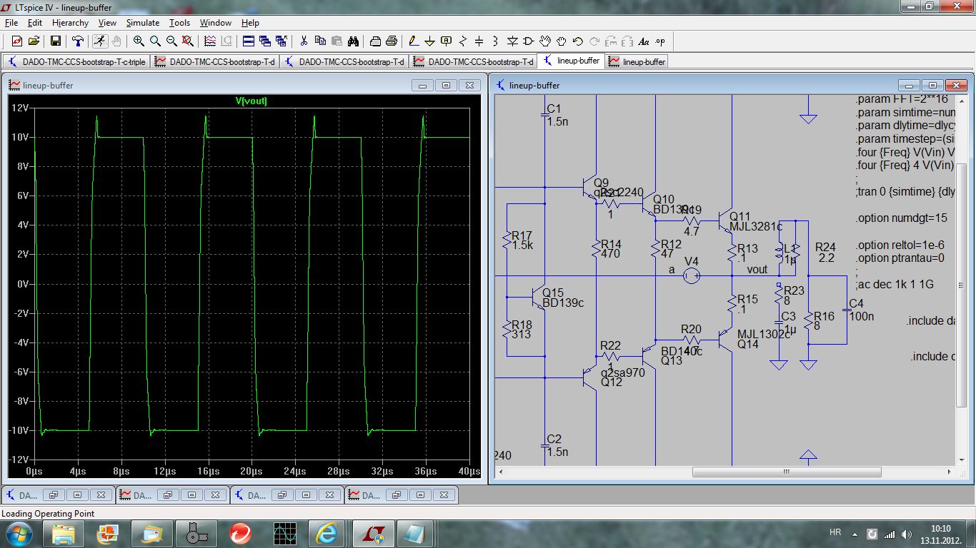

Do you think it is stable in capacitive load,
without those caps across Q3 and Q6.

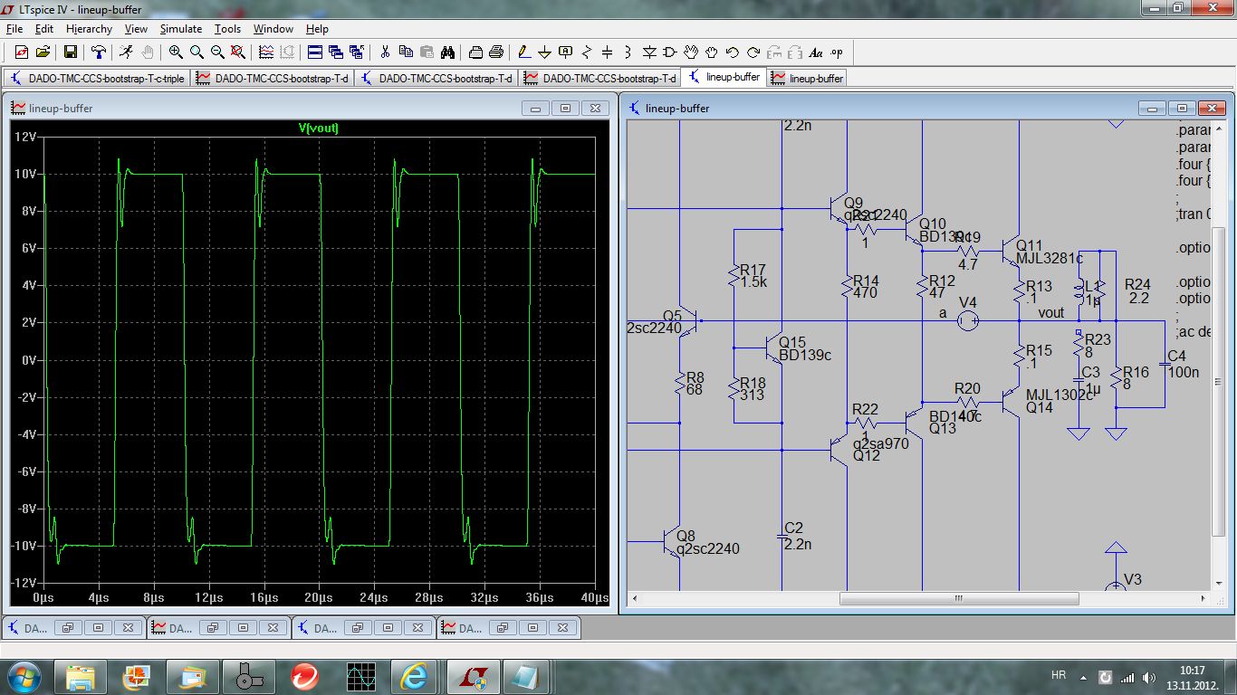

In my latest version I use 2.2nF there and also 2.2nF across the output transistors.
I think I see you use 1.5nF

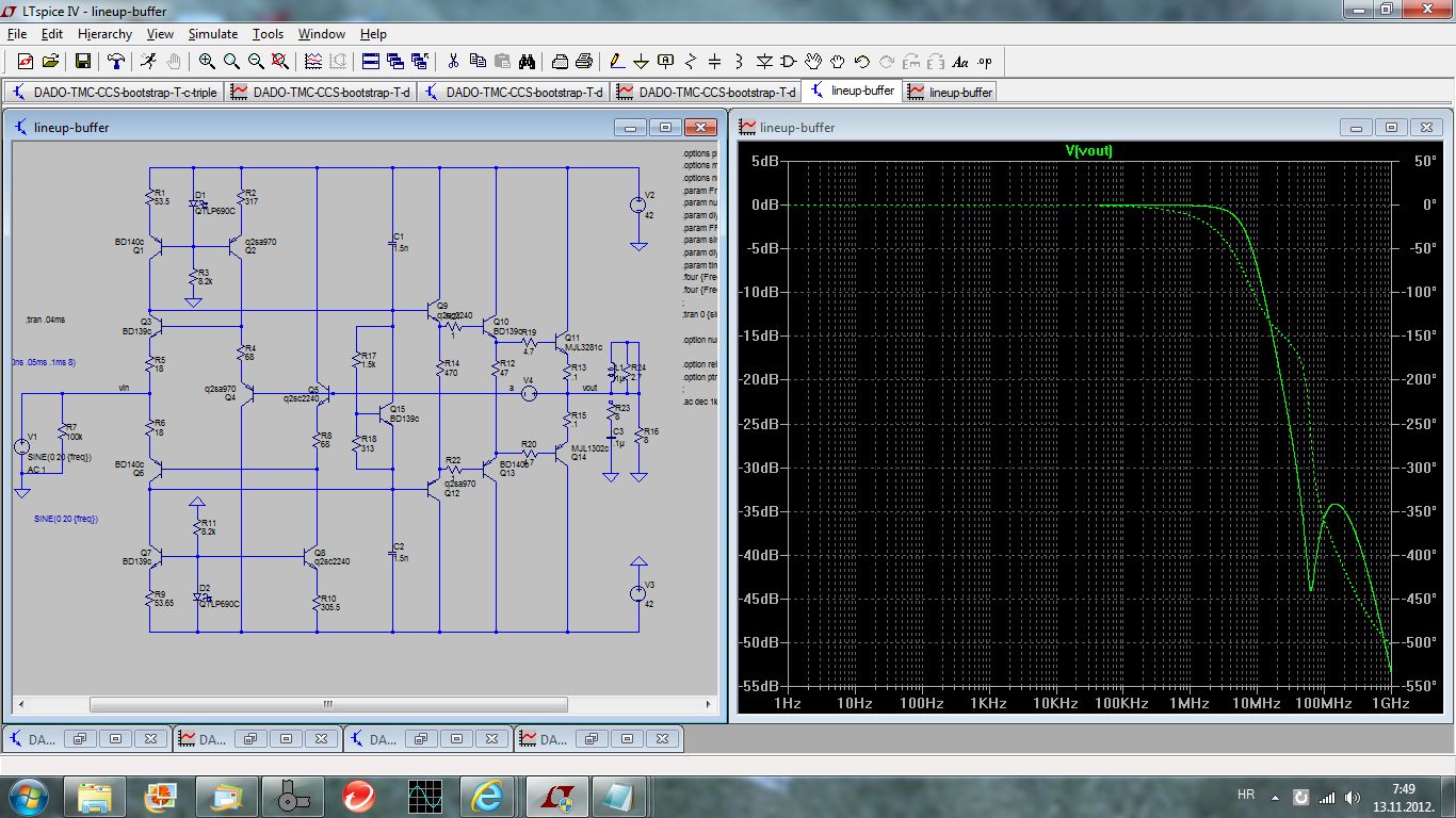

To test for stability in capacitive load use 8 Ohm//2.2uF as load.
I think that with 2.2 nF as in your last sch you slow the buffer to much, better use output inductance to protect against capacitive load.
First screen shot with your last suggested compensation there are still some oscilation on 100 nF load. With inductance you can see that there is no oscilation even with 1 uF and 1.5nF comp on predriver only. I did not try different compensation. Zobel was not connected during those simulations, but I would recomment to be used.
dado

Lineup Buffer + Lazy Cat BIGBT
Did not have a whole lot of time to play with this, but does work. Showed almost pure H2 only. Will spend some more time optimizing it to see what I can get out of it. THD was 0.000235% without any optimization and non-ideal MOSFETs used, will looks for spice models for more realistic devices.

Thanks. I will add inductance instead.I think that with 2.2 nF as in your last sch you slow the buffer to much, better use output inductance to protect against capacitive load.
dado
That will keep the distortion low within the circuit,
and at the same time protect against capacitive looads.
