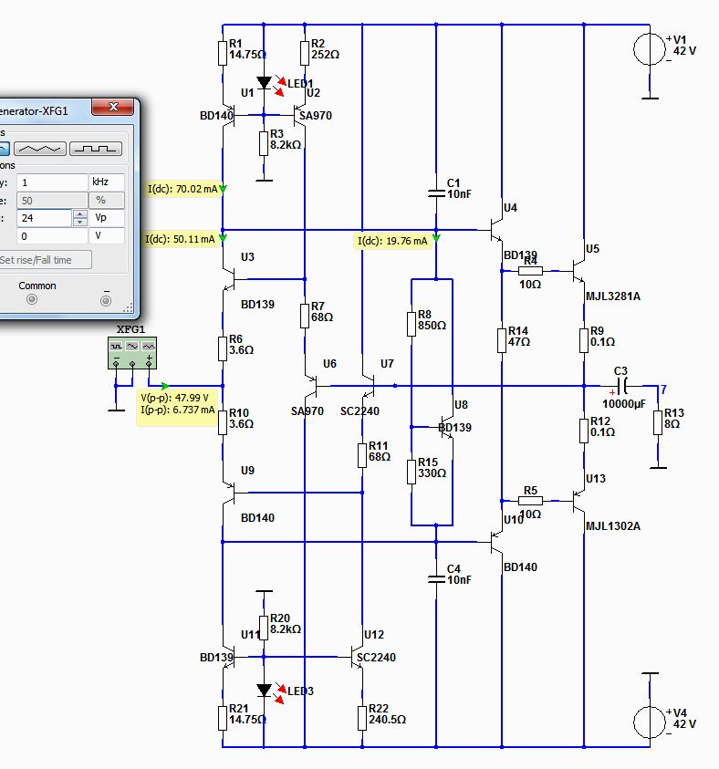

New Lineup IDEA - Power Follower/Output stage

Maybe you can improve distortion figures by elevating voltage for U3, U9. Add diodes in series with the R14.
dado
dadod
Elevating voltage, I do not believe in adding diode. The idea is correct, but ....
I prefer CBS240 advice. To add another follower stage.
This will make the output triple EF.
I will test this as it improves gain of the circuit.
Thanks.

The BJT circuit is good as is. Definitely leave out series diodes in the audio path.
Lineup, on the first mosfet form, the sim showed that for 44Vpp input, the input current was just over 4mApp. That was with 20mA in the front-end. How do the peak drive currents look for the 40mA input circuit?

I love the Struth.
Because you have understood the circuit correctly.
You also see the benefit of it.
About the input current.
This is the input impedance of the circuit.
I have seen values of 6k-8k input impedance at testing. The BJT version with 2EF follower.
This is a value that most voltage amplifiers will like.
What I need to try is the triple EF output. I expect it to be great!
Whay don't you live to lineup to deside what is good for his buffer?
I love you.
Because the creator is supposed to know a little better.
I have a working setup in spice and can see the numbers.
But reality test is to setup a circuit in real life.
This is the ultimate test.
If the circuit shows bad performace it is me taking the blame.
Now, I do think the circuit will work just fine.
What is important is those 2 compensation capacitors.
Without them the circuit is prone to oscillate!
Because any feedback circuit can overshoot and start acting as an oscillator.

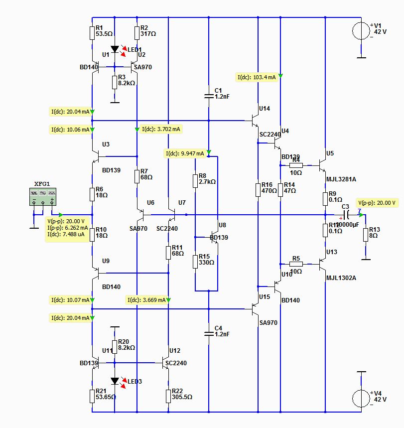

This is the ultimate version with 2 EF follower output.
It shows rather good values of distortion.
As can be seen the input impedance at 24 Vp input is
48/6.737 = 7k12.
The figures I get are quite low distortion.
At this level the THD is 0.00031%
This is a good value at 36 Watt RMS output.
Now, I expect much lower value of distortion with triple EF.
And considerably higher input impedance.
I be back with a triple emitter follower.
Like in the Leach amplifier.

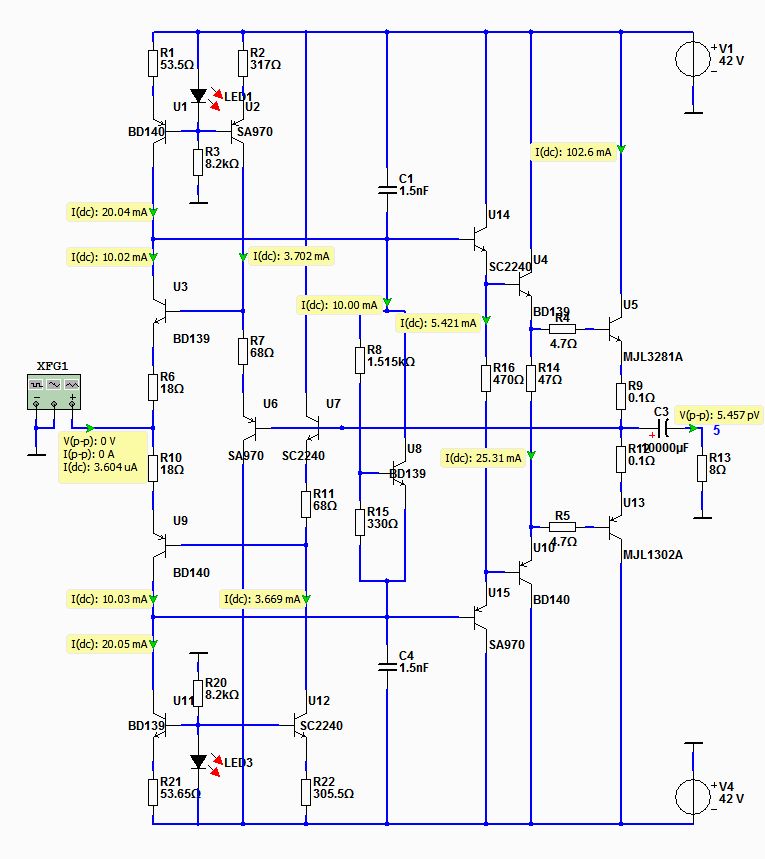

I have tested for AC analysis.
For the triple there is only needed 1.2nF compensation.
While for the 2 EF was needed 10 nF.
The best version so far is one triple EF and with only 10 mA frontend current.
I am just about to complete the FFT of this version.
It shows some tremendous improvenment when testing with 20kHz signal!
I will increase current in frontend and test further.
As one learns about this circuit one could make it better.
Remember this is a new circuit. All we learn will be totally new.
This is the best so far.
Triple EF with only 10 mA through the frontend.
The improvement in 20 kHz is fantastic!!!!
I think I am close to the perfect circuit.
However the input impedance is now only 3 kOhm.
What we would like is something like 10 kOhm.
The figures for 1 kHz and 20 kHz
Power Supply +/-42 Volt, 8 Ohm load 6a 10mA

This is the correct numbers of the Triple EF circuit.
I think it is just great.
The 20 kHz numbers are so impressive.
I hope you like what you see.
This circuit deserves a chance.
Can't wait to see someone give it a shot.

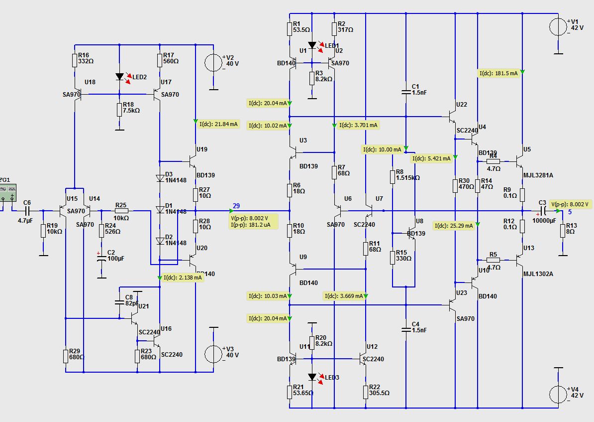

The preamp before this buffer could be a nice discrete opamp or a tube preamp for higher voltage. Then adding the power buffer will make the signal good for loudspeakers.
Normal power amplifiers have input and VAS stage to do the voltage amplification.
In this concept we use a preamp to do the voltage amplification and so we add a buffer for loudspeakers.
I show you only one example here.
This is a good voltage amp. With low distortion.
After this we put the power buffer.
See my diagram and you will understand.
