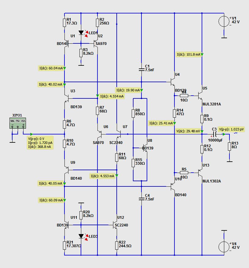

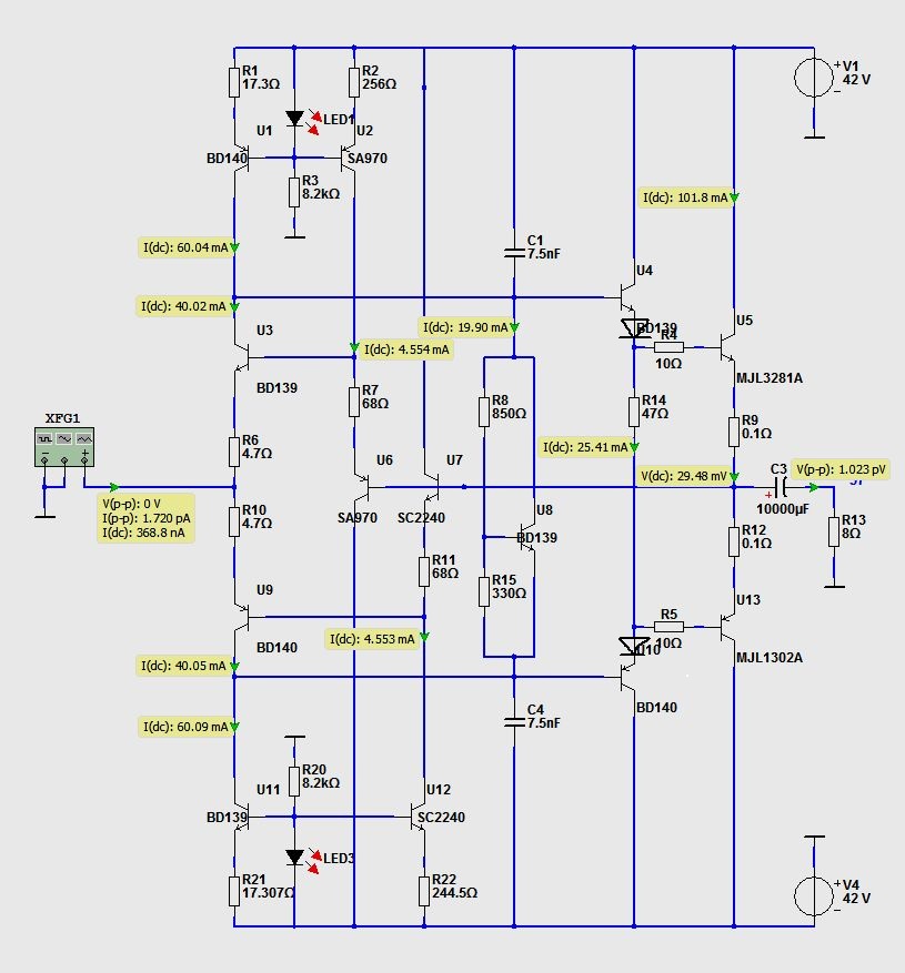

I have now made some numbers from a BJT output.
It works almost as good as MOSFETs.
If I should pick one today it would be with MOSFETs.
Anyway here is the numbers for the BJT 3281A and 1302A output.
Those models are good. Made by Andy_c

And here is the circuit I use for those numbers
Maybe you can improve distortion figures by elevating voltage for U3, U9. Add diodes in series with the R14.
dado
Or add another follower gain stage😉
That circuit is similar to the amplified diode that is the basis of HEC but it is a little different. U3(U9) still act as the differential amplifier where one input is the VAS and the other is the output node. The difference signal becomes the 'error correction' component. HEC utilizes feedback/feedforward instead of just nested feedback. Also the FB/FF loop has near unity gain(high BW) in the HEC amplified diode. What kind of temperature sensing scheme have you come up with? I assume U3(U9) would be mounted with the output transistors.🙂
Hi Guys
The BJT circuit is good as is. Definitely leave out series diodes in the audio path.
But... I think it would benefit from being a triple-EF instead of just a double-EF. This has the benefit of allowing lower front-end currents and a higher input impedance along with the usual benefits. Similarly, paralleled outputs provide a larger class-A region, more constant gm, lower output impedance, reduced stress on the driver, etc.
Elvee, a circuit that is so sensitive to tiny capacitances has more serious problems than you seem to wish to acknowledge. You said yourself that you blew up a lot of output devices. Does your statement that the circuit transparently "accepts" any type of output device really just mean it blows them up in egalitarian fashion? It has been amply demonstrated that circuits requiring finnicky adjustment of precise current/voltage/gain values are not reliable performers in the real world. The circuit form posted here is in that category.
Lineup's circuit has a simpler error correction path and has been fitted with normal add-ons required to build a practical circuit - degeneration resistors, gate-stops, etc. I have a working version here built similarly to the BJT circuit but with a triple instead. For the circuit to be "universal", I think the input impedance needs to be higher than it is now headed and the triple helps with that.
The Lineup THD numbers for 1kHz and 20kHz are already phenomenal - and they started off that way! Kudos to a good design. What really needs to be seen is the distortion profile. The idealised sim will be low for even orders and higher for odd orders. A real circuit won't balance out the evens so well, so the actual distortion profile should be fairly balanced and should sound good.
Lineup, on the first mosfet form, the sim showed that for 44Vpp input, the input current was just over 4mApp. That was with 20mA in the front-end. How do the peak drive currents look for the 40mA input circuit?
Problem is not tiny capacitances or otherwise, but the huge loop gain that gives the circuit its "magical" properties. Real wiring has inductances, resistances, etc and there is an infinite combination of them that can turn the circuit into an oscillator.
See above. The one thing it does not require is finnicky adjustment for DC conditions or similar, and it accepts any type of device without readjustment or change in performance.
Problem is the stability, both local and when it interacts with the main feedback loop(s).
Simpler and degenerated versions can be made to work, but at the cost of blunted performances, which does not interest me.
Even then, the high gain requires due care and attention: watch out the behavior on capacitive load for instance

Hi Guys
I don't see why a LED is used in the bias circuit. Thermal compensation would be better with many of the other bias-reg forms where the diodes are in the base circuit.
For example, Leach found that three diodes undercompensated the output stage in his amps, where four diodes nominally should have overcompensated it but did not, fixing thermal issues builders were having.
Although the performance of the first version Lineup buffer tempts me to use mosfets, I would never use a jfet in a bias circuit. Fortunately, a board can be laid out to accommodate mosfet or BJT outputs, along with driver pairs. Gate protection zeners can be either stuffed or not but should be used for the mosfets.
