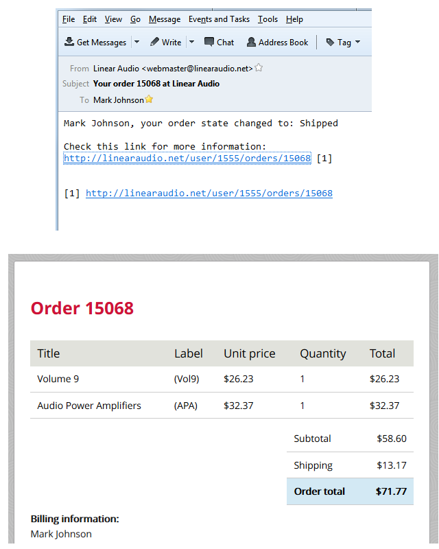

Jan, I ordered both v.9 and APA from the Linear Audio website and received an email notification that my order was Shipped. Attachment below.
However, the mailing envelope received April 15th only contained v.9 and not APA. Does your fulfillment group send two books in two different envelopes?
