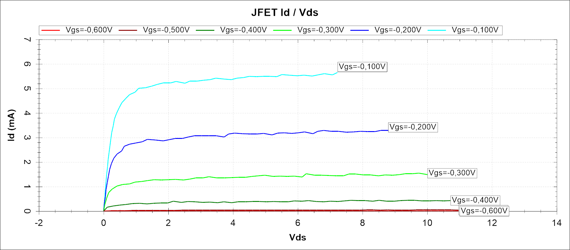

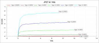

Mine arrived yesterday. Here are some measurements I took on the LSJ74-BL with a DCA Pro.
Test Result:
P-Ch JFET
Blue-G, Symmetrical Src/Drn
Vgs(off)=-0,63V at Id=1,0µA
Vgs(on)=-0,12V at Id=5,03mA
gfs=22,8mA/V at Id=3,0mA to 5,0mA
Id=8,38mA at Vgs=0,00V and Vds=6,50V

Usually, the IV curves of Pchannel FETs are plotted in the 3rd quadrant rather than the 1st. Maybe your software automatically plots the absolute value of VDS and IDS? Also the sign of VGS is backwards; a Pchannel FET cuts off when VGS is a large positive number.
