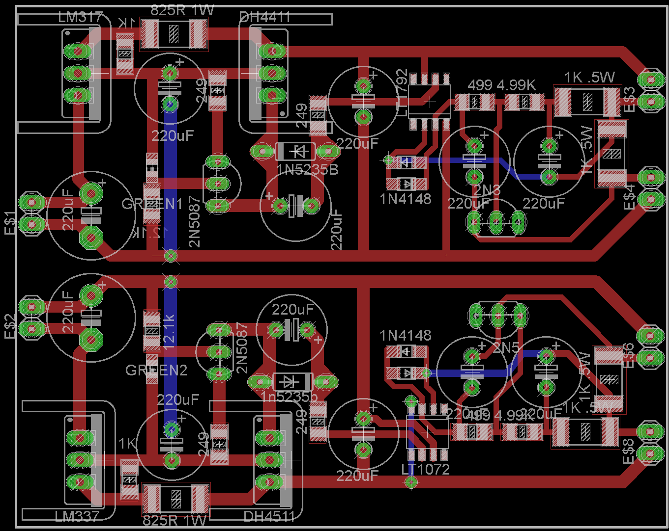

Would you folks mind takin a look at my attempt at the regulator to see if anything stands out as being poorly laid out or bad for final outcome. I am unsure about how to add a ground screen in Eagle under sensitive portion.

moderator should probably move your post to the "Super Regulator collecting the facts" thread -- an observation -- the sense resistors shouldn't be at right angles, the error amplifier should be rotated 90 degrees so that pins 2 and 3 have the shortest possible route to the sense resistors. using capacitors larger than those specified by Walt will affect the performance of the regulator. those originally specified in the 1995 article are no longer available so use panasonic fc.
Ok thank for the thread info. I will ask there. The caps are FM and I dont think they are larger than the current FC, but do have better ESR and current specs.
