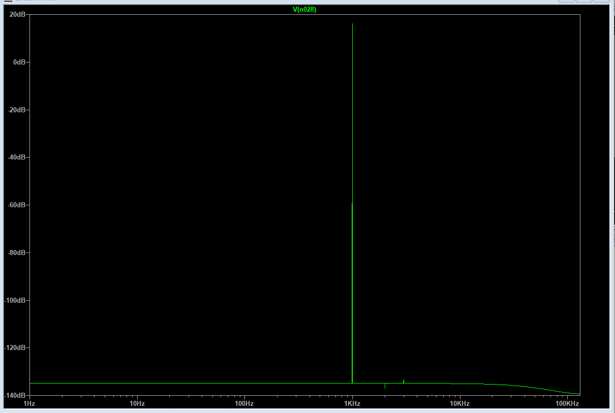

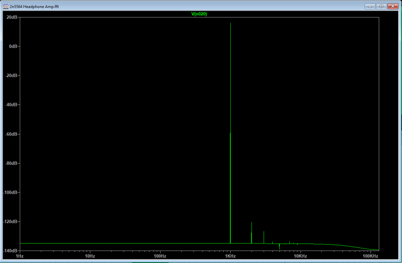

Fooling around in SPICE just now, I compared distortion spectra for HPA1 and HPA2. All plots are with 18V pk-pk output and 32 Ohm load.
The first picture is HPA2.
The second picture is HPA1.
The third picture is HPA1 without the Baker clamp diode.
Can you hear 3rd harmonic at -150dBc? I have no idea what this means in real life.

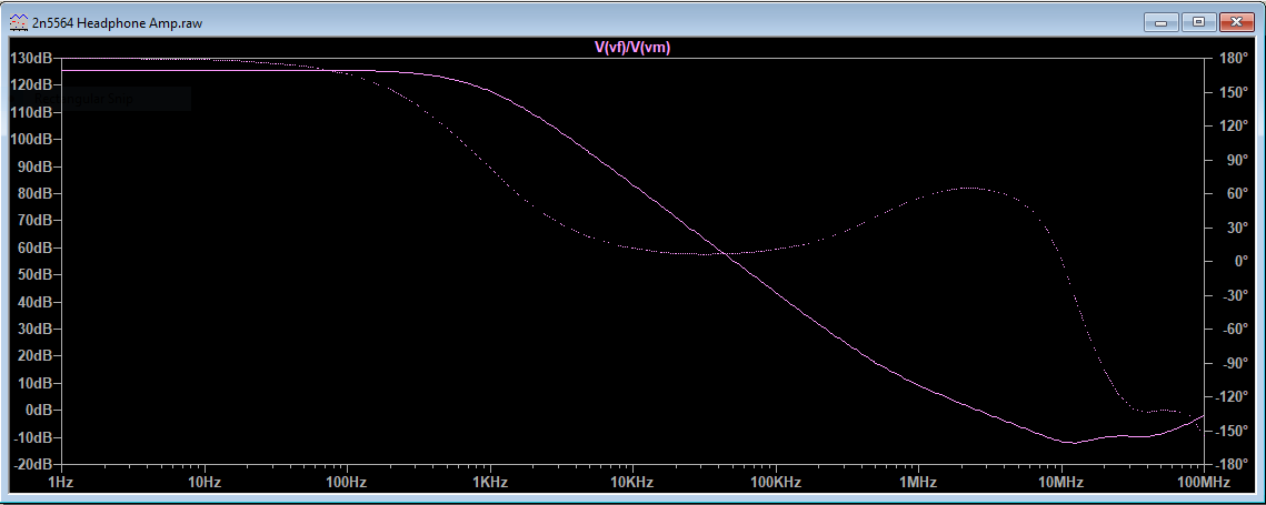

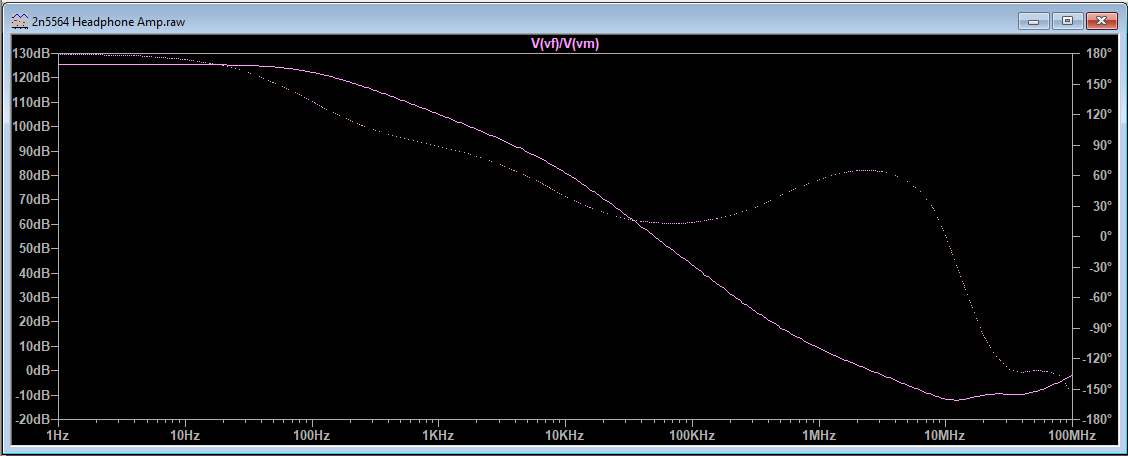

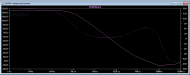

I finally bit the bullet and removed the Baker clamp diodes from the HPA1 just now. (I was traumatized by the other night's fiasco, so had to work up the nerve to take the soldering iron to it again.)
Below are SPICE Bode plots with (first) and without (second) the Baker clamps.
The thing to note is that almost the entire audio spectrum is dominated by the capacitance of the diode. You can see that as the difference between the two loop gain plots. With the diode, we lose almost 20dB of global negative feedback at 1kHz, and the gain of the amplifier is effectively controlled by the diode's nonlinear junction capacitance throughout the midrange.
With conventional Miller compensation, the diode would be in parallel with a typical 100pF capacitor, so its contribution to the overall collector-base capacitance would be a tiny fraction of the total. Not so with two-pole compensation, where the collector-base feedback (without the diode) is much lower at midband.
It's hard to overstate how critical the VAS shunt feedback is to the overall distortion of the amplifier. Miller effect greatly magnifies any nonlinearity in this path. Of course, I'm trusting the sound of my amplifier to industrial-grade C0G ceramic capacitors, so who knows? In theory, these are very good parts, ceramic notwithstanding.
To clarify, I should have said "the open loop gain is effectively controlled..." The overall closed-loop gain will still be determined by the global feedback network. But the diode nonlinearity, while greatly reduced by feedback, will still be there, and will create a slew of higher-order distortions, which probably aren't modeled very well by SPICE.
Edit: On the other hand, all these distortions are still going to be a very low levels, thanks to the huge amount of NFB in the circuit. It's all a mystery to me. I really like the Cordell circuit, intellectually, and feel a powerful emotional tug to prefer it in listening tests regardless of what my rational brain tells me.
