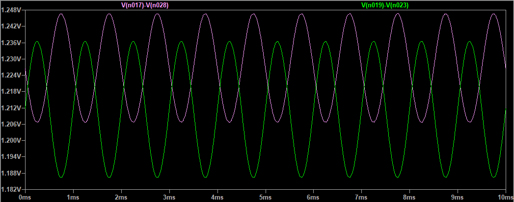

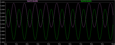

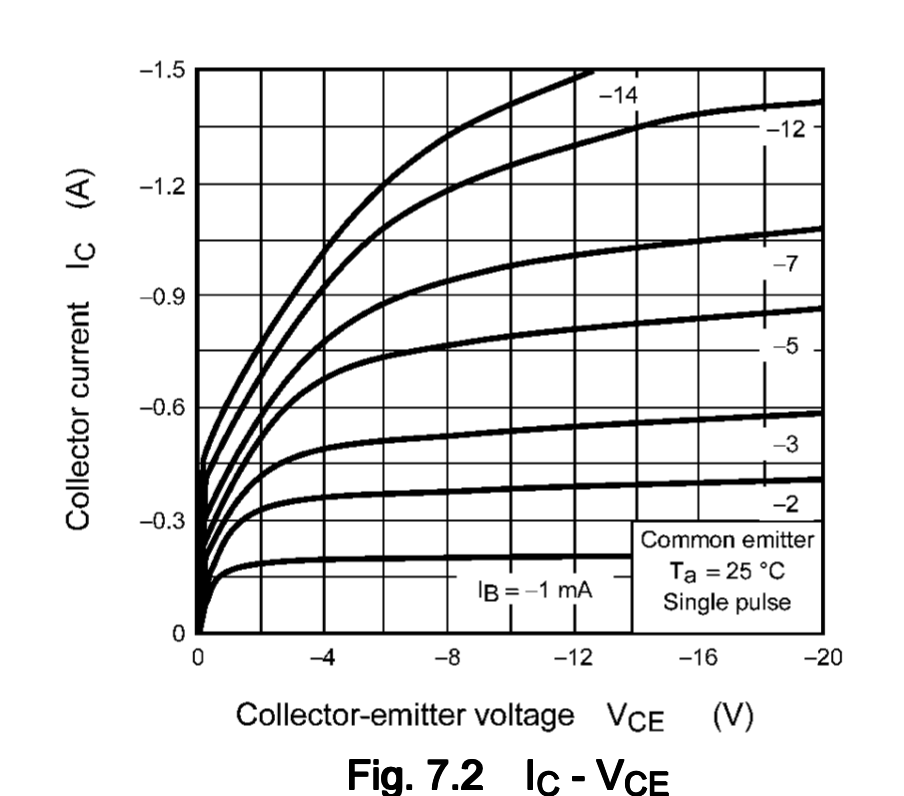

The driver transistors run at nearly zero Vcb. You want devices with a low saturation voltage here.
Edit: TBH, I didn't think of this latter point when I selected the TTA/TTC004B drivers. Their saturation voltage is given as 1.3V which is inadequate in this design, oops. But they are medium power devices with a maximum collector current of 1.5A. Saturation voltage will be much lower at 10mA. It seems to work well, but maybe changing to BC550/560 would give better results. In that case, you need to find a way to mount the TO-92 devices to the heat sink for thermal tracking.
SPICE predicts we have about 1.2V across the drivers, so we just get by by the skin of our teeth. Crisis averted, probably.
Edit: The plot of Vce sat versus Ic paints a more encouraging picture at low collector current.

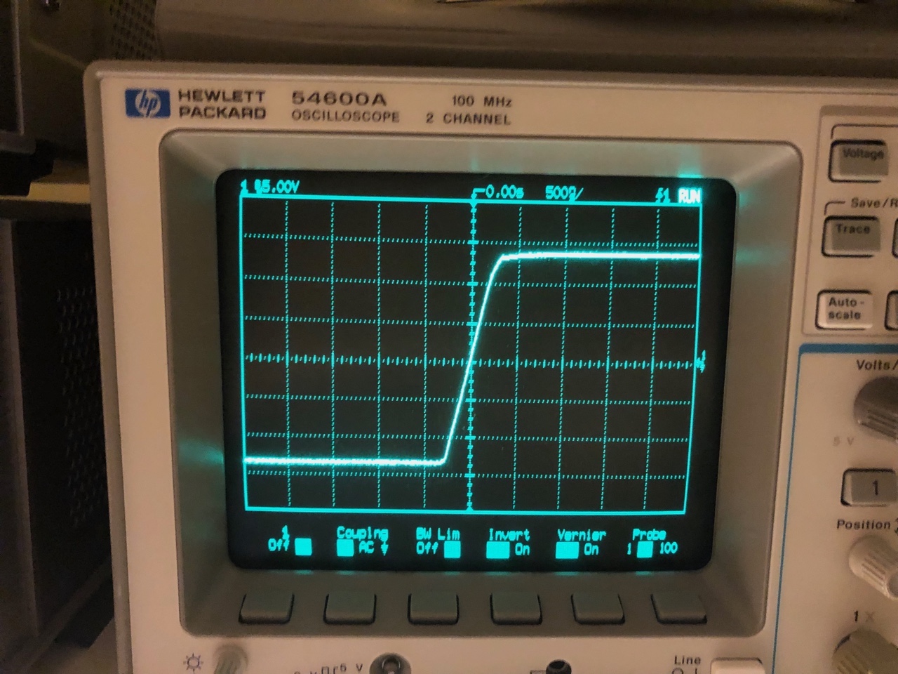

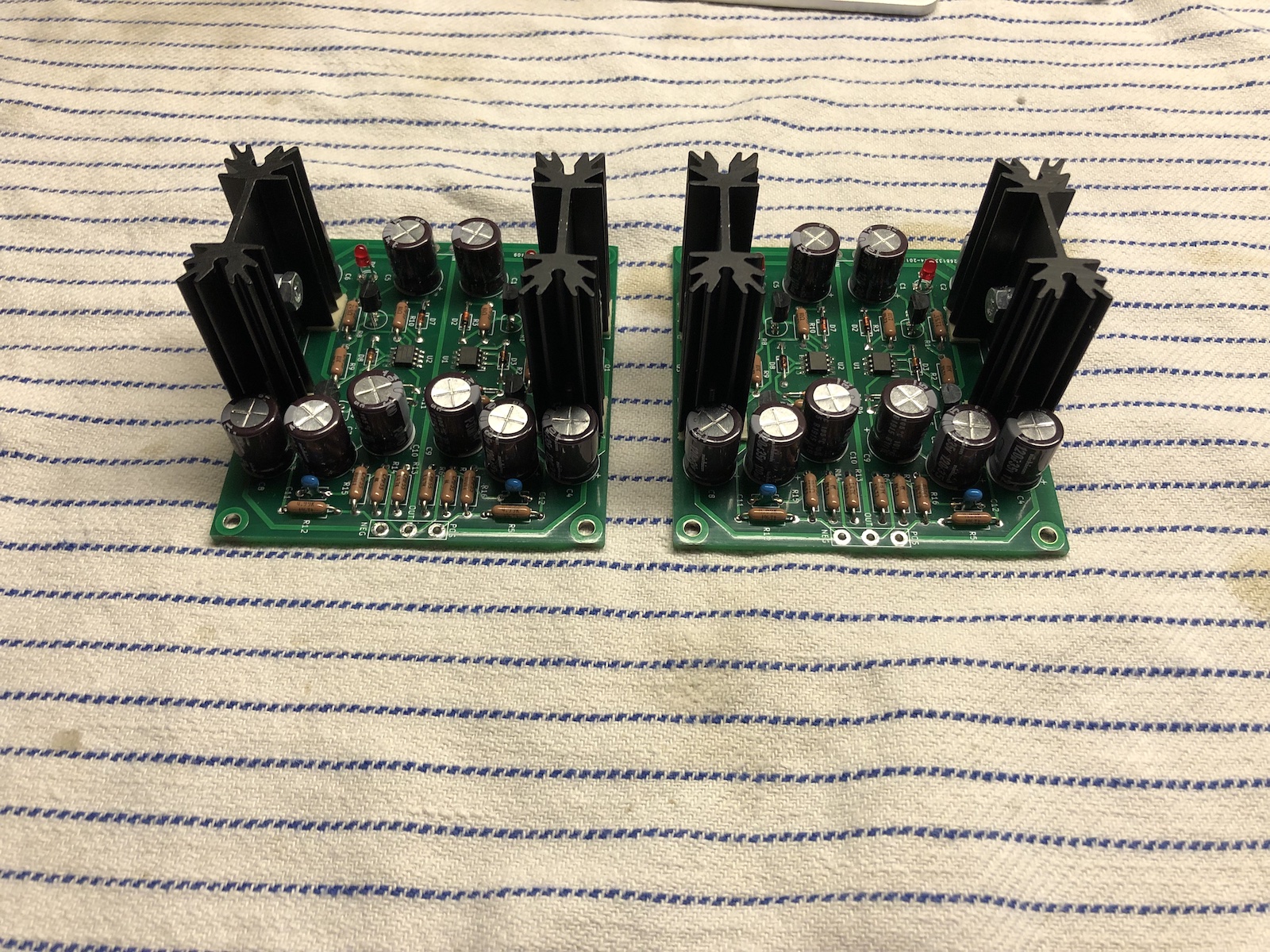

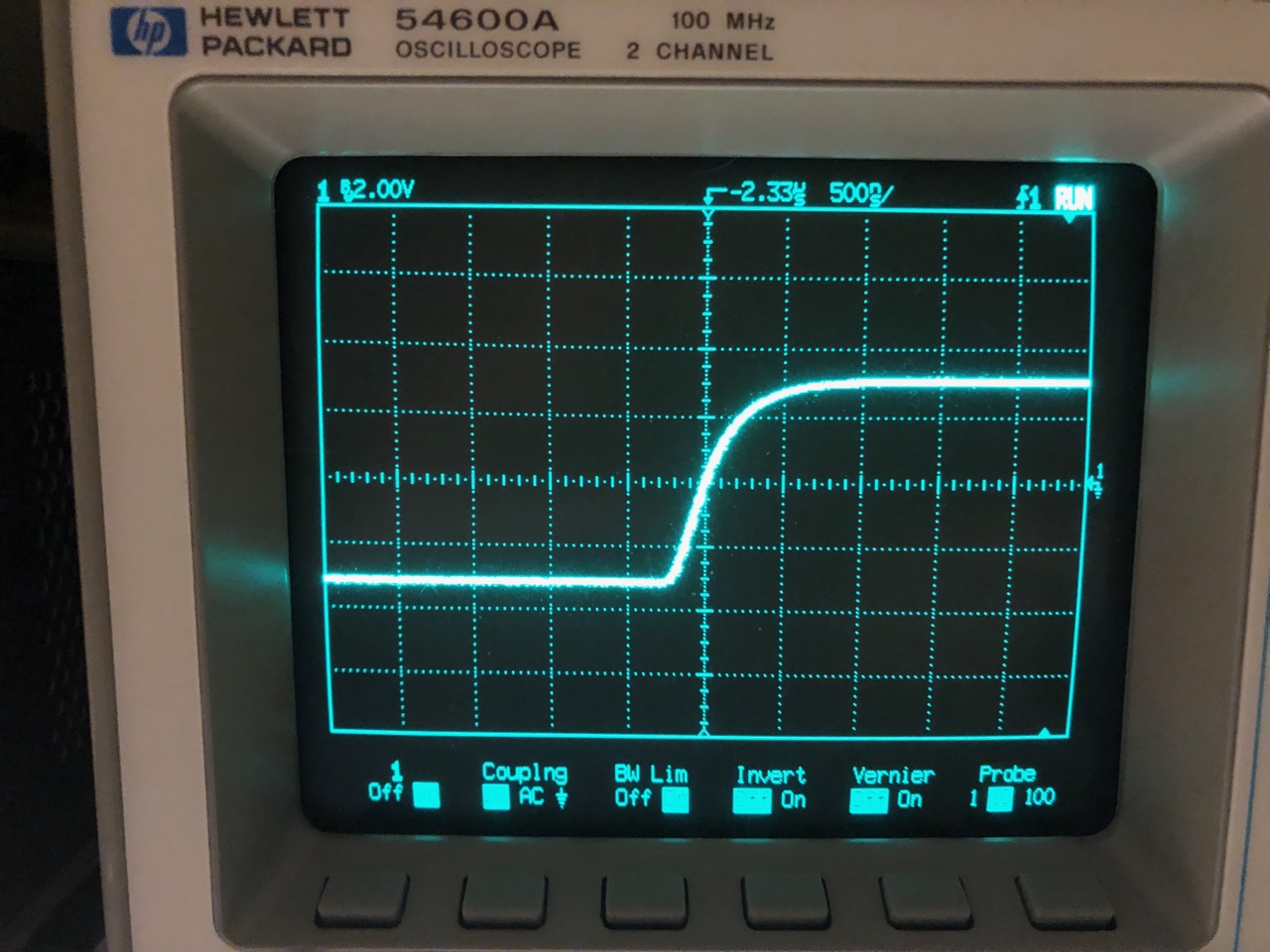

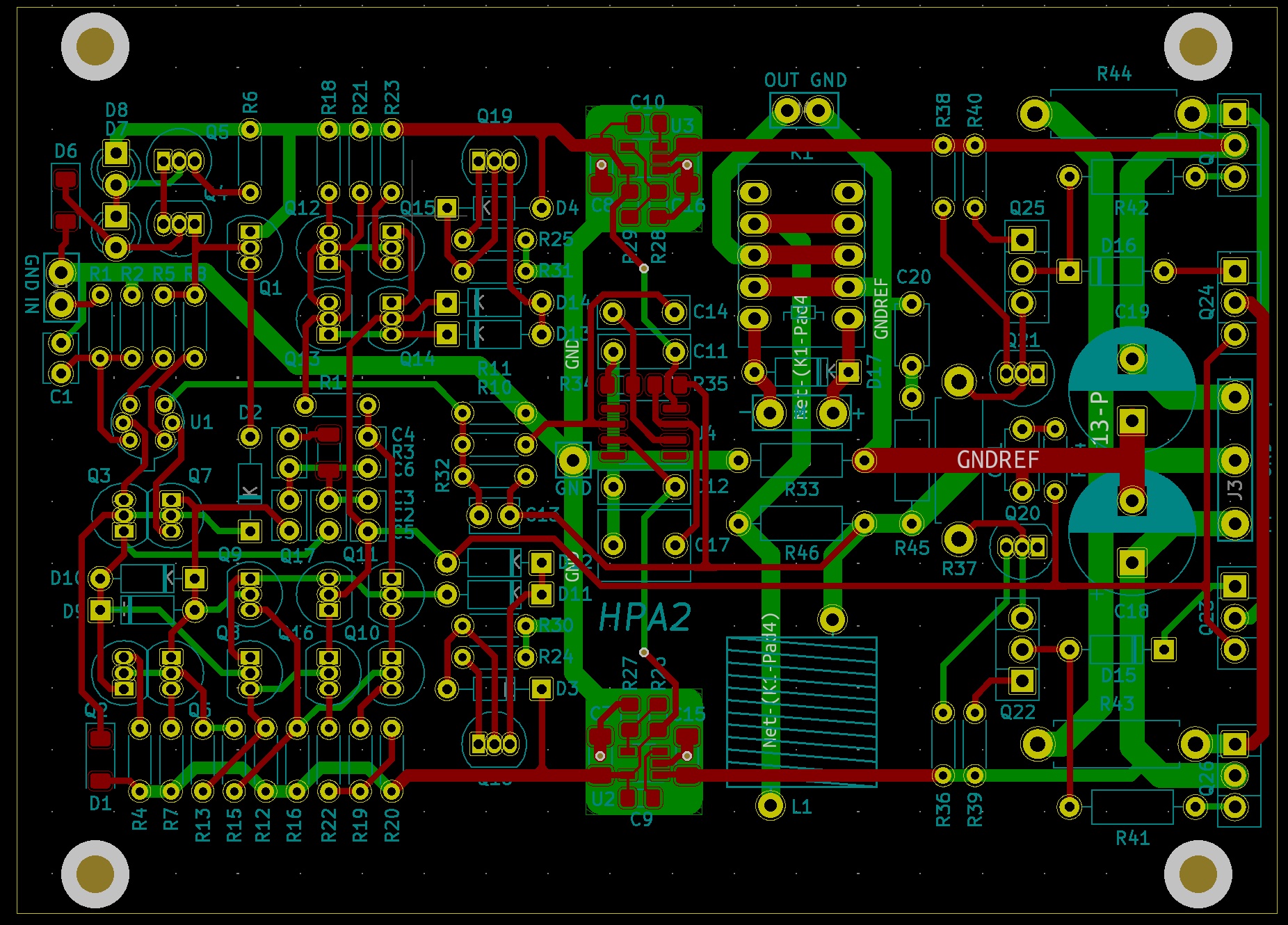

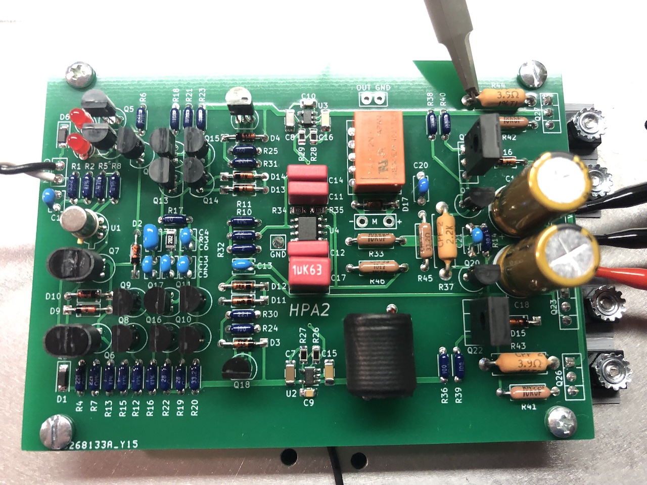

I got the prototype of HPA2 up and running today. It's only one board, and I haven't tried listening to it, so these are just preliminary results.
Performance is really quite exemplary. Bandwidth driven from a 50 Ohm source is 650kHz, limited by the input filter network. Clipping is clean and symmetrical with no rail sticking. Square wave response is picture-perfect. I observed no instability whatsoever. I measured slew rate at exactly 50 V/uS on my scope. This is with no load, just the 2K feedback resistor.
I used the KSC2690/KSA1220 outputs I mentioned earlier in this thread in lieu of the D44/45H11s used in HPA1. The output stage bias current went up to 190mA, or about 3.25W per device, which caused me some concern. But things are running cool with the transistors mounted on a large aluminum plate so I'm going to leave it that way for now.
The amp is a power hog. It draws 260mA on each rail.
The downside of this design is complexity: 29 transistors per channel. I'm amazed it works. As I said earlier, I will start a new thread for this circuit once I have a complete prototype up and running.

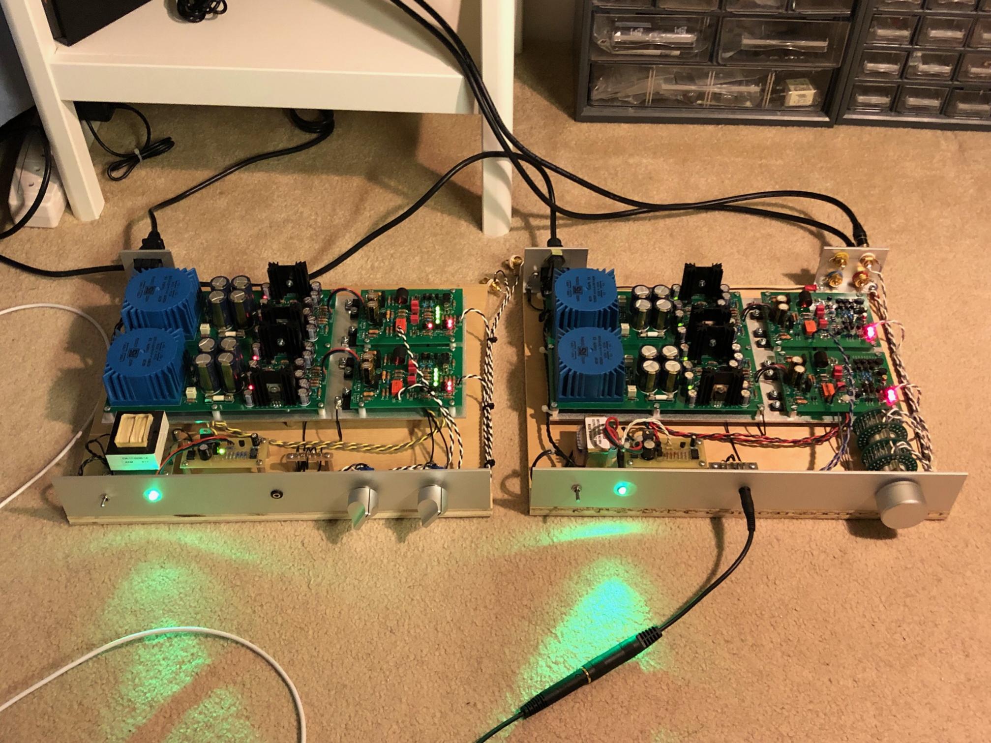

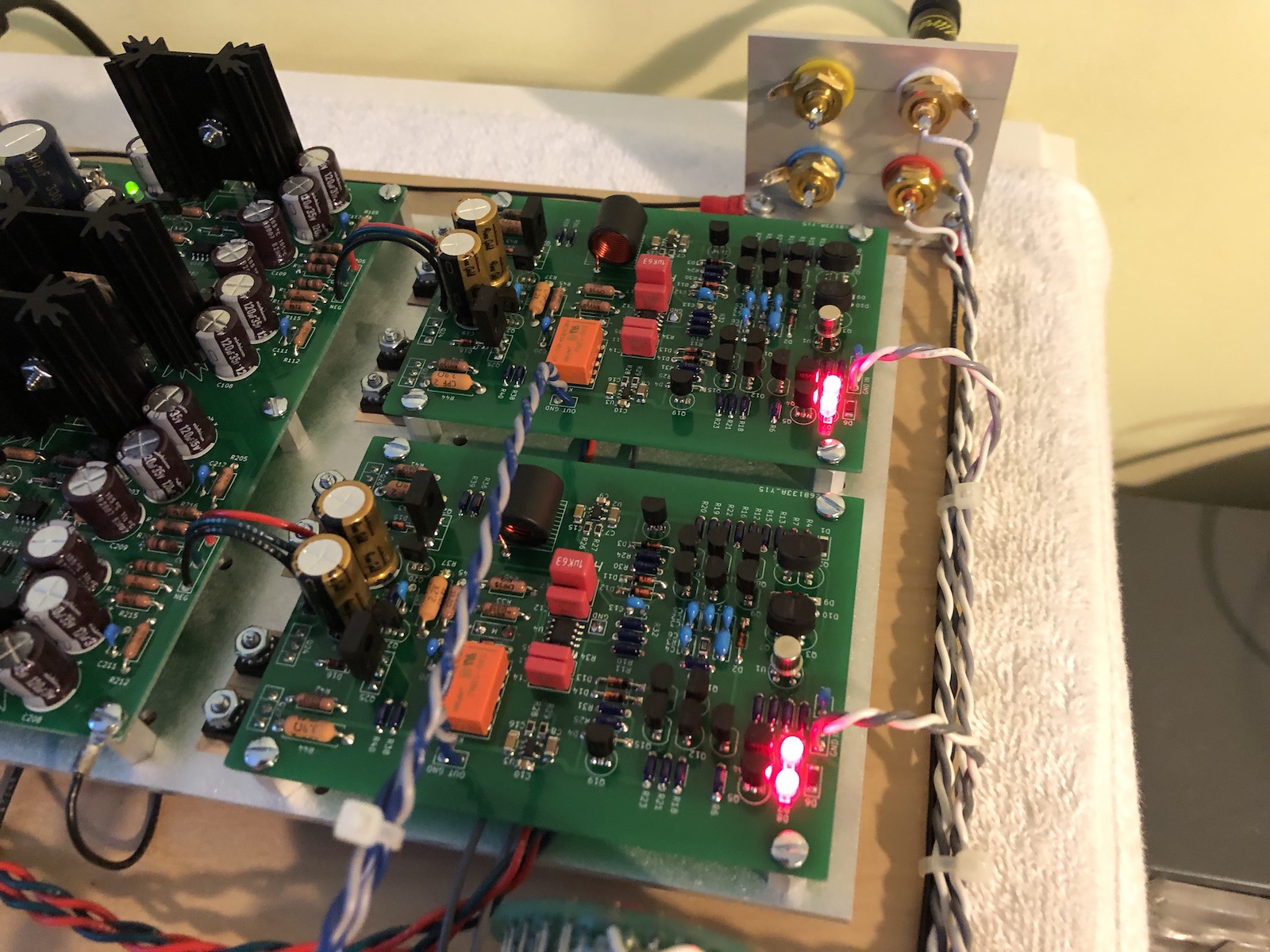

Today, I swapped out the HPA1 boards for the HPA2 boards in my prototype.
I hate to rain on my own party. HPA1 is a very good amplifier, but HPA2 is better. HPA2 retains the virtues of HPA1 -- dead quiet, great detail, strong bass -- and improves on them. Compared to HPA1, HPA2 I think has even better bass. But more importantly, it has a more liquid midrange and is better at "ambience retrieval." It is clean and clear, but relaxed and suave. Soundstage is huge and it feels like it has limitless power.
Granted, depending on your audiophile sensibilities, these differences may be night and day, or they may be nothing at all. I make no claims with respect to my hearing ability or subjective taste -- or whether amplifiers sound different at all.

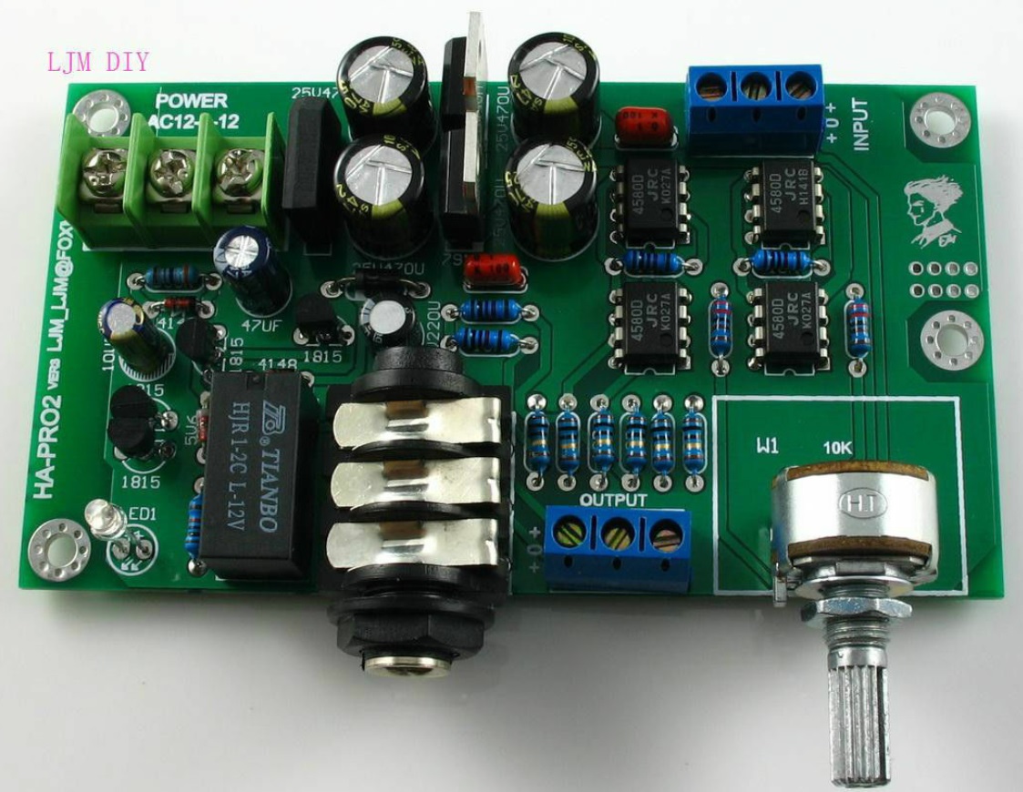

I am trying to decide which direction to go on my headphone amplifier projects. Some of my old HPA projects are class A discrete designs going all the way to op-amp plus discrete output stage and even a TPA6120A2.
So I hope you don't mind me asking but what is better (and why) with the complex discrete designs? For example, what if the OPA1656 is put into the attached schematic versus the very nice looking HPA shown in the first post of the thread? I ask since my integrated HPA (such as TPA6120A2 or the parallel op-amp Dougles Self type amplifier) can have great specifications on paper. But I don't necessarily prefer listening to those HPA over extended periods of time.
Any suggestions on reasons why this might be the case?
I am probably going to go ahead and build more discrete designs but I probably will order a few OPA1656 and see what that sounds like in the attached HPA also.
Thanks for the question.
As far as I know, there's no good reason to build discrete op amps at all. I'm sure a well-designed HPA with a chip op-amp front end mated to a discrete Class A output stage should work just as well as the circuits I've posted here. I should build one to see for myself.
The only real disadvantage of using chips (or just buying something pre-made from China for a quarter the cost of doing it yourself) is that you don't get that gee-whiz feeling when the project you spent weeks designing and building, with a hundred sixteen parts on each board, blows your mind with how good it sounds.
Edit: WRT your other question, I have no idea why one design sounds better than another. That's not true. I mean, I have some ideas, but I have no way to investigate them. All I know is I have three headphone amplifiers: DCG3, HPA1, and HPA2. When I built DCG3, I thought it was phenomenal, as good as it gets. Then I built HPA1 and I couldn't listen to DCG3 anymore. Now I have HPA2 and it's even better. How good can it possibly get? No clue. I had given up on being an audiophile because I thought it all sounded the same. Now, I'm like "Whoa! WTF?" It's a nuisance, really, but I guess part of the fun.
Do you plan to release gerber files?
Can bc550/560 be replaced with BC 850/860?
Bc850/860 are still in the market.
I don't see any reason this circuit wouldn't work well with the SMD equivalents of the through-hole parts. Eventually, all THT transistors are likely to disappear but for the time being everything can be found either at the major suppliers or on eBay. The problem is compounded by the global semiconductor shortage. Other general-purpose transistor types will likely work as well.
Ideally, you would buy enough parts to find matched pairs where appropriate. I used a Peak Atlas DCA75 tester to match transistors.
BC550/560 may be replaced with lower-voltage BC549/559, which might be easier to source.
I used KSA992/KSC1845 because I thought higher voltage parts might be more linear in the VAS output, but that may not be true.
The KSA1220/KSC2690 outputs are out of production and vanishing. D44/45H11 are available and should work as a substitute, maybe with minor compensation tweaks. TTA004B/C are still in production.
LT1761ES5-BYP regulators are listed as active but unavailable until next year, though you can get them on eBay.
The 2N5564 input pair is non-existent. Linear Systems makes a substitute, or you could use LSK389s.
Likewise, the LM329 voltage reference in the Super Regulator is very hard to find right now, though still active.
I sent my HPA1 Kicad design files to a couple of people who asked. I put an archive on Dropbox and can send the link on request. I can do the same for HPA2. Drop me a PM if you are interested.

C4 in the compensation network is currently shown as 150nF. I laid out the board for 2.5mm lead spacing on that part. It turns out that the largest I could find that would fit is 100nF, which is what I used. It only makes a small difference in the open-loop response, so no apparent harm done.
A completely new PC board would be needed for SMD parts, or you could maybe build little THT adapter boards for the transistors (though that's a hack, IMHO). Anything is possible, but it takes me many, many hours to lay out a PC board. I've been doing a lot of Kicad work lately and am sick of it. I need to recharge before I start a new project.

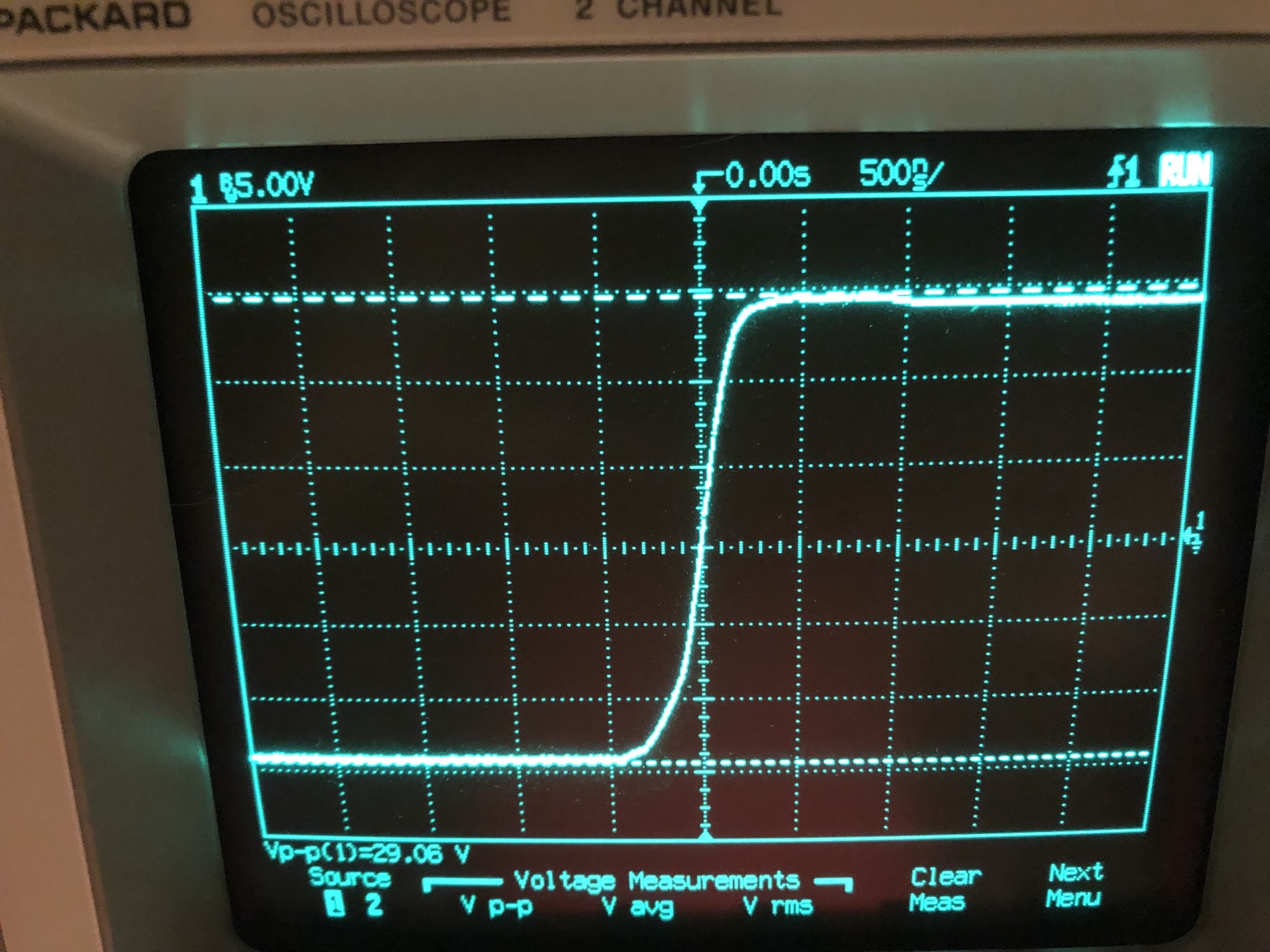

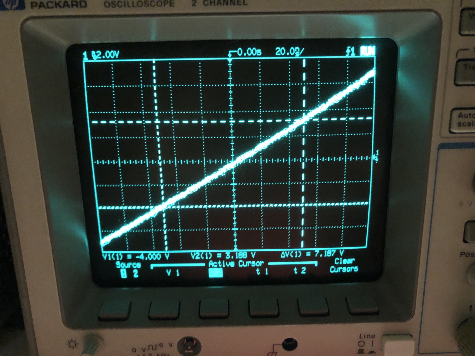

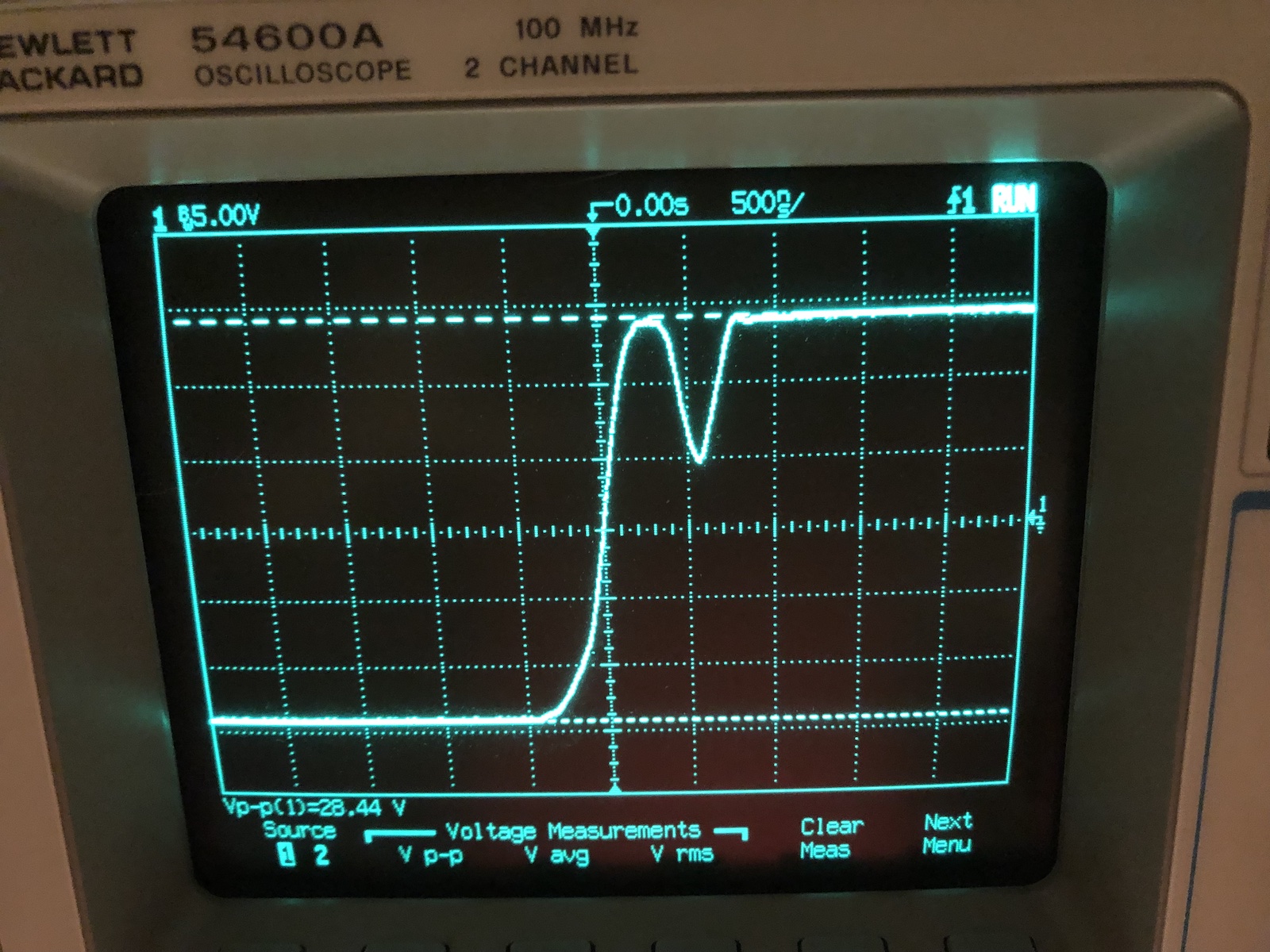

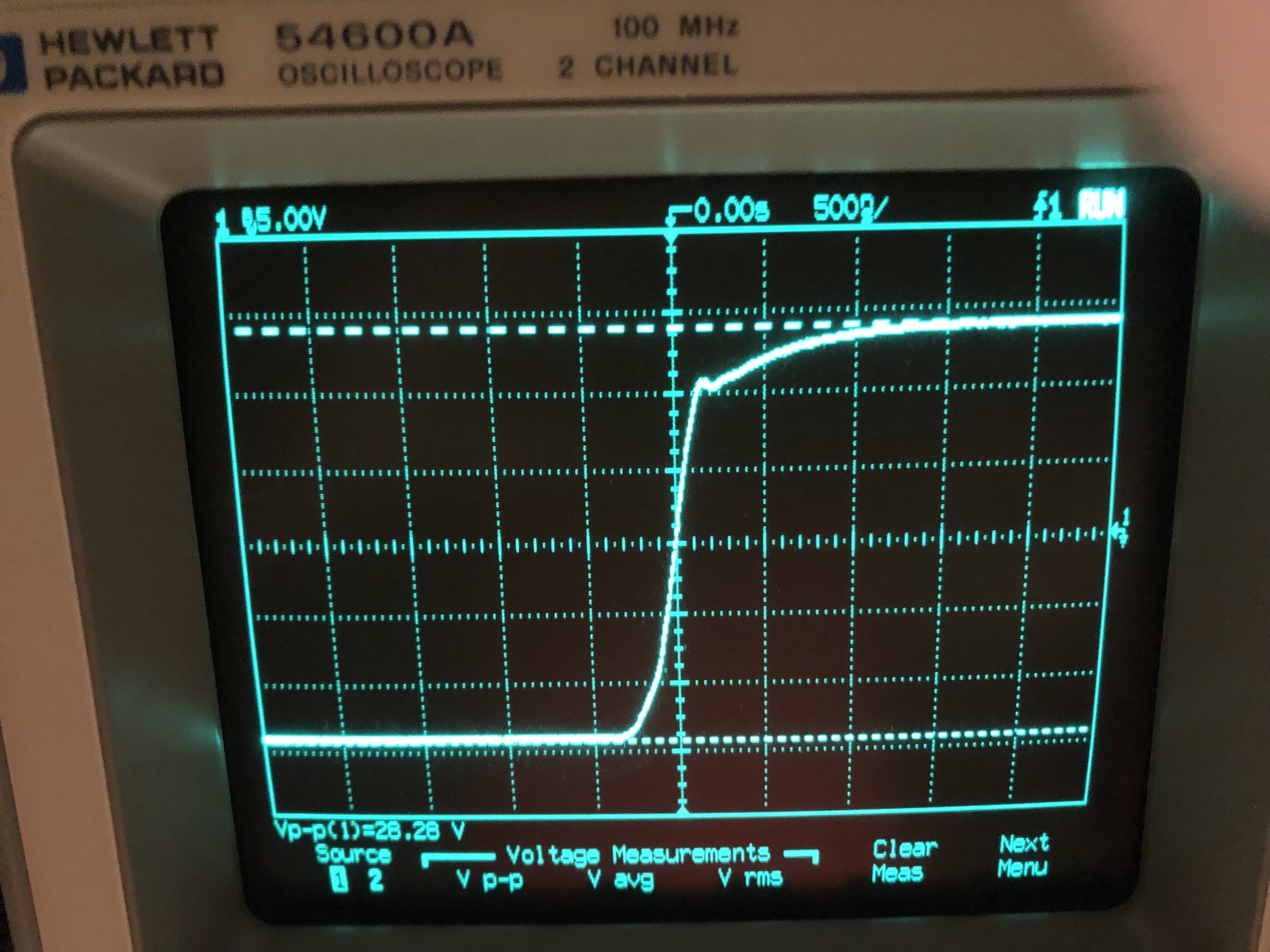

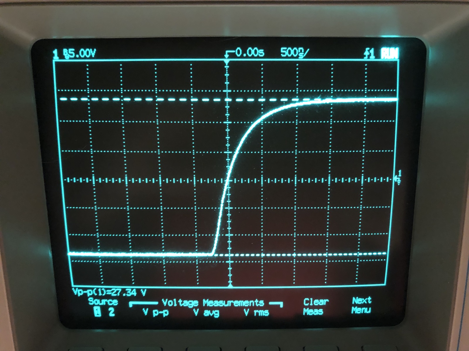

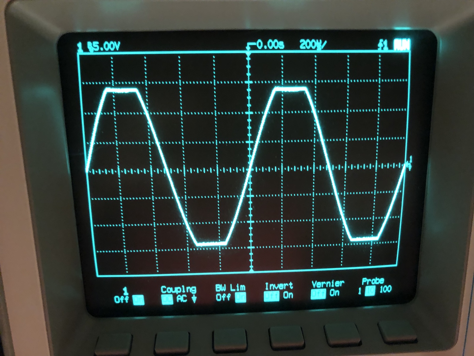

Tonight I changed the input capacitors in HPA1 from 56pF to 120pF to address the overload instability I posted about earlier, and repeated my square wave torture test.
The first photo is sine wave clipping at about 28V pk-pk. As before, it's clean and almost symmetrical.
The second photo is a square wave at 27V pk-pk. You can see the waveform is well-behaved with no overshoot.
In the next two photos, an odd behavior emerges with increasing drive level.
Finally, with hard clipping, it settles down, with just a trace of overshoot. Falling edges look basically the same.
In the last photo, I measured the slew rate at about 145 V/uS. This is driven from a 50 Ohm generator output directly into the amplifier input. It suggests the amplifier is now protected from instability under any input overload conditions.
I measured the small-signal bandwidth at 500 kHz.
I don't know what to make of the intermediate-level blip except to say that as different parts of the amplifier overload, the feedback loop takes about 500nS to figure out what's going on. There was no tendency to burst into outright oscillation, though, as it did before. As I have no plans for listening to full-power square waves, I'm reasonably satisfied with this result.

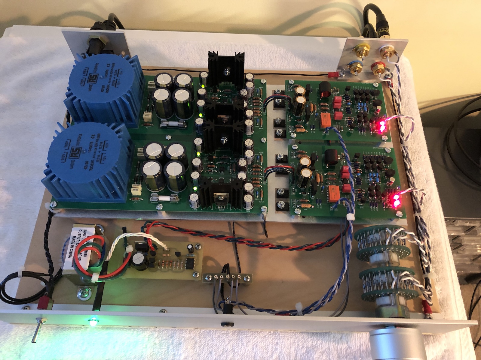

After much more work than I expected, I got the HPA1 rebuild working tonight. I still need to finish a few details, but I'm listening to it right now. I wasn't planning on doing this, but I took the DCG3 apart and liberated its power supply for the new build.
My first thought when I started listening to the HPA1 was, "This sounds exactly the same; I'm fooling myself." It's a nice sounding amplifier.
Then I switched back to the HPA2 and had the same impression as my first audition. The HPA2 seems to have a softer overall tonality, with more body in the midrange and more ambience. The HPA2 may have more bass, or it may be that the amount of bass is the same, but the difference in tonal balance makes it seem that way. I hate the word "seems" in audio reviews because it implies uncertainty, but it can also mean, "giving the impression or sensation."
I find this all very interesting. I keep saying I don't have golden ears, and I don't. But it's easy to start thinking like an audiophile, even if you don't want to, as soon as you start listening for differences between equipment. Again, these differences may be very subtle, or illusory. Or, a golden ear type might say the difference is night and day.
At the end of the day, what matters is if you enjoy listening. I decommissioned the DCG3 because, after building the HPA1, I didn't want to listen to it anymore. I'm enjoying the HPA1 right now. They're both good amplifiers, with slightly different characters. But I believe I prefer HPA2.
