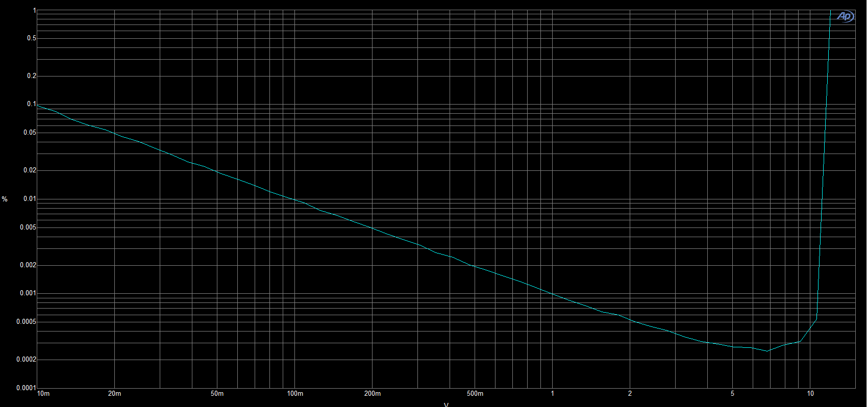

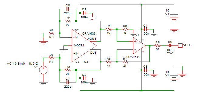

The same circuit was set up and measured. However, my measuring instrument does not support balanced, so it is a single-ended input. Because of the 100x gain, the in-phase component is negligible and should have almost no effect.
The balanced to unbalanced conversion circuit has a gain of 0.5x. This is because single-ended outputs above 10Vrms are clipped. Because of the high gain of the preceding stage, distortion and noise in this circuit are negligible.
10Vrms is measured on the differential output of the OPA1633. In practice, the 5Vrms output of the OPA1611 is measured.

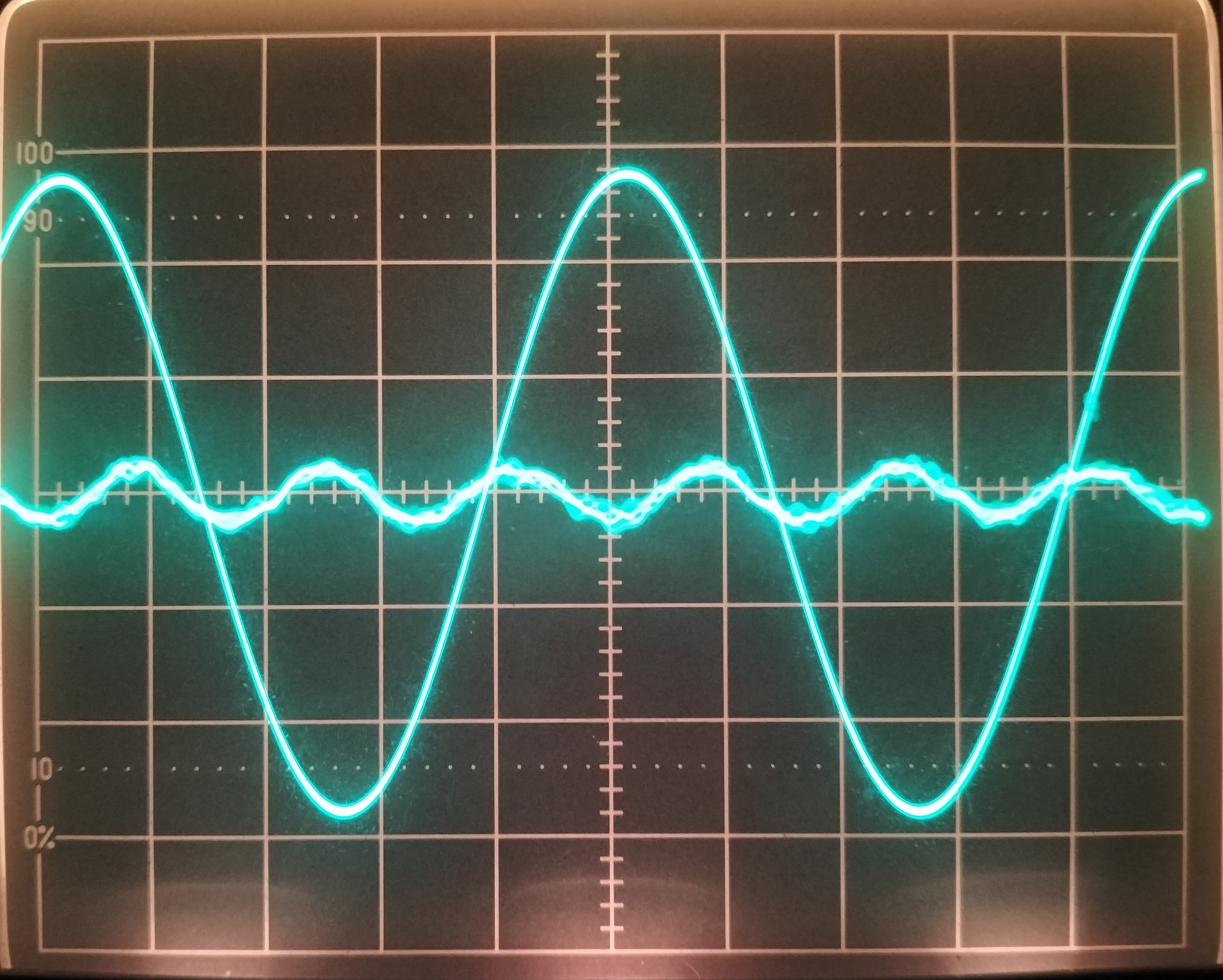

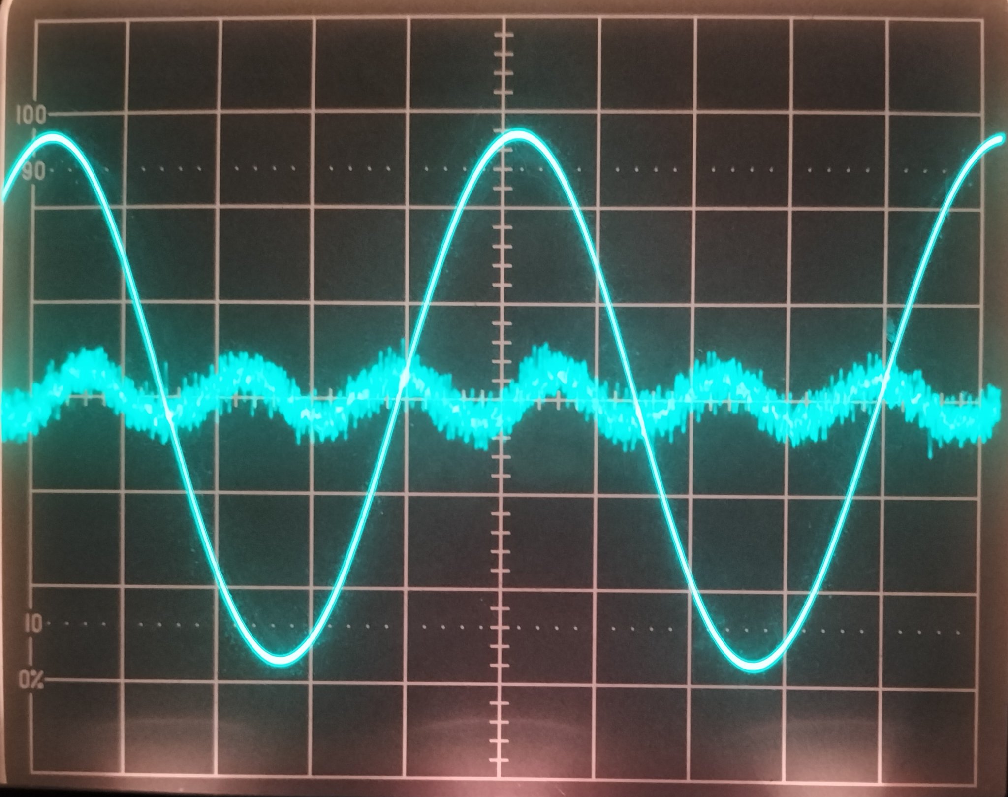

At 1kHz output 10Vrms, THD+N = 0.00089% (BW = 100kHz), almost only 3rdHD.
Through a 20 kHz LPF, the noise was reduced to THD+N = 0.000773%.
The noise is calculated to be 138nV/√Hz, from the data sheet 1.1nV/√Hz @10kHz and thermal noise in 40Ω, a noise gain of 101x (signal gain is 100x but noise gain is 101x). At least at 10 kHz, this would be around 150 nV/√Hz.

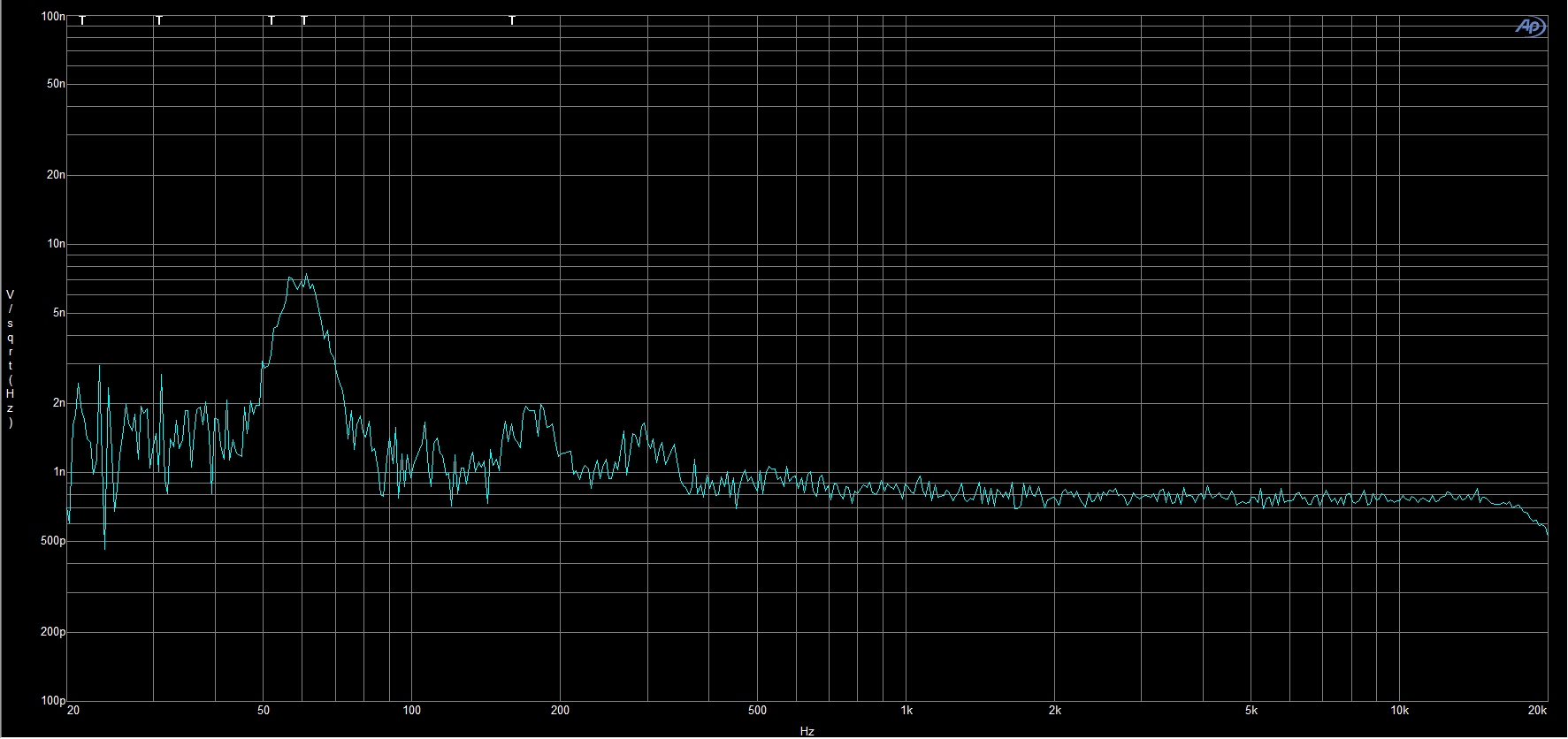

Forgotten to include the noise plot of the AD797. Please ignore the 60Hz pick up I cannot get fully rid of in this setting.
Rf = 2Kohm, Rs = 40ohm (thermal noise 0.8nV/sqrtHz)-> X41 gain.
AD797 0.9nV/sqrtHz
In order to get better resolution at low frequency, I will need to implement or buy a low noise preamp such as groaning, but this is it for now until I get the new prototypes with the OPA1633.
