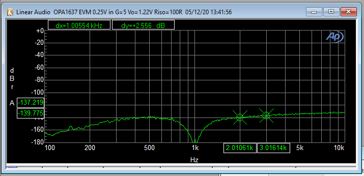

I always was under the impression that those fully integrated FDAs are intended for rather low noise gains (like well below 20dB) as seen in DAC I/Vs, ADC drivers, active filters and format converters.Below some measurements on OPA1633. Output distortion (quite high), 40dB gain (diff input diff output) Rs=40ohm Rf=2K. CF=220pF.
The same circuit was set up and measured. However, my measuring instrument does not support balanced, so it is a single-ended input. Because of the 100x gain, the in-phase component is negligible and should have almost no effect.
The balanced to unbalanced conversion circuit has a gain of 0.5x. This is because single-ended outputs above 10Vrms are clipped. Because of the high gain of the preceding stage, distortion and noise in this circuit are negligible.
10Vrms is measured on the differential output of the OPA1633. In practice, the 5Vrms output of the OPA1611 is measured.
At 1kHz output 10Vrms, THD+N = 0.00089% (BW = 100kHz), almost only 3rdHD.
Through a 20 kHz LPF, the noise was reduced to THD+N = 0.000773%.
The noise is calculated to be 138nV/√Hz, from the data sheet 1.1nV/√Hz @10kHz and thermal noise in 40Ω, a noise gain of 101x (signal gain is 100x but noise gain is 101x). At least at 10 kHz, this would be around 150 nV/√Hz.
Your noise data is a bit questionable, but I was a bit concerned when I looked at the datasheet, but again the 1/f knee is high and there seems to be a lot of low-frequency noise, and given that the RIAA raises the low frequencies, it may not be suitable for MC phono frontend.
Thank you I was studying the datasheet for OPA1633 and it lists 10V/1KHz about -132dB (0.0000251%) TDH+N for a G=1, this should imply for a gain of x100, there should be 20dB increase in the distortion product thus indicating a distortion of 0.0002512% adding the residual distortion of your generator, your measurement is extremely accurate.
This means, accordingly to the datasheet, that in proper condition I should see no more than -63dB i.e. 0.0707946% at 1KHz @10mV. My measurements are way off I suspect something is definitely wrong with my breadboard. I am going to spin a board today I finished the design.
I took a look at the LME49990 it seems a fantastic opamp. Isn't it almost identical to the AD797? I compared noise and distortion they are basically very, very similar. I can still find some LME49990 it makes me so curious to try. However, in the end I don't know how any of these opamps sounds.

Below distortion AD797 SE Rf= 2K, Rs = 45R, Vcc +/-17V (BW 100-22KHz) to match abt 20dB in differential mode. I have observed that when driving a low impedance input, the distortion is highly masked by the distortion of the gen driving the short.
I have arranged the Rs to ground to set the proper gain and I inject with 1.8K ohm to the (-) input to the output of the unbalanced gen thus simulating a 40ohm cartridge connected to the input.
I believe this setup to produces in fact more realistic figures.
Question is how will the cartridge be able to drive the low "current stage" input impedance and produce low distortion? I think I will setup one of the test records I have and attempt to measure distortion. Unfortunately, it's hard to tell what the distortion level of the reference signal on the groove itself, so even doing this, the results could be unreliable.
In a few days I will receive the prototypes for the OPA1633 and the differential config using 2 AD797, using the same injection method I will post measurements.

Forgotten to include the noise plot of the AD797. Please ignore the 60Hz pick up I cannot get fully rid of in this setting.
Rf = 2Kohm, Rs = 40ohm (thermal noise 0.8nV/sqrtHz)-> X41 gain.
AD797 0.9nV/sqrtHz
In order to get better resolution at low frequency, I will need to implement or buy a low noise preamp such as groaning, but this is it for now until I get the new prototypes with the OPA1633.
